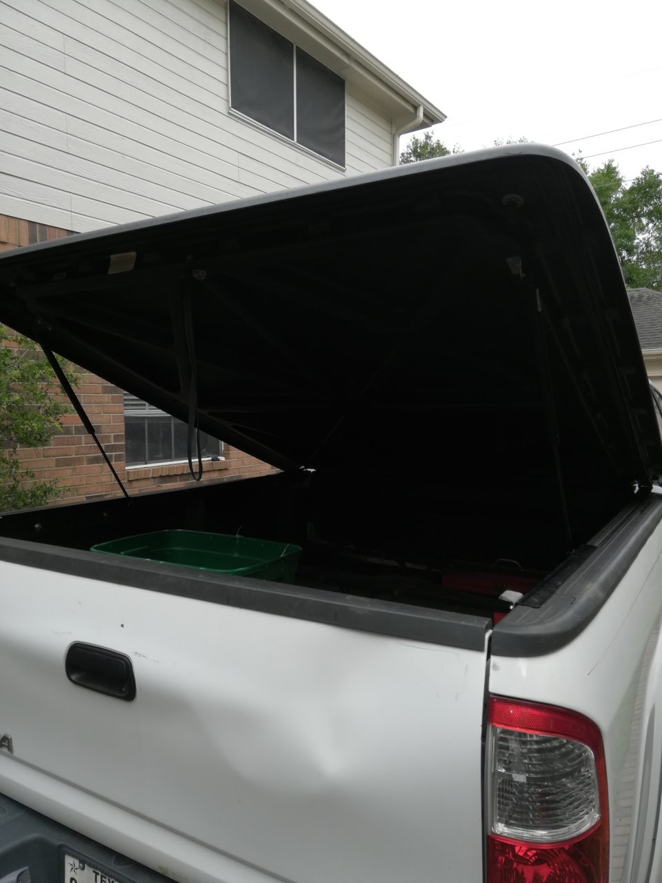

    Need more information for the same straight up Undercover tonneau build.
    Where to buy the front cross bar extender and the puematic structs ?
  10. Jun 22, 2020 at 5:37 PM
    #50
    tino
    tino New Member
    Apr 26, 2016
    #185321
    3
    2006 toyota tundra with Undercover hard top tonneau
    I have the same question.
    Where did you get the ratcheting linear lifts for the front?
    I have the Undercover hardtop tonneau. See picture.
    I need to raise the tonneau front like this here.
    Thanks for the help.

    Hey everyone. Been MIA for a while, that was 3 trucks ago. Just getting back into the Tacoma world. The ratcheting mechanisms at the front were heavy duty ratcheting load bars.
