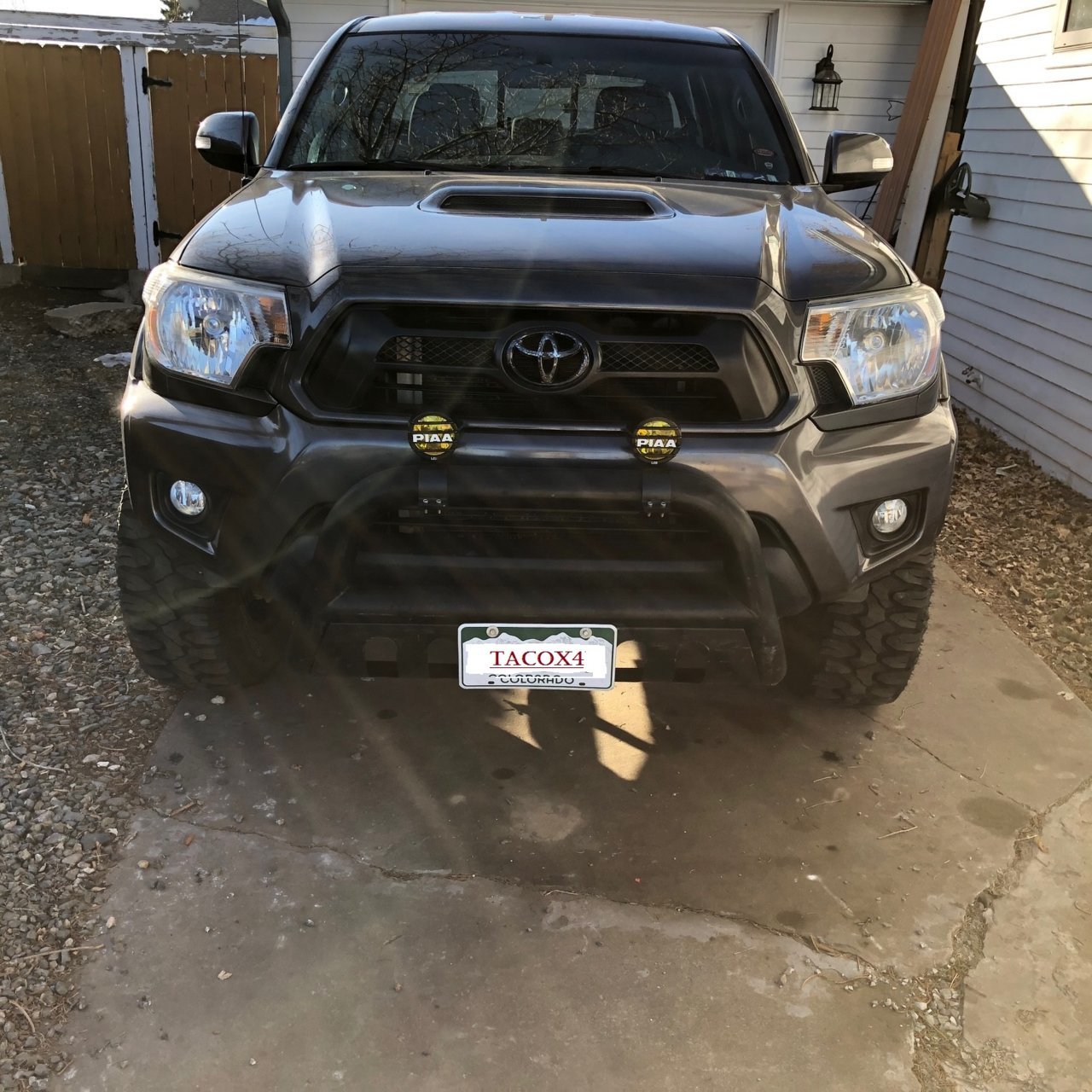

    I like the bull bar but not too keen on the light mounted on the sides. Here is mine, now I need to figure out how to mount a winch.front view.jpg

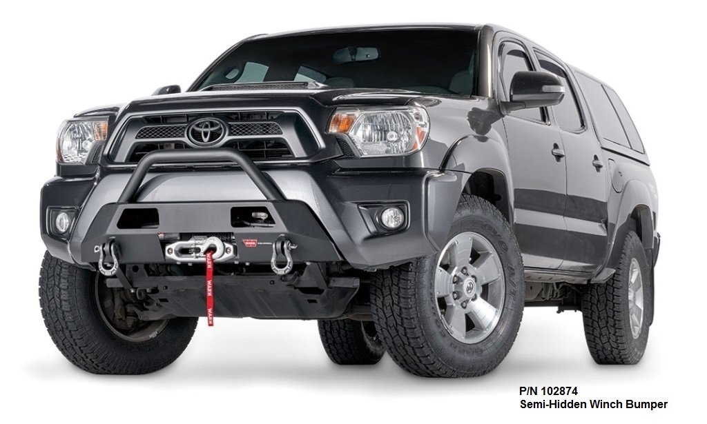

    Check out the Warn #102874 mount - it has the radiator guard pipe welded to the "hidden" winch base. You could do that too if you are willing to refinish the mount.

    What do you mean by refinish the mount? Would I need to get a new bull bar to mount the winch?

    750
    Steve
    Casper / Tucson
    014 Taco 4Dr 4wd
