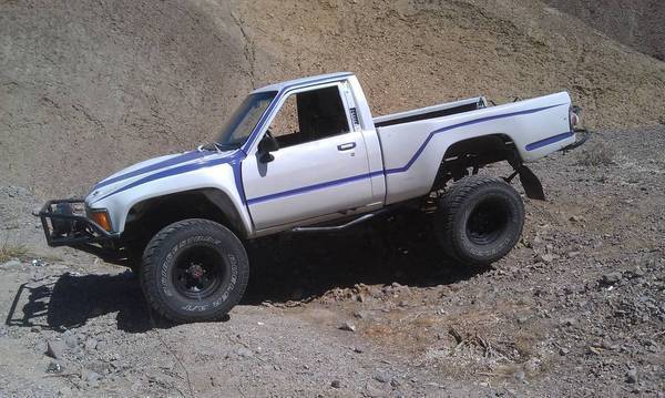

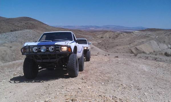

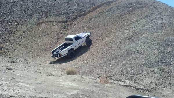

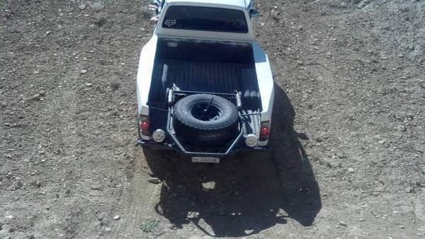

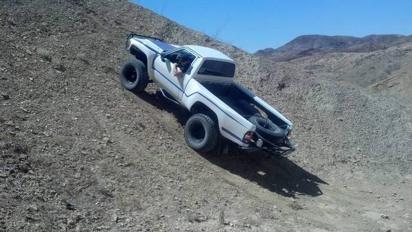

    Took this old bastard out to stretch it's legs yesterday. Pacman4runner tagged along and we decided to head out to Calico to get a better feel for the area. My main goals for that day were to climb up something stupid steep, 3 wheel, and flex some nuts. Here's what we got.
    Three wheel'n attempt.
    Something stupid steep.

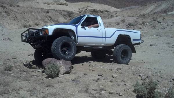

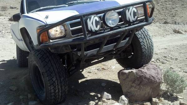

    Flex'n nuts. I kept attempting big ass boulders and realized that my tires are garbage and I'm still IFS. So I had to find the rock you see pictured below.

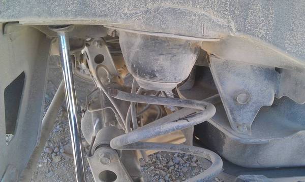

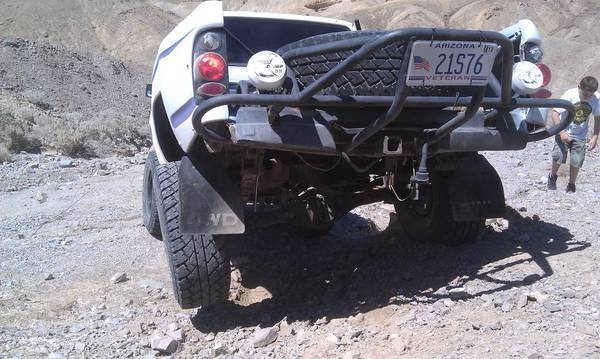

    This was the highlight of the day. While Pacman4runner was getting poised for a 3 wheel'n shot I had noticed that his spring had come off it's perch. It wound up completely falling out and getting wedged between the wheel and the bump stop on top of the axle housing. With a hammer and a "fuck it whatever works" attitude it was fixed.
    All in all a good day. The 88 did outstanding given a shot out steering system, two demolished CV axles, bent shackles, one bent shock, and street tires. Everything that was thrown at it was handled with the same amount of experience that is holding it together. Pure Toyota ruggedness. Thanks for watching :wave:
