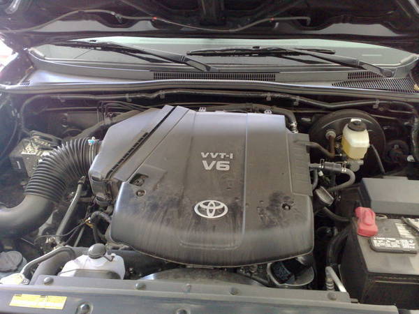

    I just popped up my hood and discovered that there is a lot of dust building on the motor and stuff, i currently don't have any products fr detailing the hood i just wanted to know if i can just pour some water on it with my garden hose, or what can i do???
    Here's a picture of it.... I want to wash my Tacoma today as I'm traveling next Monday and i like my truck to look clean and neat on the Hwy :D:D any suggestions welcomed!

    i just take mine to the carwash and use the HIGH-PRESSURE water...:D

    so no risk of getting harnesses disconnected or damaging anything with high pressure water??

    i leave the truck running......Dont just BLAST it everywhere....
    U will know where to be careful...
    THEN WIPE ALL CLEAN:cool:

    I just did under my hood this afternoon with a normal hose. It's not completely dry yet but it looks like it took 90% of the grime out. Since I'm the only person that sees under there that's good enough for me :D

    you are right man, i just did that, get everything wet then i dried with a towel, looks good to me :D

    DO NOT USE HIGH PRESSURE to clean your engine! This is bad, as it WILL force water into places that it shouldnt be. IF you use high pressure, or water sprayed from the hose:
    keep the motor running
    Stay away from the alternator
    Stay away from fuse area
    Keep nozel about 2 feet away
    Trust me, I have ruined many alternators, and electrical components trying to clean an engine. :)

    Thanks chris good to know, i did hosed it but it was very superficial just to take of the dust, all the hard work was with the towel!

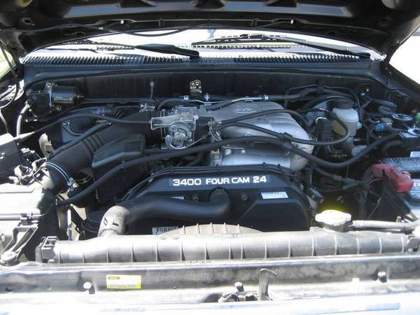

    Hey-next to smelling clean and having well-trimmed nails, having a clean engine bay can be downright SEXY to da laydeez man:D[​IMG]
