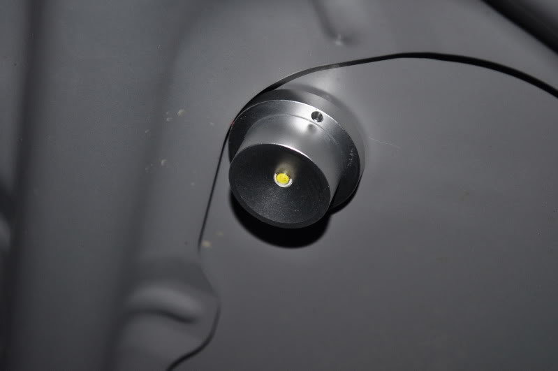

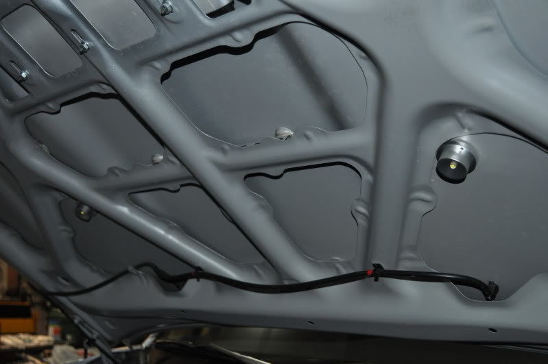

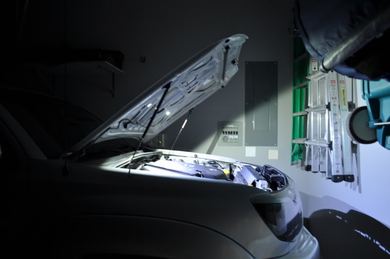

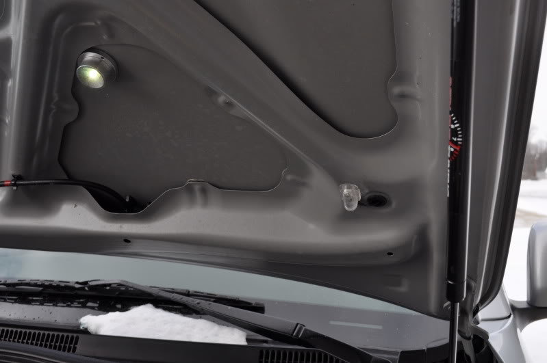

    I used some Oznium LED Floods to make it happen. I'm extremely happy with the amount of light and the floods disperse very nicely. For now, they are not switched (have to pull fuse at aux fuse box to turn off / on) but I will be installing a hood switch soon to have them come on automatically when the hood is opened.

    Thanks guys. It only took about an hour for me to install. I will have to go in later and put in the hood pin switch, but that will only take a few minutes once I figure out where I want to put it.

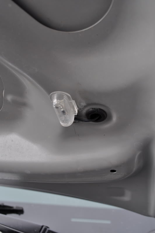

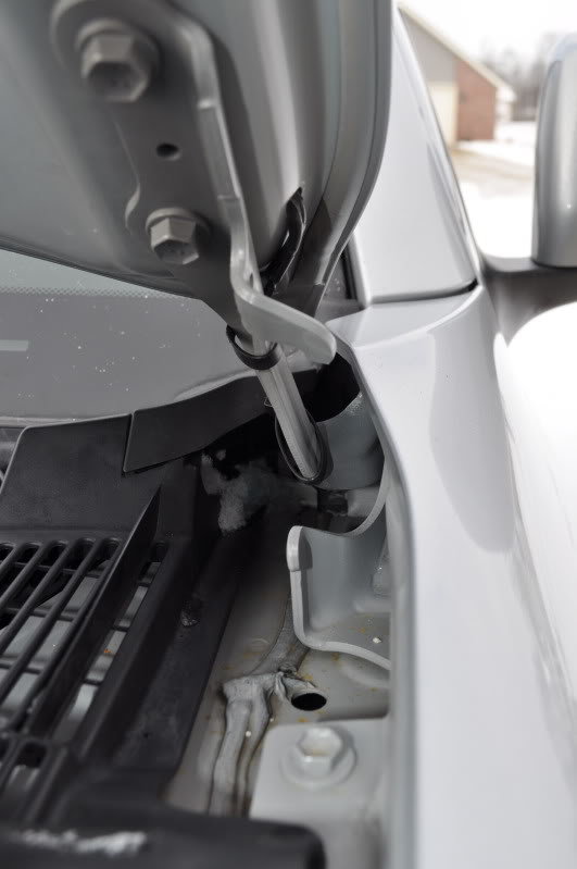

    Added a mercury switch and took a couple more pics of how the wires are routed:

    Will the Merc switch activate the lights when accelerating?

    + 1, this is what I thought as soon as I seen the switch. Why not just install a pin switch?

    ^ good question. And what is the advantage of a mercury over a push pin? I guess it's easier to install.
