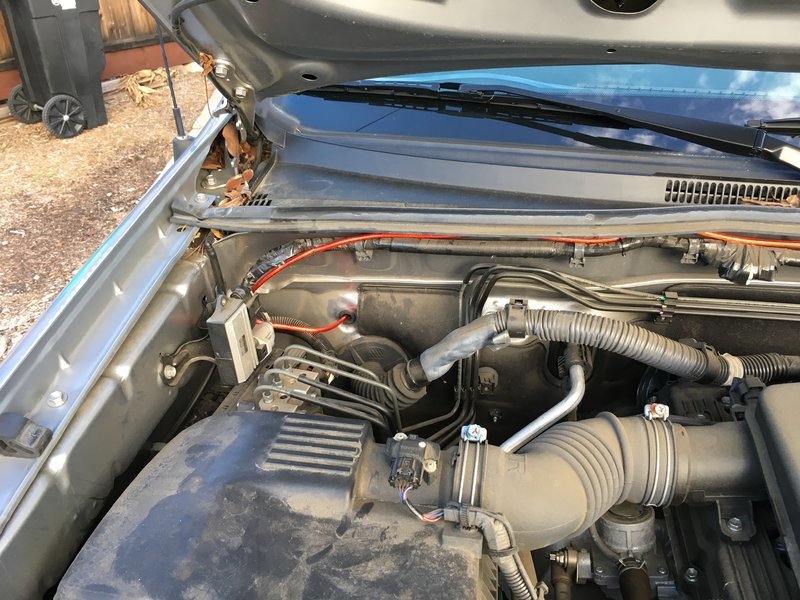

    On my '14, there was a plugged hole on the passenger side that was pretty easy to get through. Just pull the rubber seal, cut the nipple-ish thing off to make it into a grommet, then fish through. (Had the glovebox out at the time, and was relatively easy.) Ask, and ye shall get a pic.

    I'd love to see a picture or three when you have the time.

    From the front:

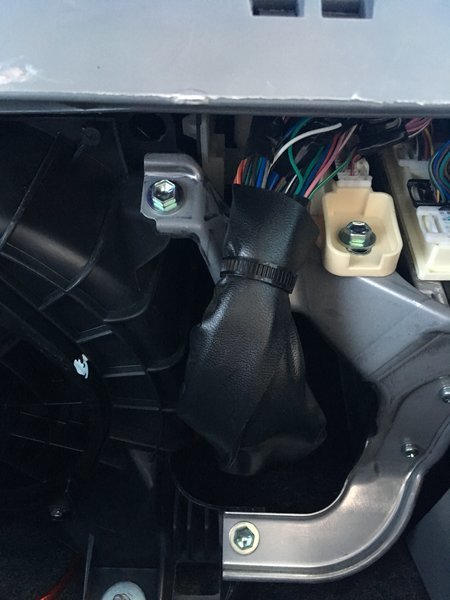

    Taken from the passenger footwell, it comes through about 6" above the shiny bolt at the bottom:
    (it's too far up there to actually get in the picture...)

    Thanks for the pictures. How did you feed it through, coat hanger? Did you have to take anything out besides the glovebox?

    No prob. I pushed from the engine compartment and just grabbed the wire as it came through. (Didn't need fish tape or anything.) Probably the hardest part of grabbing the wire on the inside was figuring out where it was actually coming through, since you're feeling it blindly.
