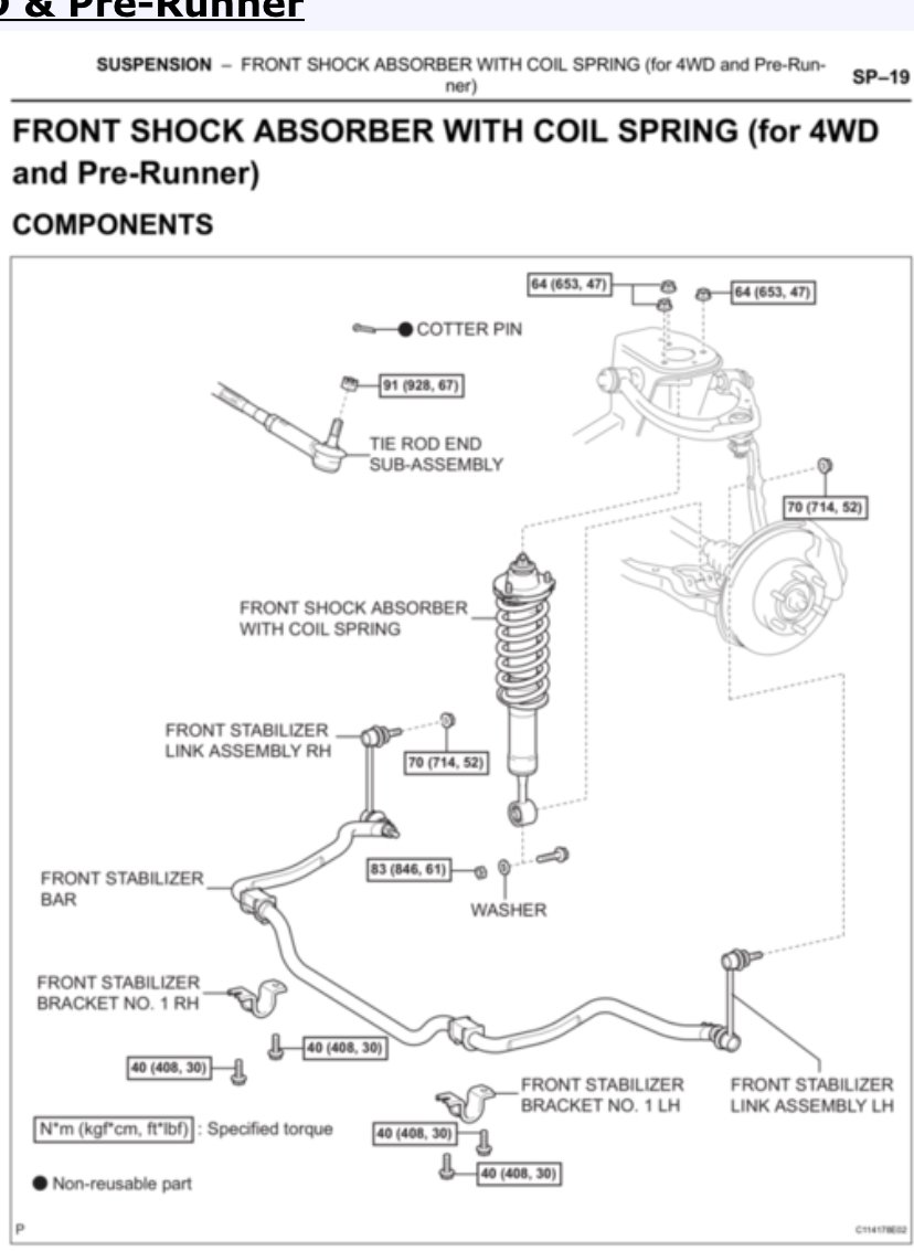

    So just to confirm. Thank you all for the support and help during my DIY installation…
    Second thanks for pointing out the torque spec guide. -on that note. When reading this guide is the first number next to a part the factory torque spec and is it in foot lbs?

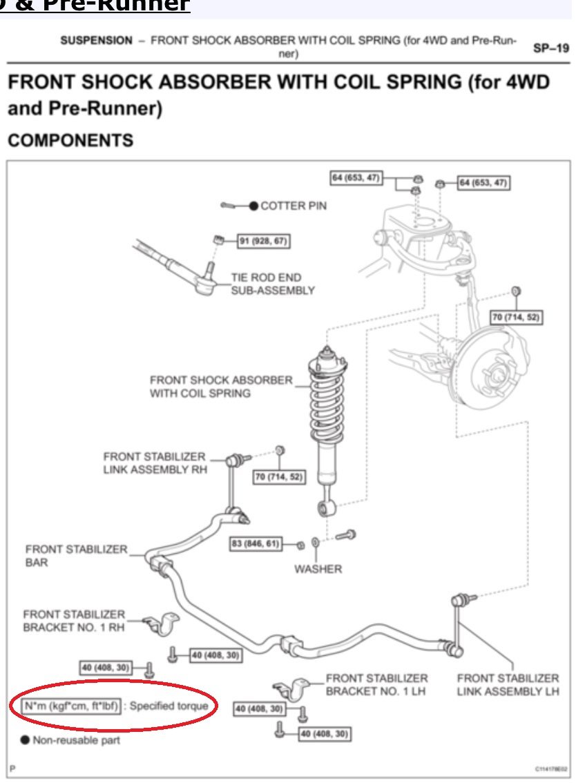

    It's specified at the bottom (circled in red):

    Damn… it was right there and I missed it. Sorry for that… thank you for pointing it out. now I feel like a dumb a##.:thumbsup:
