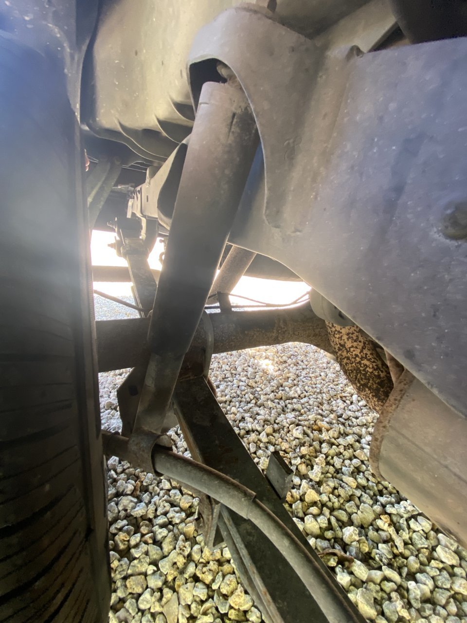

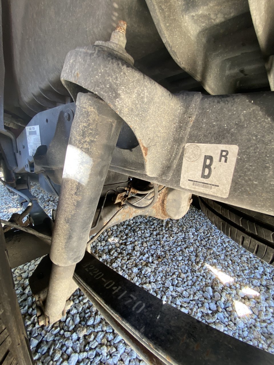

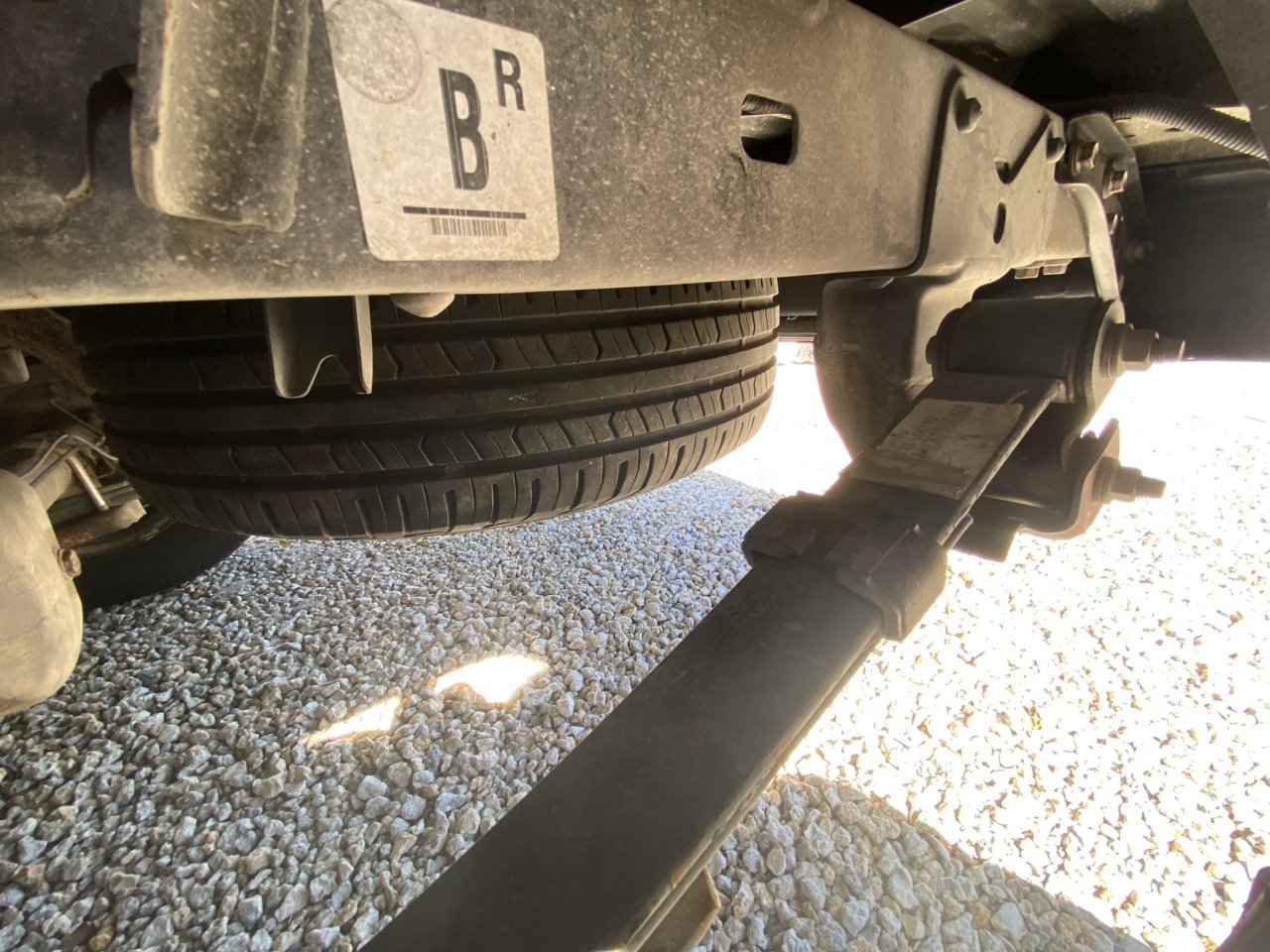

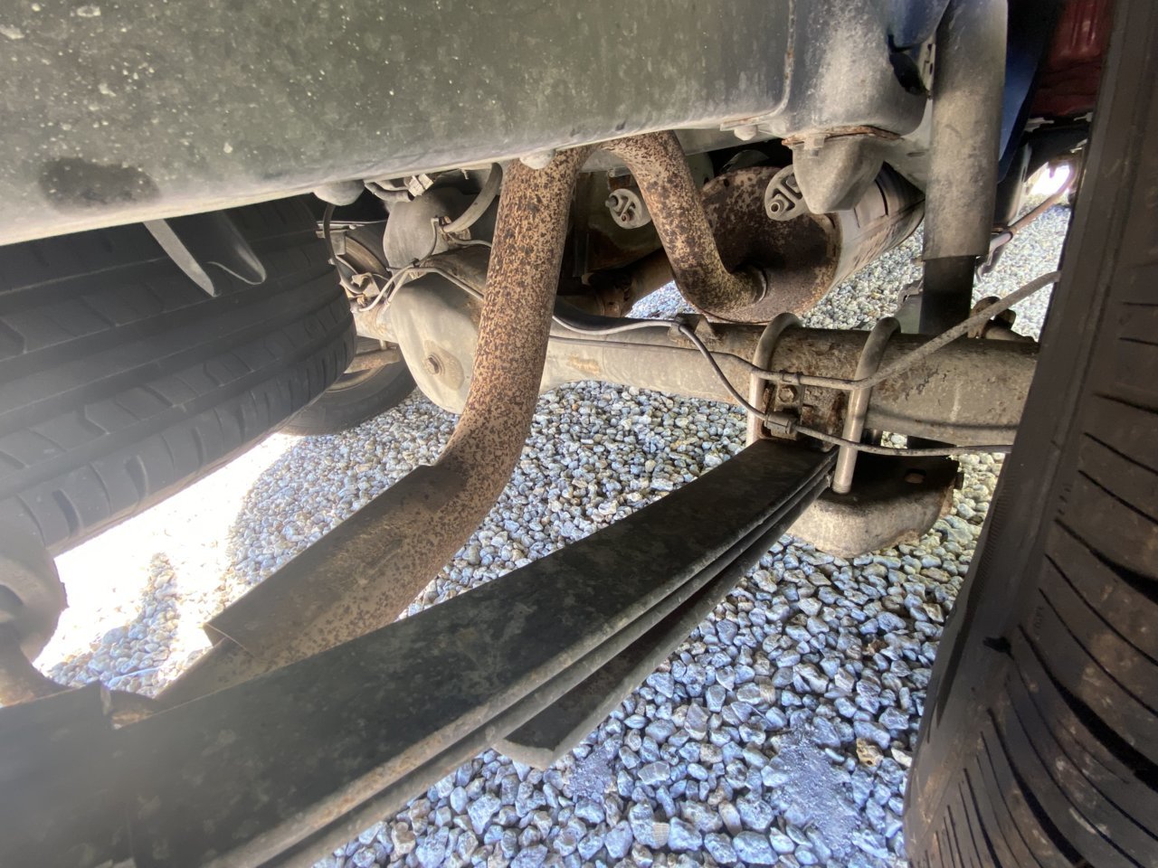

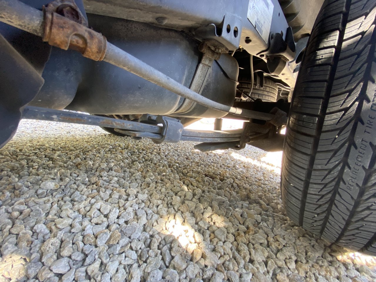

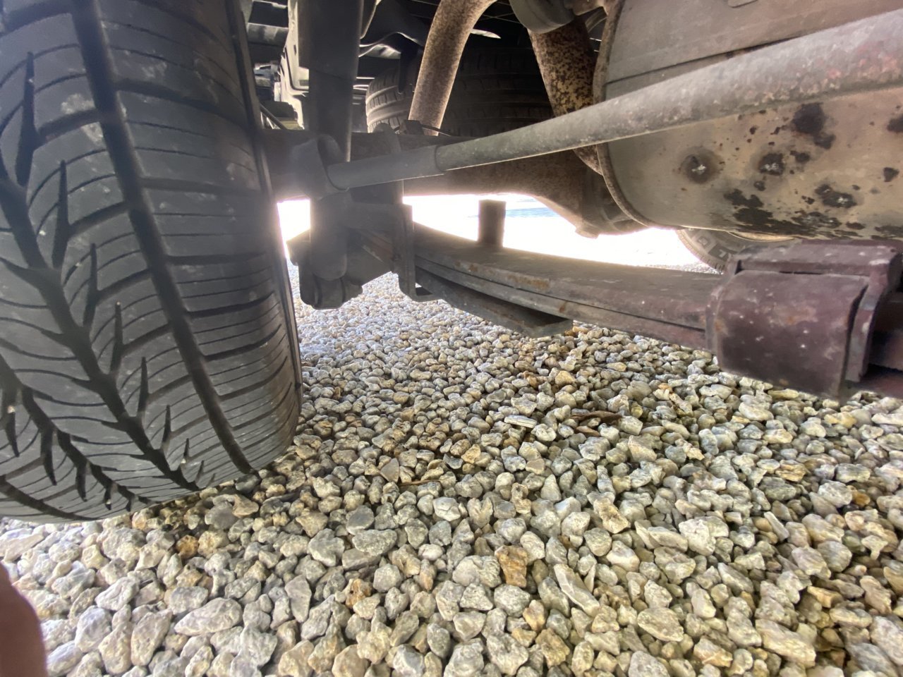

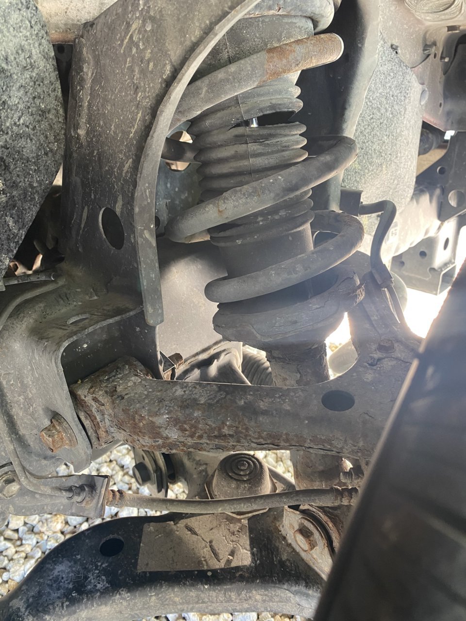

    Update: Checked everything you guys graciously pointed me to yesterday and took pictures. Here they are:
    Front end struts:
    Rear shocks:
    Leaf springs:
    In my opinion, I think the leaves look pretty good for their age, a little surface rust but nothing broken or weak. I checked the axle alignment with a measuring tape, that was good too. The tires have less than a 1000 miles on them so it's hard to check for abnormal wear at this point.
    I know I keep harping on the shocks and struts, but the only thing that seems suspect and out of spec is the suspension. The boot is broken on both sides for the front. I appreciate all of your guys' help, it means a lot. Thank you!!!

    OP, in one of the pictures of the undercarriage, there is one with the right rear tire in it, and on the tread of the tire it is stamped into it "Replacement Tire". I've never seen this, maybe one of the tire experts on here has, but I would start by having a tire shop take a hard look at that tire.

    Hey Michael, thanks for your reply. I thought the same thing but it’s something called tire monitor with the General AT43’s. As the tire wears, different messages like rotate tires and replace will pop up, the whole message says “TIRE REPLACEMENT MONITOR”. These tires have about 500 miles on them and are brand new. Thank you though!!
    Edit: here’s a link showing the tire monitor technology
    https://www.generaltire-tyres.com/car/service/monitor-technology
  20. Jan 22, 2023 at 8:49 AM
    #20
    well1777
    well1777 [OP] Member
    Jan 6, 2023
    #414899
    12
    2008 Base Tacoma 2.7 2wd Access Cab
    Update:
    Replaced both front struts and both rear shocks about a week ago. Everything was completely blown so I had high hopes on the new suspension fixing it. Although it seemed to greatly improve ride quality and fix a lot of the shake, unfortunately it is still there. At this point, I am just going to run the truck and not think about it. One thing I have noticed now though is how much the bed moves independently to the cab when I drive over bumps. Note all the driving I do is highway driving, about 400 miles a week. Thank you all again for your help, I will keep the thread updated if I find anything.
