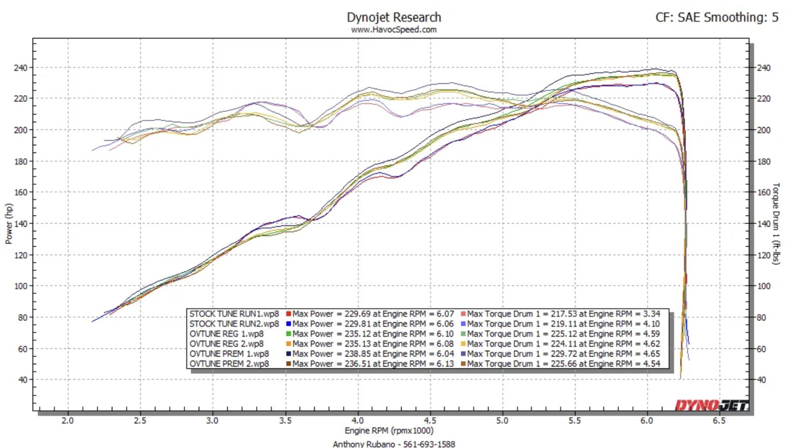

    Ok, this is a really good point. And I'll admit that I haven't really payed too much attention to these power curves to this point. But isn't 'holding a gear' more related to the torque curve? I'm not trying to accelerate on the highway, I'm trying to maintain the same speed. Am I completely misunderstanding that?

    Torque is the amount of force an engine can put out; horsepower is a measure of work the engine can perform. Driving down the highway is work (displacing the vehicle), so horsepower is needed.
    That dyno chart effectively starts at 2300 RPM. What RPM is your truck at in 6th going 70 on the highway? When your truck downshifts to unlocked 5th or 4th gear what RPM is the truck now at?

    Ok, I think I'm getting it. 6th @ 70 mph is about 1700 rpm, so...way less than 80 bhp... That said, I'm not even trying to hold six at this point. I'd say 5th is closer to 2100 at 70 mph, so...still less than 80 bhp... Yeah, I'm starting to get it.
