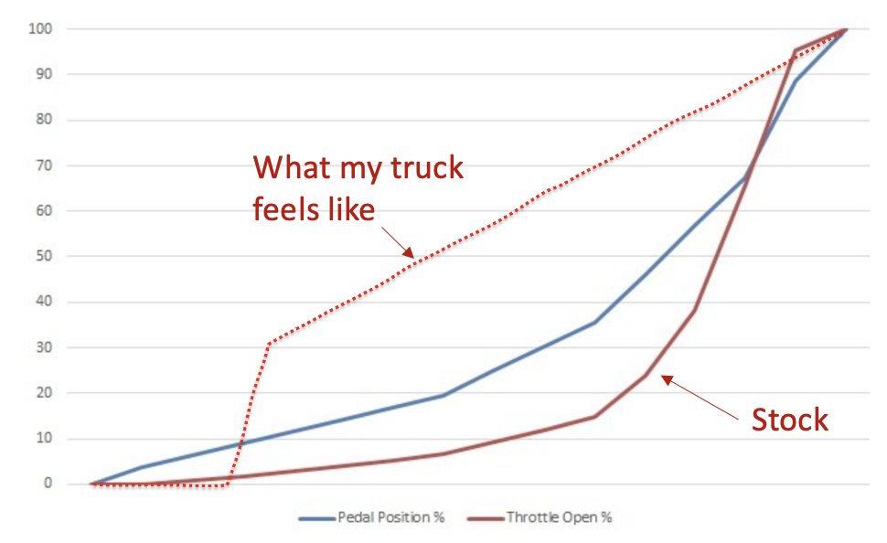

    My original OTT tune (mild/medium) was the same way... nothing for the for the first inch of gas pedal and then it felt like half throttle much like your graph...
    I went back to change it to light mild and the tuner I use said OTT just updated the throttle pedal input for the mild/medium tune to be much less abrupt... I have a steep driveway and with the original tune, you had to be delicate with the pedal to not rocket up my driveway...
    The new tune/pedal parameters are perfect and even does well with 700lbs of stuff in the bed.
