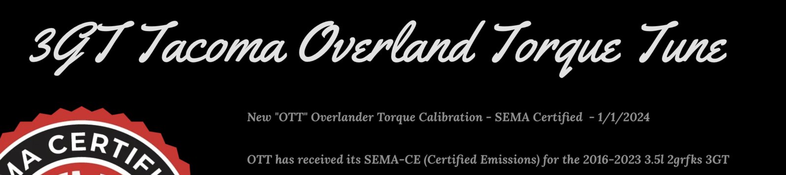

    what is the post SEMA certification version?

    I'm not exactly sure. That's just what my tuner told me when I asked him what version I was running. Looks like there was an update at the beginning of 2024 that got "SEMA Certified", whatever that means.

    They sound like a solid company, trying to push certs through, I’d guess this is no easy or cheap thing to do.
