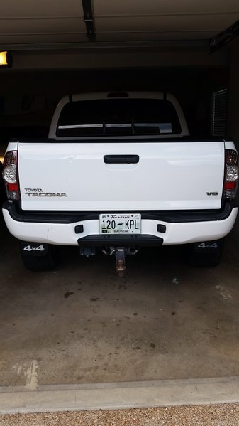

    I have a 2012 trd sport 4x4 and I installed an aal in the rear and every since then the drivers side is higher than the passenger side. Only the rear corner is higher. Any suggestions on what might be the issue.

    Mine stock: Taco lean, nor sure why yours is higher on driver side after AAL, perhaps the leaves had different bow/bends, did you have the leaves custom from a shop or buy them from a 4x4 vendor?

    Do your shackles move freely ?

    I got them from a vendor. The bed was level before I put on the lift.

    Since the suspension work done didn't involve messing with the bed or body itself, we can deduct that whatever was done is causing the drivers side to sit proud of level. The same way the stock suspension, because it is built the same on each side, shows the taco lean due to heavier components being on the drivers side.

    My last truck had a non level box like that. I messed around with it a lot, and to make a long story short I ended up shimming the box to level it.

    A tape measure will help you mucho

    Hub to fender , front and rear, report back

    Top of axle to frame could help as well

    Rear drivers side 25 inches. Front drivers side 23 inches. Rear passenger side 23 inches. Front passenger side 23 inches. These measurements are from center of wheel to fender

    Are you sure the guy put the leaf in on the pass side? JK

    I did the install. Positive it's in there
