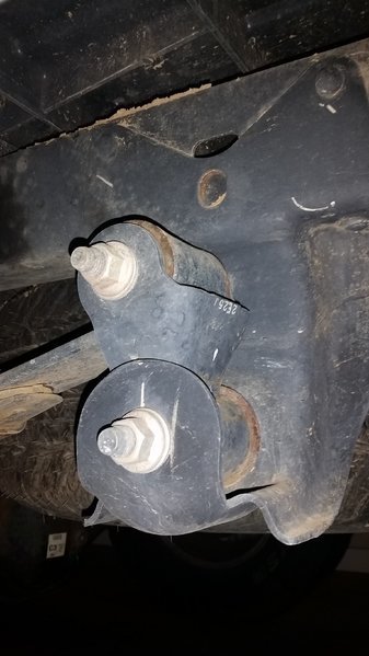

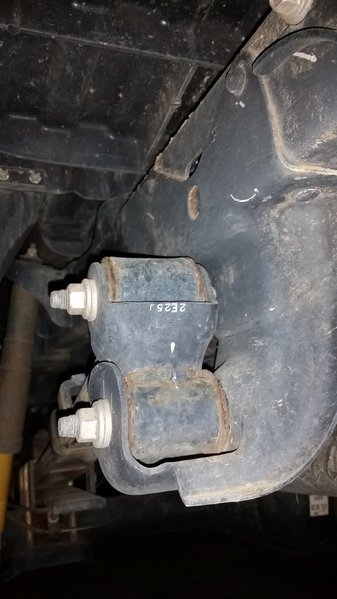

    Do the shackles move freely ?
    Is the centre pin positively seated in the axle ?
    DormaTaco and Anderson like this.

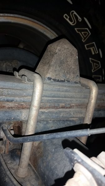

    This is the drivers side shackle

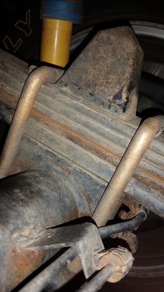

    Maybe some pics of leafpacks at axle pass and drivers side

    Check to see if any gap between leaf and axle.

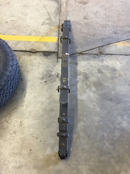

    If your centering pin isn't properly aligned you should definitely notice. Does one wheel seem further forward than the other?

    Passenger side

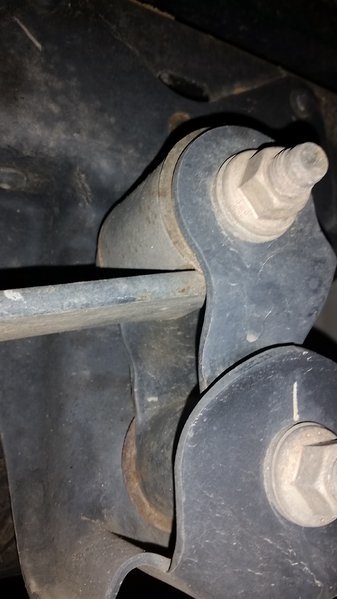

    Drivers side
