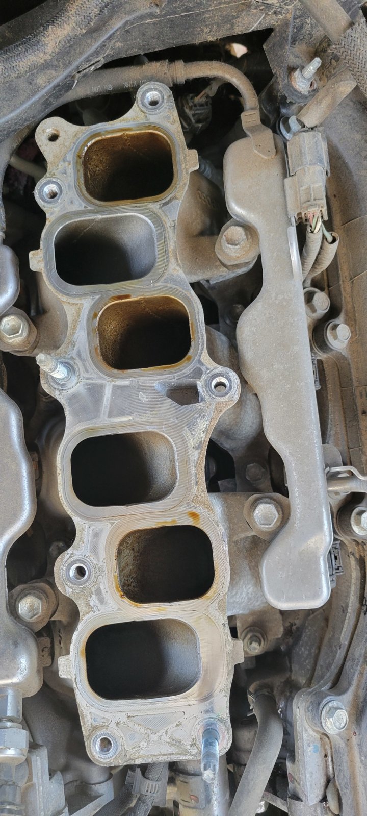

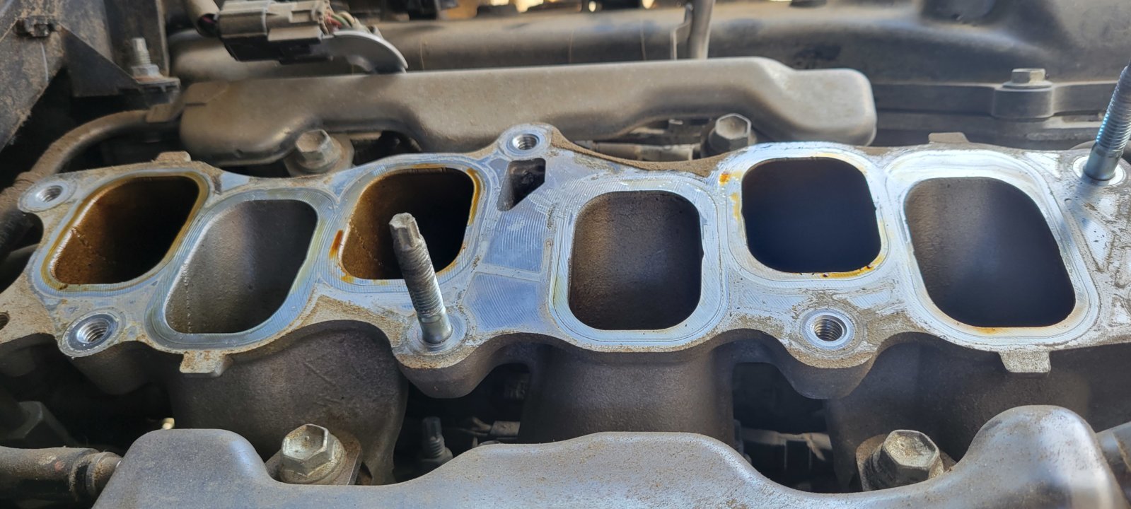

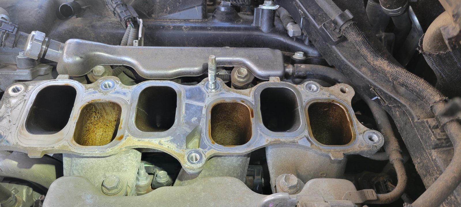

    See pictures. There's oil residue on the intakes for the driver's-side cylinders, but the intakes for the passenger side cylinders are comparatively clean. Is this normal? I took the surge tank off to replace the spark plugs. The truck is new to me, with 82k miles, and not great fuel economy, but no diagnostic codes.
    Would appreciate your input!

    That amount looks okay/normal.

    Probably just due to where the port is for the PCV, I wouldn't worry about it.
