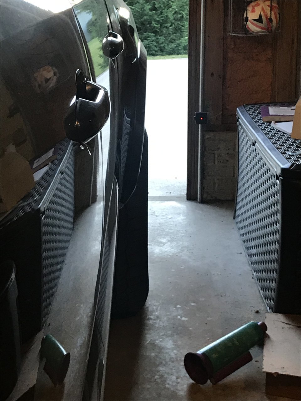

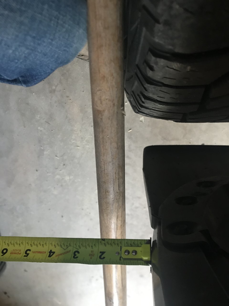

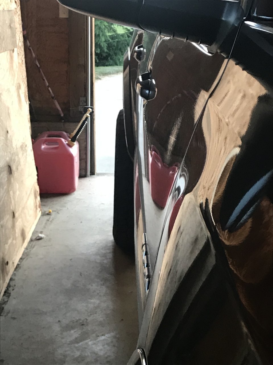

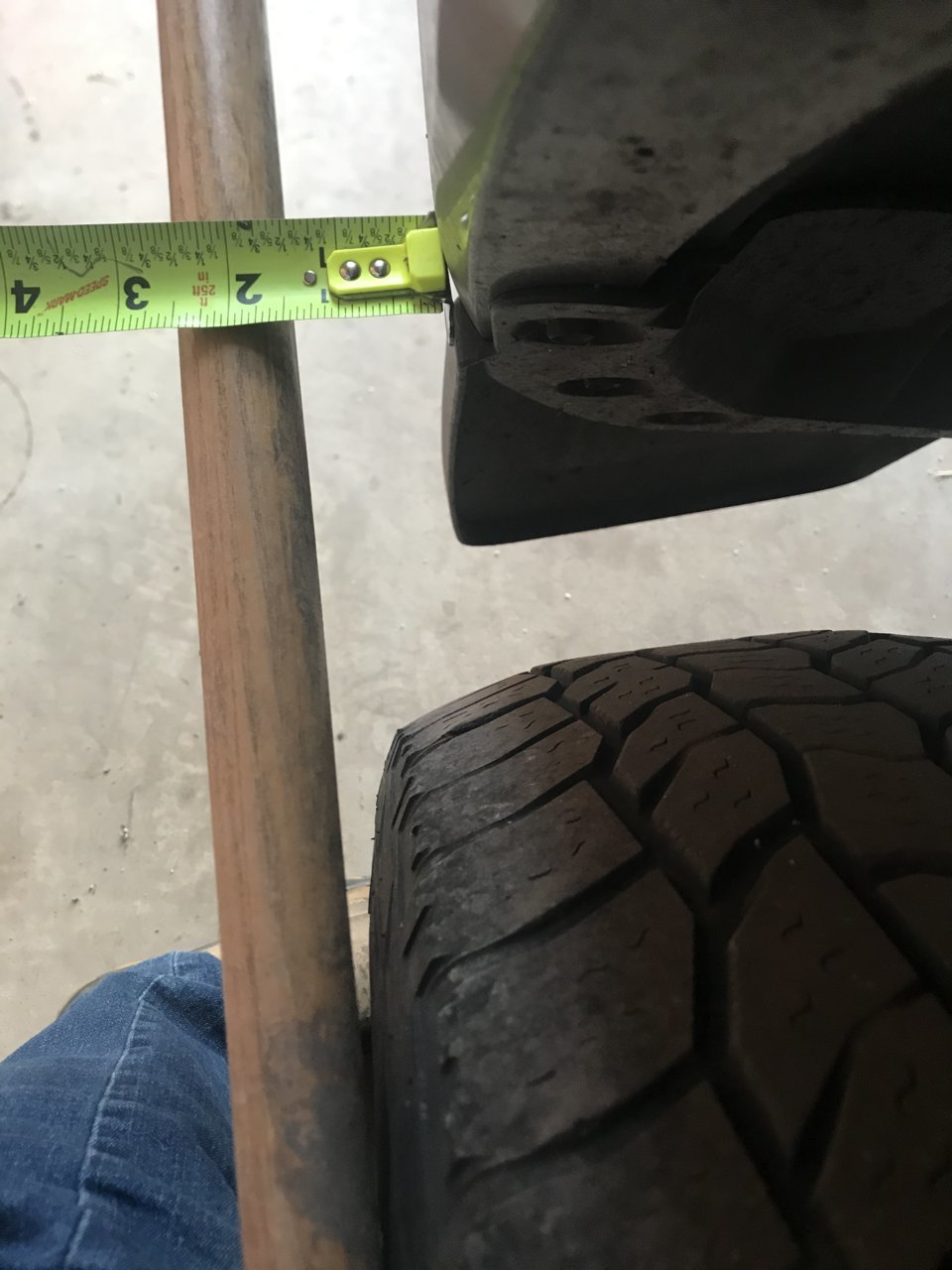

    Hello all. I carefully and properly installed a set of 1.25” Spidertrax. Only then did I notice the rear wheels on my truck penetrate the fenders a full 1/2” differently. Anybody else seen this? Can it be adjusted simply by loosening U bolts and sliding axle over?6A5B0F3E-AF83-4858-9BB5-11601B2C2E4C.jpg AB62946C-C861-4F5E-B2FF-F686D424E8AB.jpg 297B837D-374D-4EB1-8CBD-BD1133C25AB3.jpg 391A82AF-2AF9-40FA-A147-4A6D4BFCFFA3.jpg

    Check your bed alignment before moving the axle.
    There have been many, many reports of misaligned beds.

    No. You cant loosen the u bolts and slide the axle over.

    Loosen bed bolts. Slide bed.

    What was posted earlier. Check the bed for square and alignment first

    Ok looks like consensus is bed alignment... I’ll research the right way to do that. Thanks!!
