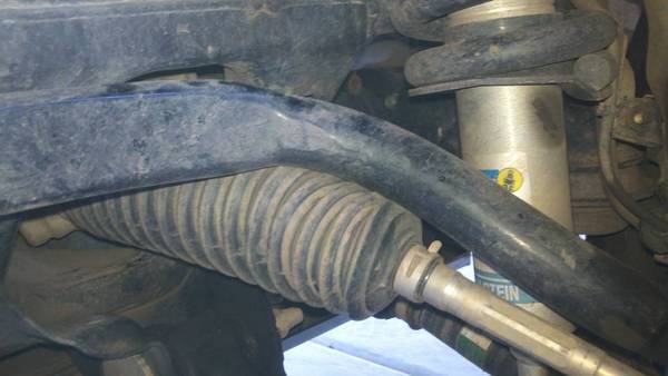

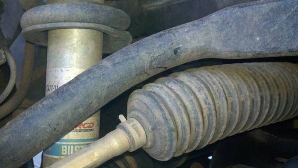

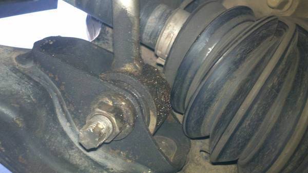

    I had the front end of my truck up on a floor jack last weekend and put the front end at full droop to take a look at everything. While looking at the driver's side, I noticed that my boot just below the control arm was actually pushed up against my spring. Upon further review, other parts are rubbing as well.
    Setup (on for over 1 full year):
    OME 885 coils
    5100's set at .85
    1/4" top plate spacer on driver's side (for taco lean)
    Light Racing UCA's
    Sway bar - on
    Here are the pics side by side. Notice that nothing touches at full droop (although some close calls) on the passenger side:
    Passenger - top boot by UCA (clear of coil)
    Driver - top boot by UCA (pushed up against coil)
    Passenger - sway bar (CV boot clear of sway bar)
    Driver - sway bar (CV boot pushed against sway bar)
    Passenger - CV boot (boot just clear of shock mount)
    Driver - CV boot (boot just touches bottom shock mount)
    So, my question is... is it possible that only the 1/4" top plate spacer on the driver's side is causing such an off-balance positioning at full droop? When I lower the truck back down and have it sit level, everything clears and is fine. Boots are all intact, as I'm obviously not at full droop very often (and if so, it's very quick).
    Any thoughts here as to why there's such a huge difference? I double checked that both shocks are still at .85 and that one didn't slip, but they are set fine. I noticed nothing bent at all on either side.

    Yes, I'd say it's form the top plate spacer. You could also rotate your coil on the DS so the boot won't touch it.

    Not saying this is your issue but I've heard before that the coil orientation (twist) can have an affect on the UCA hitting the coils, or in your case, the boot.

    all that combined is the problem. You are not suppose to preload the OME's. you need to drop your billys down to "0".

    My questions aside from the preload of the coil would be.....Are the LR UCAs set the same on both sides as far as what caster setting they are on and is the nut on top for camber adjustment about the same place in the elongated slot on both sides? Not really seeing the 1/4" top plate spacer for taco lean being an issue. I'm betting the coils aren't oriented the same on both sides and/or the UCAs aren't setup the same on both sides.

    But the preload won't affect the droop. So even if he sets them lower (which I agree he should), the suspension will still droop the same amount, leading to the same contact with the UCA boot and coil. Only the top plate spacer increases droop in this case.
