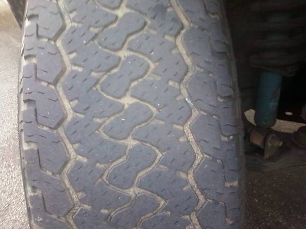

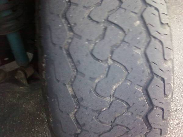

    is it my alignment, or is it a busted shock? i have recently asked two different shops about my uneven wear on the drivers side tire.one said it was my alignment. the other said it was a busted shock, he tested this by pressing down right above my fender on the hood. he came to his conclusion because of a hissing noise when it was depressed. could it just be that at one point in time the tire was ran on low pressure ? here are the pics. drivers side of the tire not the whole left hand side of the tire[​IMG] the passenger tire looks pretty normal??? [​IMG]

    I would see if your camber or Toe is off

    you can hav your allignment checked.best time to do it is right after you change your tires.looks like you dont hav much tread left on both tires in your pix.

    Toe & camber are alignment adjustments. Both are checked with alignment. I'd just get an alignment done.:) I've seen much, much worse though. How many miles?

    How old are the tires?
    They look pretty old.... Are you getting new tires soon? I wouldn't necessarily worry about an allignment until you get NEW tires.
    Sometimes I wonder if the tires wear funny when the tires get old & thin. I had a set of Bridgestone Duellers that wore on the insides when they were getting old & thin. I had the allignment done when new and had it checked - and nothing was out of spec.
    When the shocks are bad, you'll usually get CUPPING - uneven choppy tire wear.
    Here's some neat info - Perhaps balljoints are going bad?
    http://www.aa1car.com/library/tire_wear.htm
