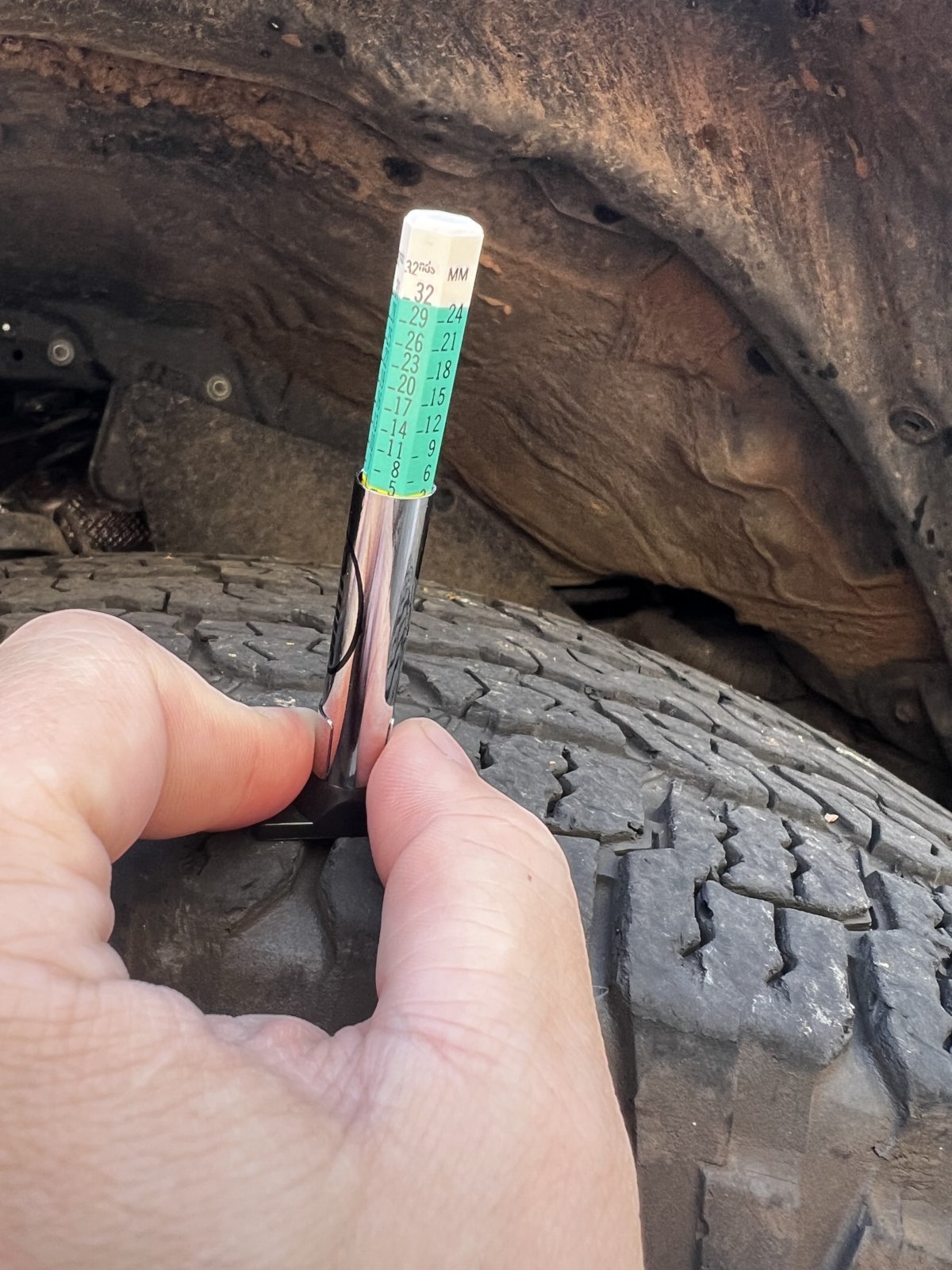

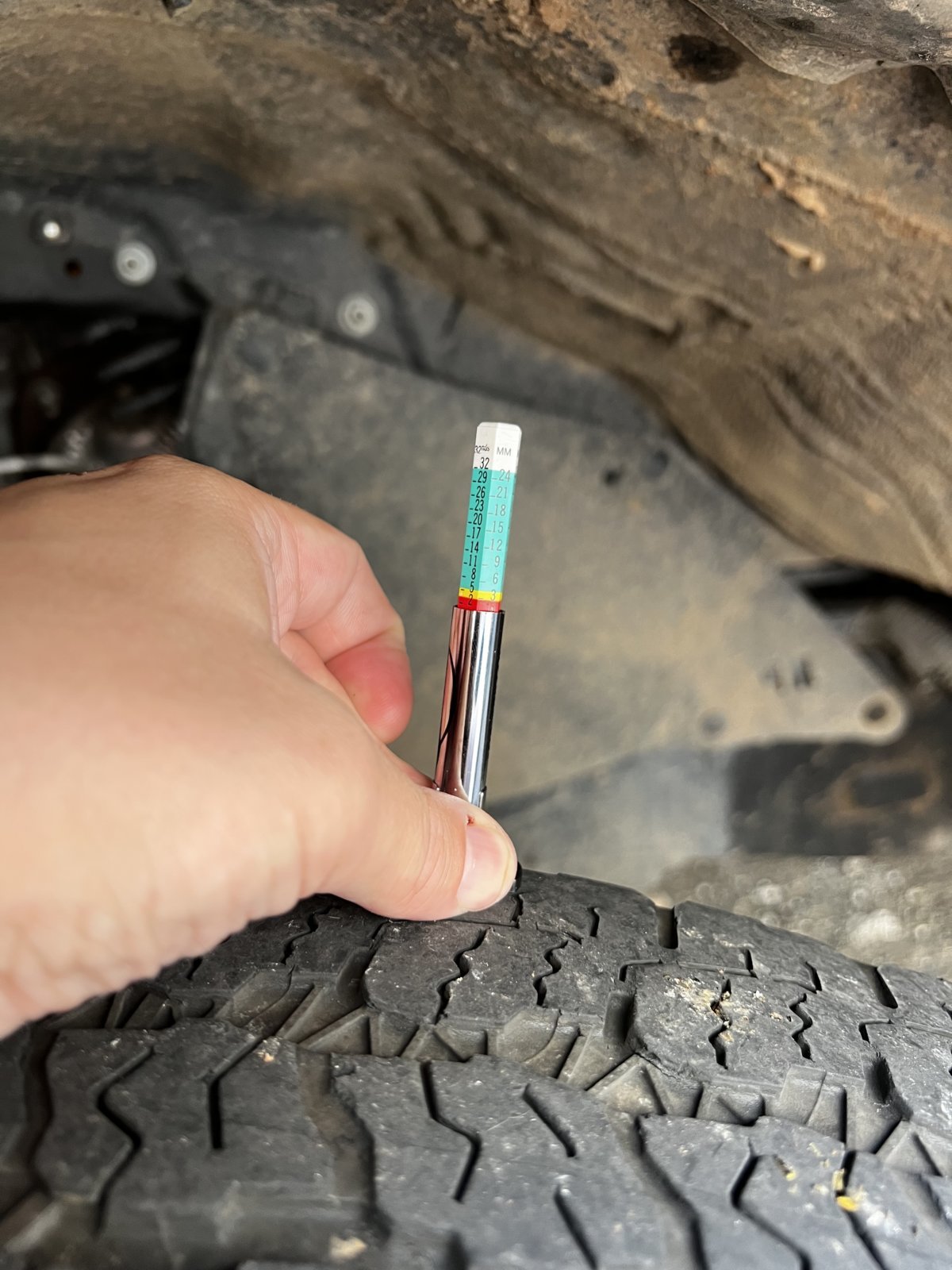

    I went home and took a look myself- the inside of the front two tires is significantly more worn than the outside. I measured ~5/32 on the outside of each tire, and ~1/32 on the inside.

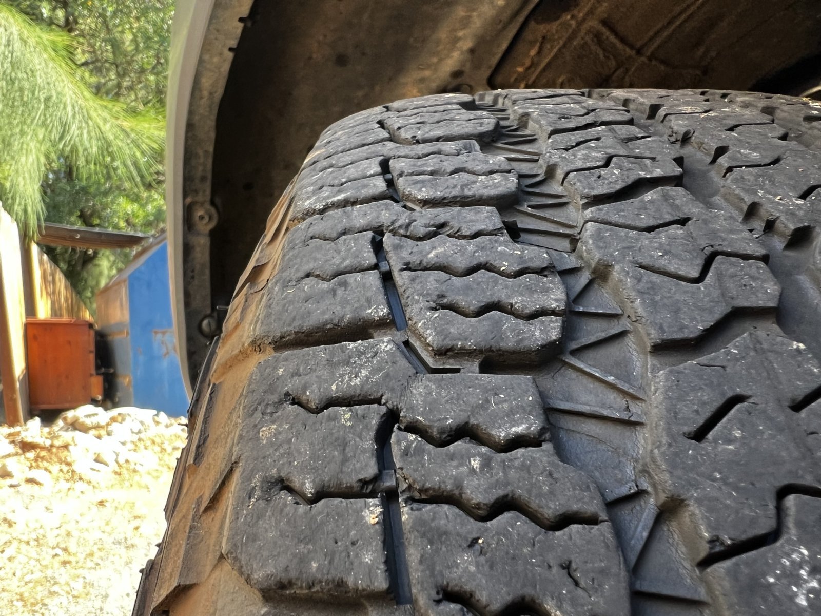

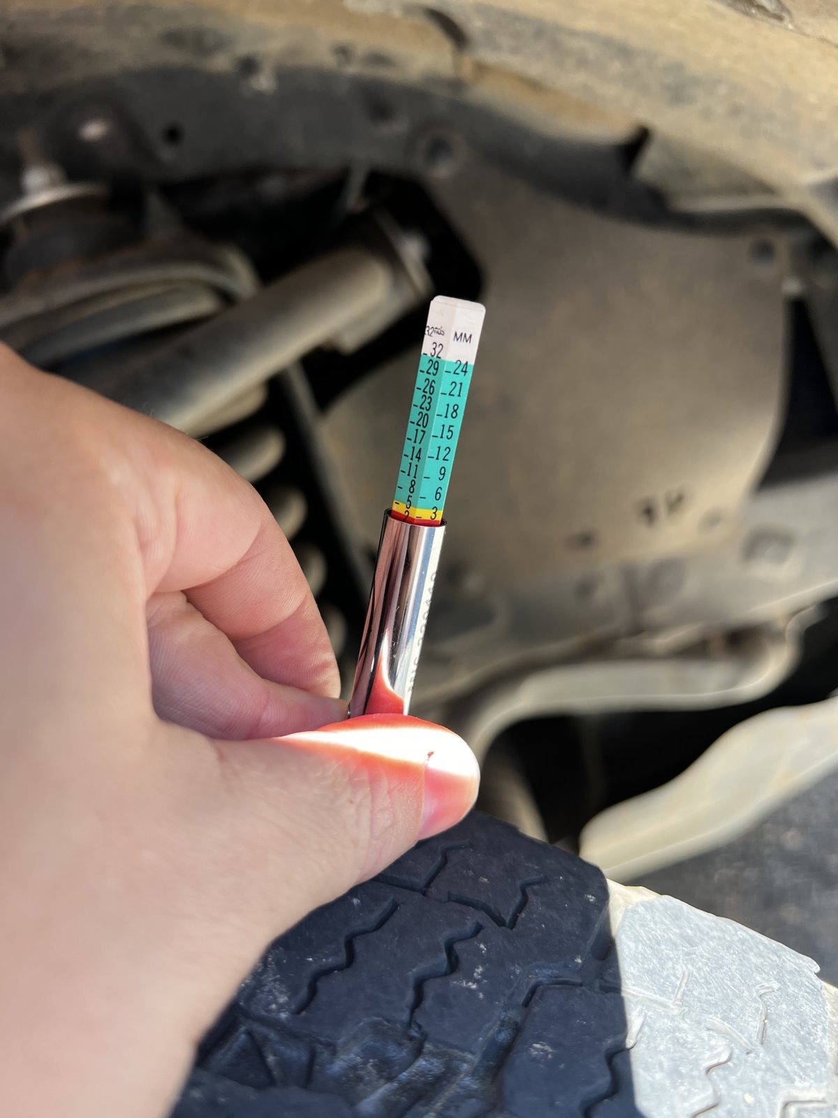

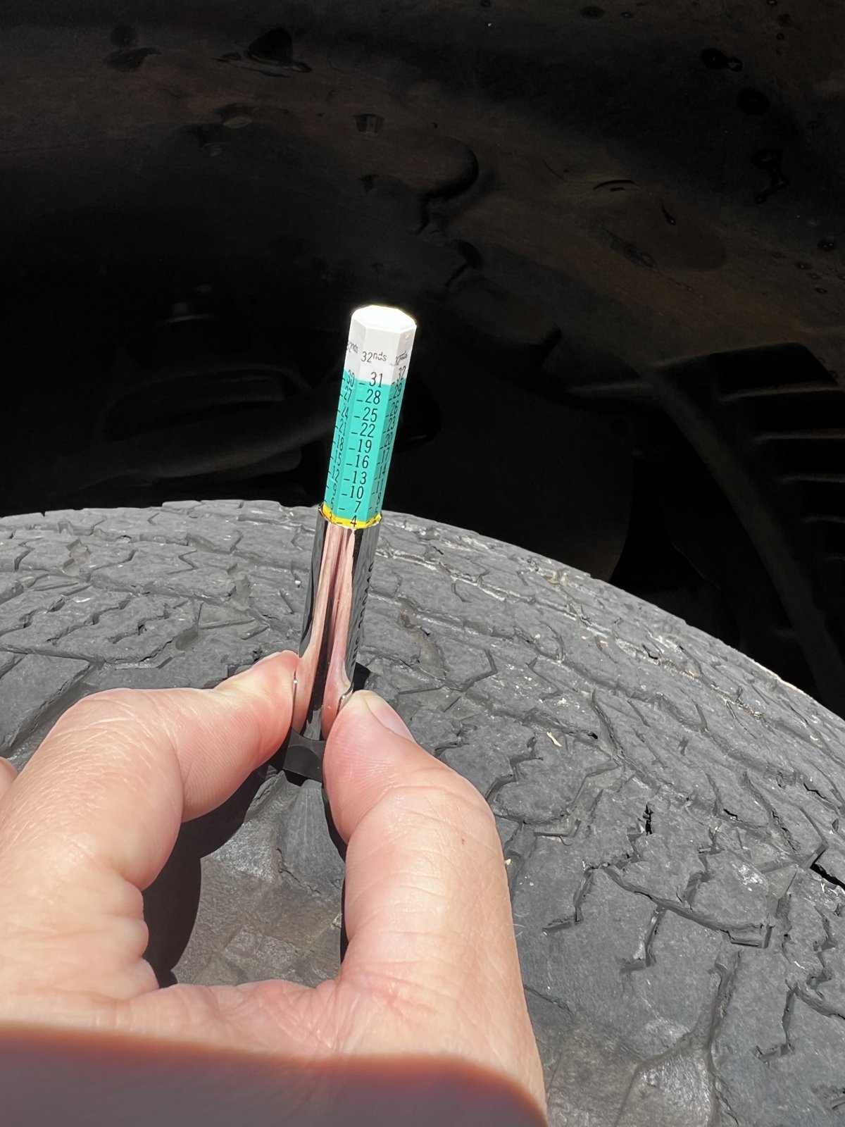

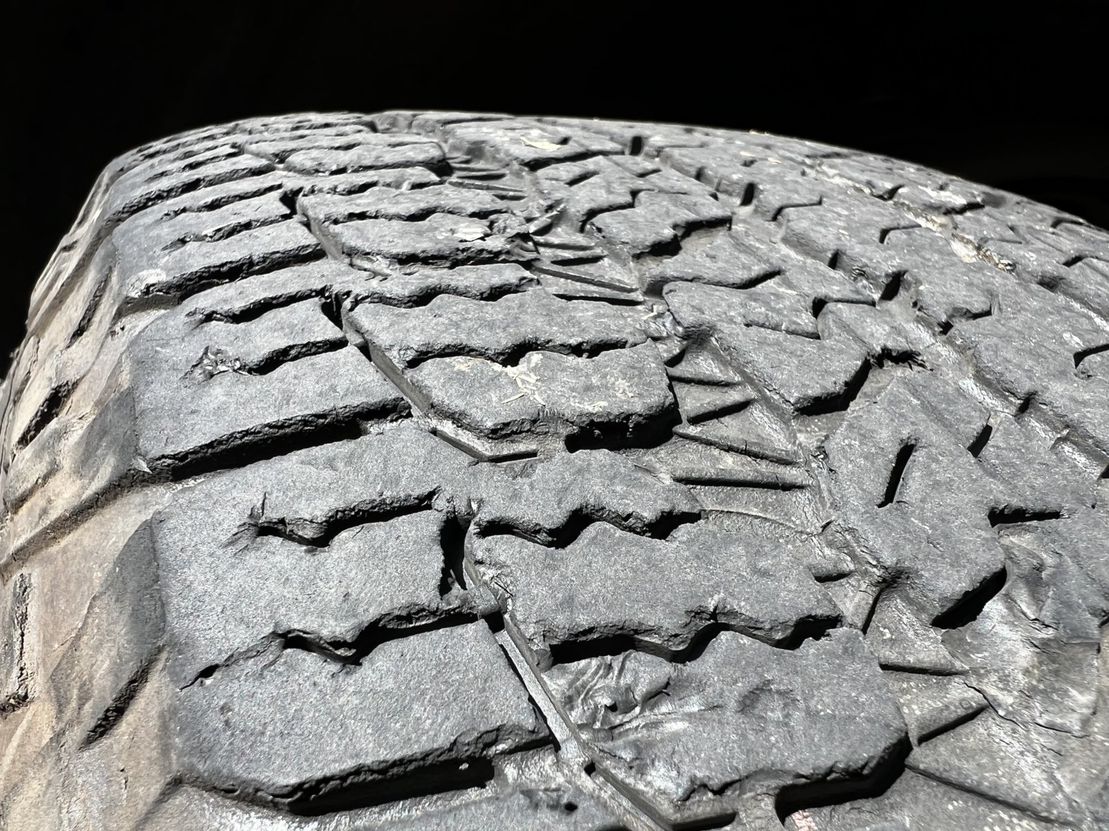

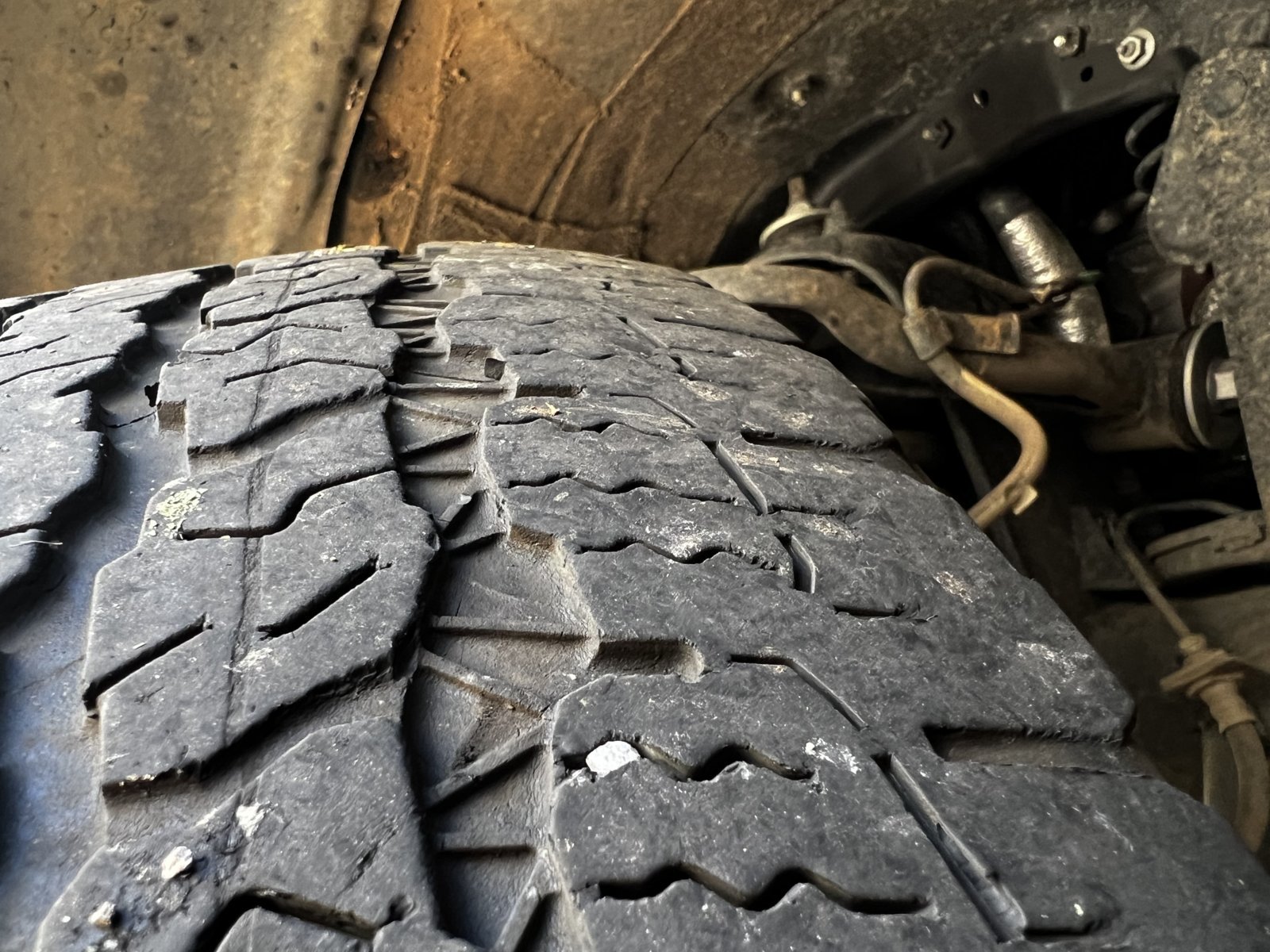

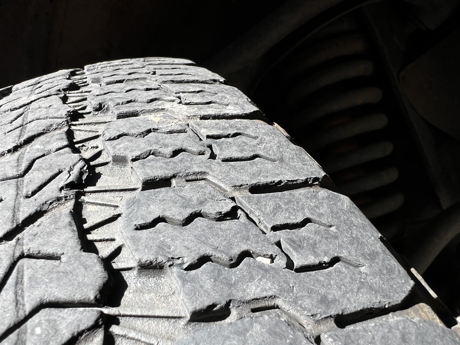

    Wish I could say that it's 25k miles on rocky trails, but I've been camping like 3 times since buying the truck and all three times were ~10 miles of maintained forrest service roads. I drive to/from my grandma's house to drop the kids off for day care 3x per week, and carry 800 lbs in the bed for random projects every couple of months.
    Posting some photos:
    Driver side:
    Passenger:
  5. Jul 1, 2024 at 4:44 PM

    A few, mainly added skids. I like leaving the suspension alone. I drive forest service dirt roafs in the desert west extremely extremely too fast. Toyota nailed this suspension going 65 across desert terrain. Changing it is dumb unless you have a specific need like crawling or mud.
    That's actually not to bad. If those are the factory wranglers you did all right. Mine looked about like that at 25k. Remember that the tires that came on the truck are meant to last about 30k tops.

    The first thing you need to do is find a good alignment shop and have them put it up on the rack and see just what the numbers show you. They will tell you most of the story. Most dealers are less than useless when it comes to alignment stuff. I would not go to a dealer for this unless an alignment shop found something that might be a factory defect or something else that might be under warranty. The most likely scenario is that you hit something and knocked your alignment out which is causing your tire wear. Post the alignment numbers after you get them. FWIW, I took my Tacoma to the alignment shop a couple of days after I got it and had it aligned. It was not in spec from the factory.

    That is an air pressure and alignment issue. Time for new tires, and alignment, and playing with pressures, to get even contact throughout the contact patch. Ski

    those tires are cut to hell, i have 27k on mine and they look better than those, you off road alot?

    Too much camber and running the tire pressure on the higher side???
    You must drive on a lot of gravel or cinder roads. Those are the most chewed up and weather checked tires I’ve seen in a while. Especially for only 2 years old and only 25k miles.
    Agree with others - best bet is independent alignment shop first.

    They are worn all around. Also chewed up as stated. The factory tires on these trucks are known junk. I think you got your money's worth. Buy a better tire and get an alignment. I'm surprised that you are surprised.
