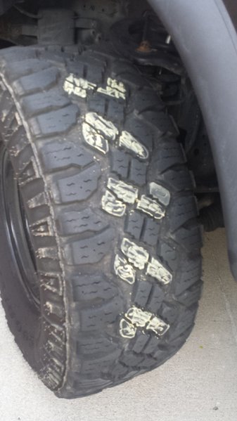

    San Diego, CA
    2016 Tundra 4x4
    I'd also do a chalk test on your tires, you may need to lower the psi. Another thing it could be is a bad Bilstein on the drivers side. It's not controlling the tire well enough and causing the uneven wear.

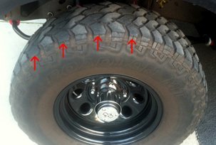

  10. Jun 20, 2017 at 2:49 PM
    skaf402
    skaf402 [OP] Well-Known Member
    May 7, 2017
    #218458
    63
    Omaha Nebraska
    2000 trd Tacoma 105k
    5100 blistein, 33 Goodyear wrangler, snorkel,
    This is basically how my front driver tire is...I couldn't get a good pic of mine but This picture I found is exactly how it looks.
  11. Jun 20, 2017 at 2:51 PM
    ericd
    ericd Stuff
    Aug 13, 2012
    #84703
    1,052
    Eric
    las vegas
    2013 DCSB 4x4 OR
    That's usually caused by a toe-in out of alignment.

  19. Jun 23, 2017 at 6:20 PM
    #19
    skaf402
    May 7, 2017
    #218458
    63
    Omaha Nebraska
    OK so the yellow chalked treads are the lower uneven wearing treads. This exact wear happened on the old front tires before I rotated them. Thsee are the only one of the tires to do this and I've had them on the front for about 2000 miles.
