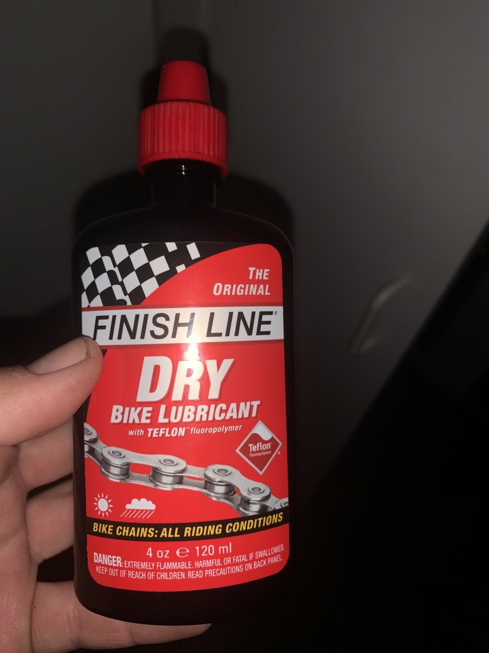

    So I’ve heard many people use tri-flow spray can for uniball maintenance. I have this bicycle lube which says to Have Teflon. Does this work? Or should I get the can

    Seems like nothing is a bad lube as long as it is a waxy substance not a liquid like wd40

    That's because WD40 isn't a lubricant.

    I used that exact lube on my bike chain for years, really liked it. I've been thinking about trying it on my 1911 slide just too see
    how it holds up. I say give it a try, and keep an eye on it.

    I've used that on my TC uniballs.
    Hasn't exploded yet.
    Guess @Kwikvette and I we'll see in about a week...
    Just clean it with a rag or something, and drip it in there.

    Lmao I’ve been using it but you should clean the top before you do add some cause of dirt etc

    Personally I prefer wet chain oil for my bike chain, helps the chain last longer for me.
    OP, I dont see why you couldn't try. It should dry and not attract dust to the surface. WD40 also makes a silicon based lubricant

    Depends on the conditions you ride in. In the wet/rain, you want an oil lube so it doesnt wash off mid ride, but for dry conditions, the oil attracts dirt and a nice crust will form. That's where the dry lubes are far better.

    Yeah, the teflon stuff washes off pretty easy, so in a mix, you end up with the wet lubes. Not ideal, but as with most situations, it's a compromise.
