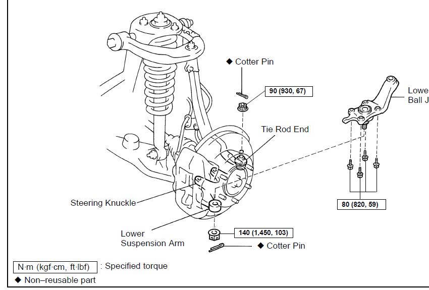

    Where is this info that the bolts are one-time use? I put new bolts on when replacing mine just because, but the fsm doesn't say they are one time use. Wondering if I'm missing other one-time use components relying on the fsm.

    I don't think it's official...people just recommend that because they are cheap insurance/peace of mind. I've had my LBJ bolts out a few times when replacing CVs and I've reused them each time, no issues here. And I wheel my truck regularly. It's not like they are being subjected to a lot of torque to tighten them, just 59ft/lbs if I recall. Use med (blue) locktite on them.
    now, excuse me while I go knock on wood

    It's your call. But my wife and kids ride in my truck. They're worth more to me than 8 bucks...don't get me wrong if I had to I'd reuse them. But at 186,000 miles I'm swapping them. Cheap piece of mind.

    I usually clean the threads liberally with brake cleaner before install, then use red loctite (no fucks given), torque to spec, and don't drive it for a day or so to let the loctite fully cure. You can still remove the bolts with red loctite, it's just not nearly as easy.
