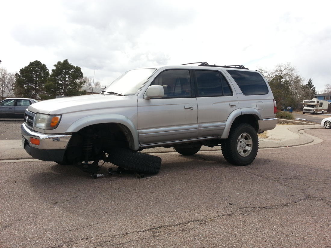

    This thread reminds me, i should buy a set of ball joints to keep for trail repairs.
