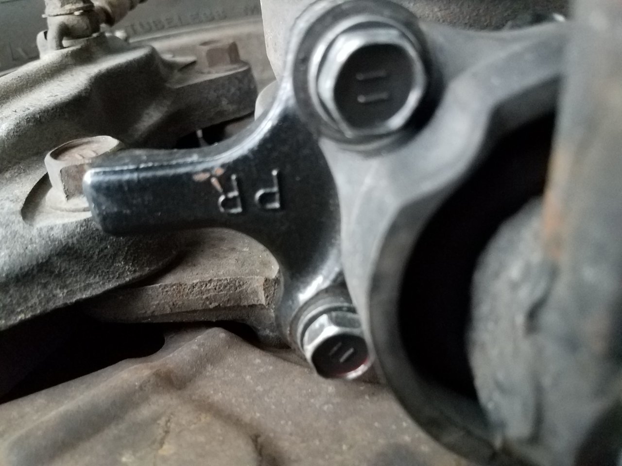

    When replacing my LBJ with new OEMs, I could not torque the bolts to the 59 ft/lbs spec. The supplied OEM bolts would yield and stretch. Two of the bolts had stretched more than .030".
    I changed the bolts with these McMaster-Carr bolts. They torque to spec firm with out any stretching. They're much stronger than the set of OEM bolts I had and are dirt cheap.
    https://www.mcmaster.com/95735a635

    It's been a couple of years ago but I think they were the bolts that came new with the LBJ kit. When I was trying to figure out what the heck was going on I found this.
    http://www.dansmc.com/torque_chart.htm/
    It seems the FSM specs a torque for a grade 12.9 bolt but Toyota was suppling grade 10.9 bolt at the time. The supplied LBJ bolts were able to torque to 47 ft/lbs with out stretching but unable to handle 59 ft/lbs. Now it sounds like Toyota has since fixed the snafu.

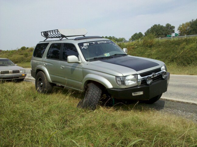

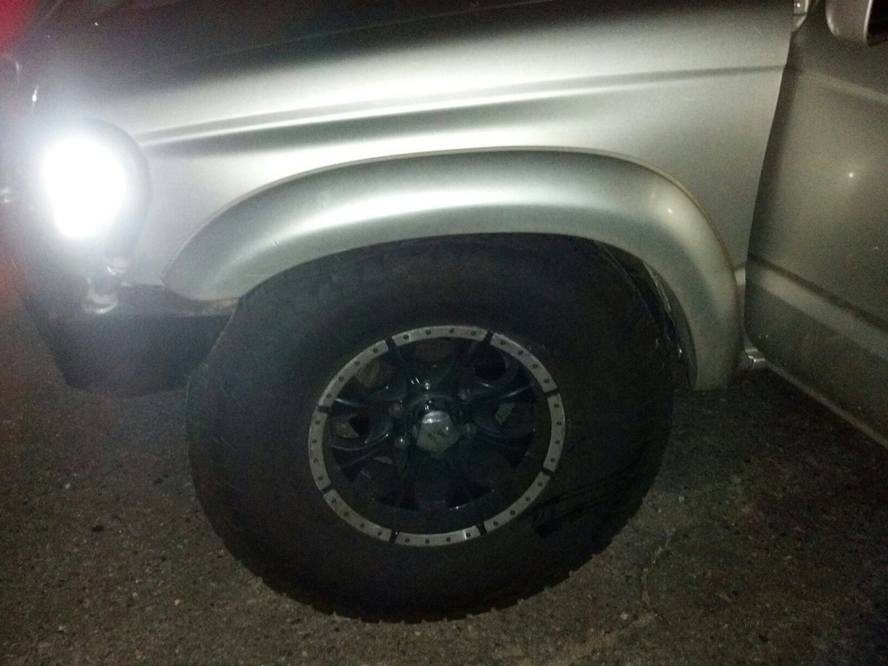

    Although it isn't a Tacoma, I've had the issue on both sides of my 4runner at both slow and fast speeds about 2 years apart from one another.
    Backing up and the lower ball joint sheared off.
    Traveling about 60 mph when the lower ball joint pulled out.
