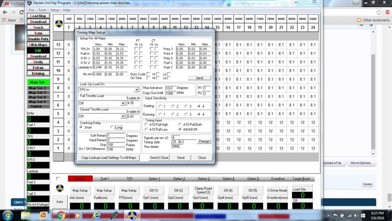

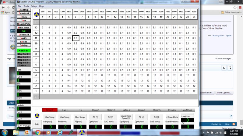

    example of my current timing map
    This shows the adjustments for the the timing map...

    What is the data used on Y-axis? I heard from a tuner that they normaly work with the MAF readings (g/s) to tune the timing.
    It's probably not the timing map but the map of the values used to trick the sensors (corrections applied to 0-5V signals).
    You can use the fuel map to correct your AFR in open loop and you can probably use one of the option map to trick the OEM AFR sensor in closed loop.
