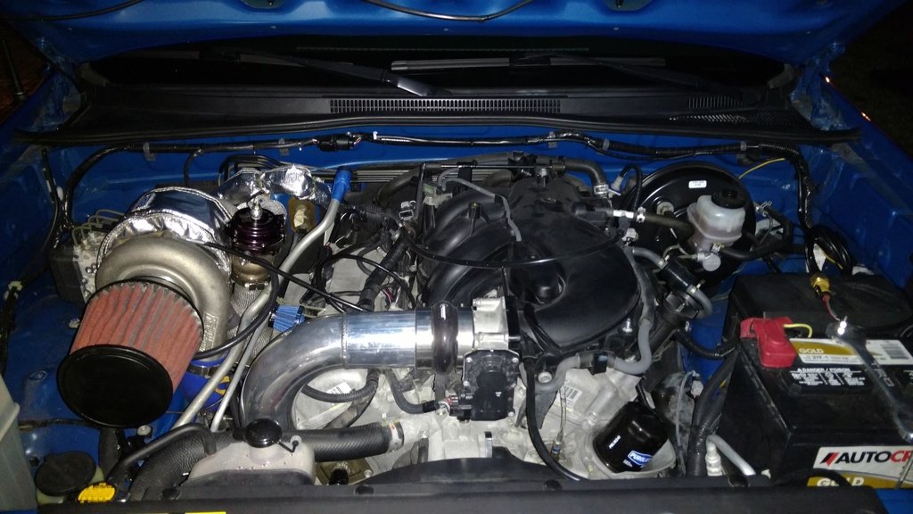

    800cc Siemens/Deka Injectors URD Fuel Pump Upgrade Haltech Elite 2500 Custom Power Fab Precision Turbo 6676 @8 PSI 3" Custom Exhaust from turbo out
    shr133
    I have been running the Unichip as well for quite some time. I was N/A and found it to work well. I am now turbocharged and have continued to use it.
    I am seeing some boost as this is a new setup. I am still very cautious. I think the Unichip works well for what it is and I am glad to see you experimenting with it as well.
    I am no longer alone! I hope I can get the truck dialed in with the Unichip, if not I'm going to attempt a parallel installation using a Haltech Elite 2500.
    One issue I have come across has been at very low throttle position the throttle kind of goes "dead". Have you experienced this at all?
    I may start with a clean map because I have done some serious tinkering and may have changed something I shouldn't have....

    Unichip makes a "turbo module" which allows for switching maps when it sees boost. Basically a map sensor that switches the fuel map...
    Not sure how well that would work with the factory ECU trying to get to 14.7 in closed loop no matter what....
    Thinking of using their "full throttle" map to force full throttle/open loop early in the load profile...
    But to be honest the truck runs pretty darn good for every day "normal" driving...

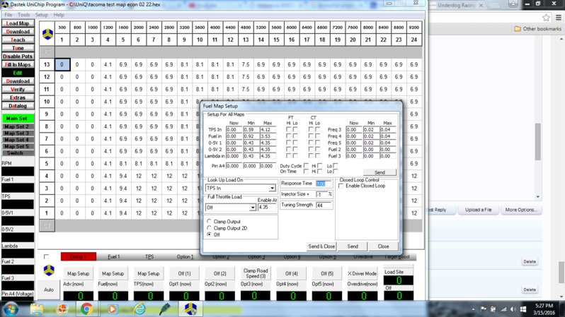

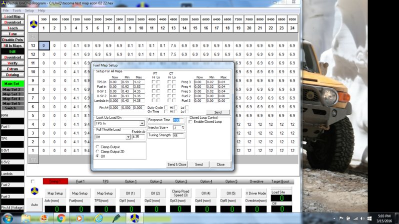

    Maybe your base adjustments are off, you need to use the accel feature for low rpm before the turbo comes on or tweak the TPS map for low rpm... I'm not having any dead pedal issue but at first it felt a little soft... On my frs after a reflash I turn the ignition on cycle the gas pedal 10 times and turn it off to reset the computer...
    You may want to look into the URD AFR Sensor Calibrator for closed loop with the turbo... I'm still running my the unichip with my maf cal until I have time to convert the map over and it works fine...
    Here are my fuel map settings... Still stock...

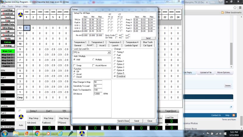

    You can also cheat in some extra timing below load of 4,( maybe not this much with a turbo) because the 4.0 it a little flat at low rpm with the stock computer...
    Go into extras for the accel feature. I haven't tried it yet...
