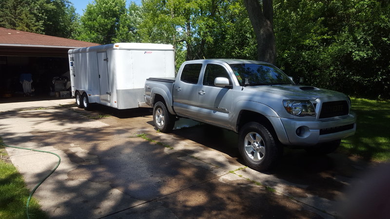

    Ok so I had to tow my trailer filled with my moms stuff maybe 6000lbs total with a 16 x 7 enclosed trailer...........
    Had to tow from WI to MI about 6 hours............
    So running the maf cal for fuel and the unichip for timing...........
    I'll have to say it tows great............
    With the bigger exhaust and 32" tires still kills some low end so it wouldn't stay in 5th but towed the whole way 4th with no problem up hills at 80....
    The intake spacer does help give back some torque........
    The taller tires throw the gearing off for towing but only down sifted when I use cruise control......
    It used to down shift to 3rd a lot and some times 2nd not any more........
    I think I averaged about 8.5 mpg both full and empty so the weight in the trailer made almost no difference in mpg......
    Get a trans cooler.....
    I added a trans cooler and by passed the radiator and it was still hot maybe 180-190......
    Running the dunes it never goes over 170 any more, stock well over 200+ degrees and I burnt the fluid once.......
    Summary, extra timing and fuel help the truck tow...............
