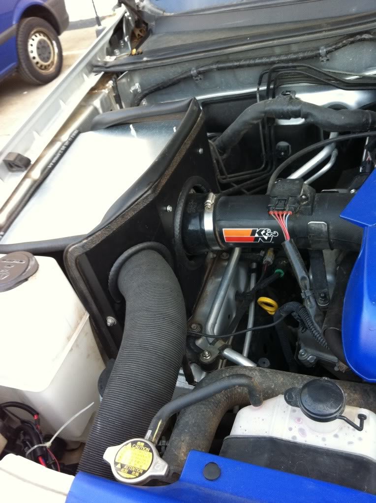

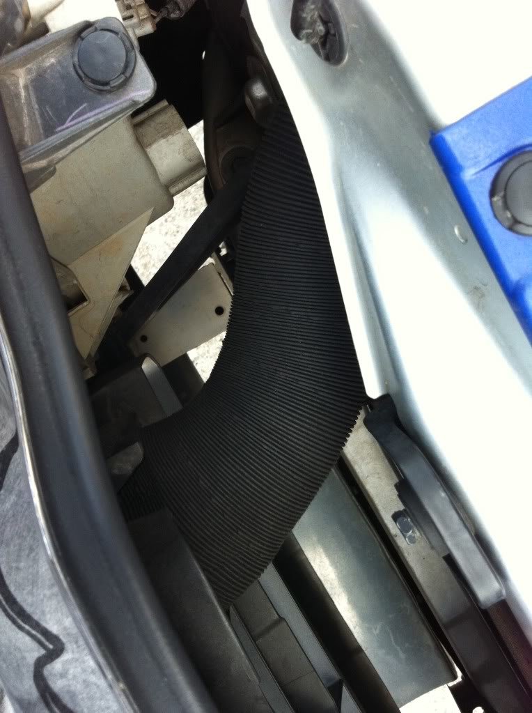

    i do have a K&N CAI and MBRP cat back, i modified my CAI to get more of a colder air because people kept saying how the heat shield doesnt help to get cold air
