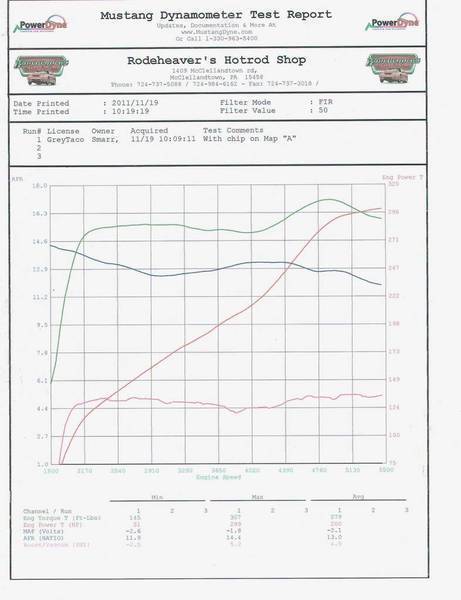

    Pull #3 (2nd dyno graph) - This is with the Unichip installed and running on MAP A which is there "low" setting. MAP B has more agressive timing. On this pull the air/fuel went dangerously lean. Hitting around 13 all the way to redline!! :eek: It was running so lean that they did not want to make another full pull. We did one more run on MAP A just running it up to around 4000 rpms still running way too lean. So we flipped the switch to MAP B (to see if maybe it would richen up) and did a light pull again to 4000rpms while keeping a close eye on the air/fuel it too was the same Dangerously too lean. (It did make more hp but lost tq as well)

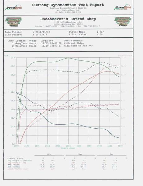

    (3rd dyno graph) - Is a overlay of the full pull without unichips and with the unichips on MAP A.
    I contacted Unichips about this and they blamed it on the dyno saying that they are very inaccurate for newer vehicles. And a run on the dyno is not the same as driving it on the street. They were suppose to have one of there "technicans" contact me but never heard back. Also, they said they've never tested a urd fuel pump kit but still sent me a "tune" that was suppose to include it. They didnt inform me of this when I bought it. :mad:
    (If you click on the dyno runs and go to my photos and click again it will enlarge so you can see it better)

    WITH UNICHIPS ON MAP A

    OVERLAY OF THE RUN WITH UNICHIPS & WITH OUT

    I can't quite make out the numbers. The graphs look good. The frickin torque curve looks great. Can you confim the before and after numbers? Thanks for posting.

    Without unichips 281hp and 318ft/lbs. With unichips 299hp and 307ft/lbs.
    If u click on the photo it should take u to my photo album then just click on thr photo again and it should enlarge enough to see.

    Ummm... DID you SEE the overlay??? Its crap! With unichip tuned you LOOSE gobs of torque and horsepower BELOW 4700 rpm! All gains are made above 4700rpm! No way its worth it for the few hp & tq above 4700rpm!

    Yes I SEEN THE OVERLAY.........If you look at it closer you will see that when it did start to make more power the air/fuel was also starting to richen up from where it was running dangerously lean. So it has potential to make more power through the entire rpm band it just needs to bring the air/fuel ratio down to an acceptable level.

    How does it richen up to run lean?? LOL Yes the AFR is a tad high past 4k rpm than goes rich after 4400rpm.... I agree that with careful tuning you can gain few more whp up top, however I was talking about the area between 2100rpm and 4500rpm where even though the AFR is NOT perfect 13.1 and fluctuates from 12.4 low at 3000rpm to 13.3 at 4000rpm the losses in both horsepower AND torque are significant.
    In daily driving you will only use 1500rpm to 4000rpm, unless you like revving the 1GR high.
    However this is VERY common with N/A modifications on almost every engine, when you free up the exhaust and intake, you loose bottom end and gain up top, nothing surprising there.

    If I can get the air/fuel to stay in the 11.0-11.5 range during the 2000-4000rpm range it could be possible to pick back up the lost power due to it running lean. And by using the Map B on the unichip for more agressive timing could result in a decent gain. They stated at the shop while on the dyno that the air/fuel as it was on the unichips was way too lean. And that a good safe tune should be around the 11.5 A/F @ WOT. I'm no tuning expert but im looking into having the unichips custom tuned to my truck im sure I can pick up power across the 1500-4000rpm range.
