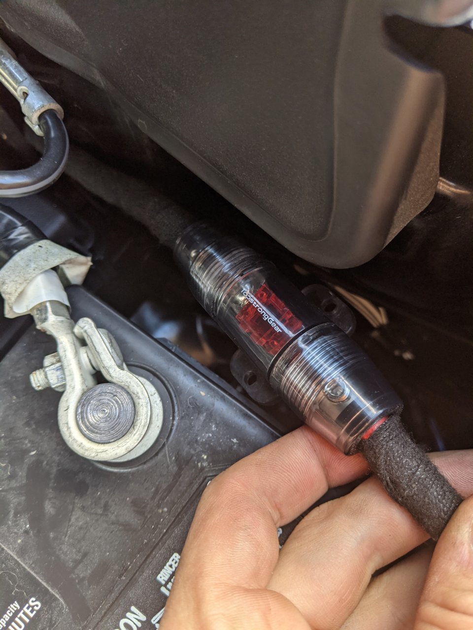

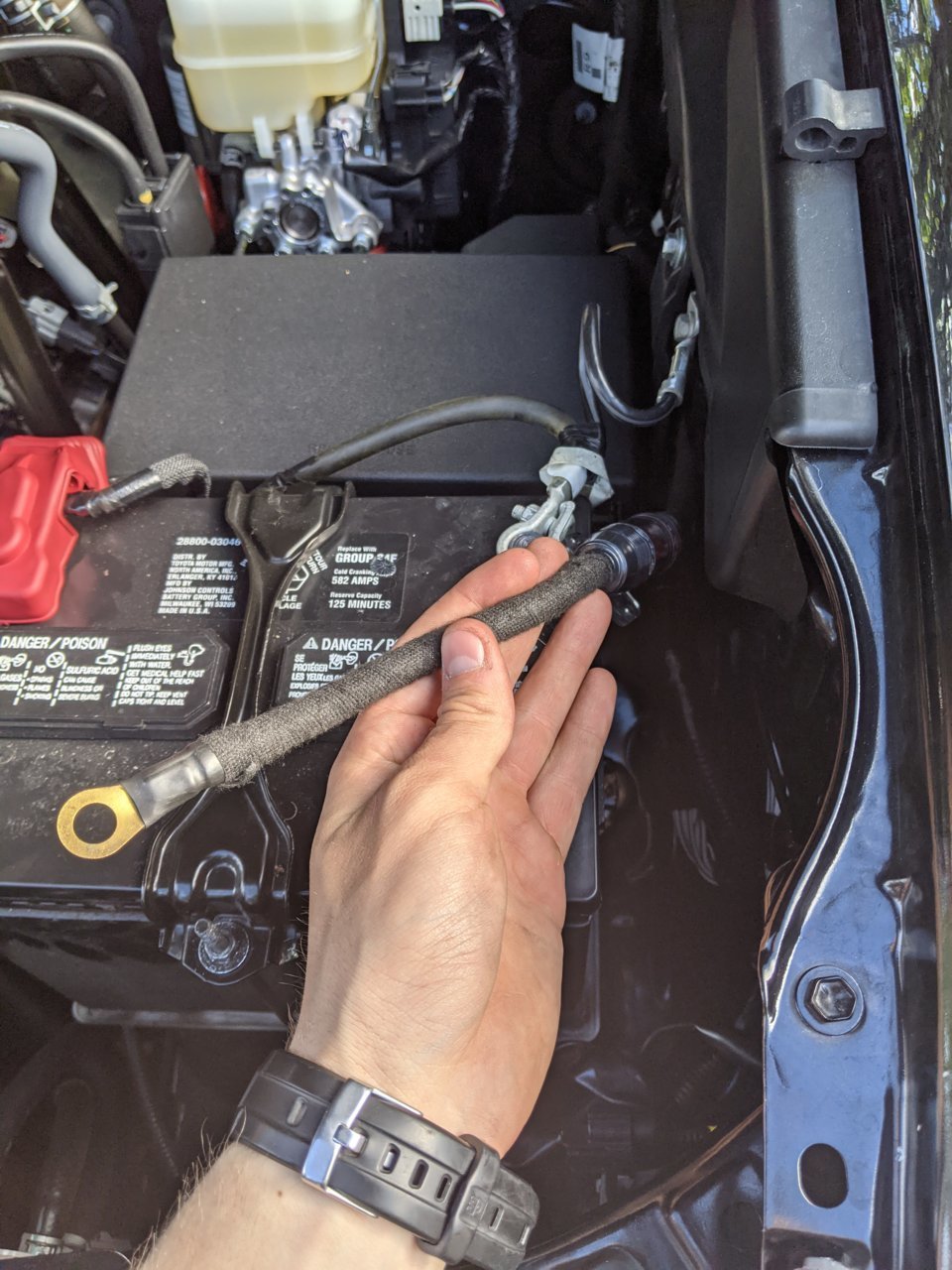

    Was doing some work on my headlights and took out the battery to get some more working room inside the engine bay. I have a 2020 TRD off road with the 3.5l v6.
    When I reinstalled the battery, I noticed a cable near the battery (not the battery cable) and I have no idea what it goes to. It generally concerns me seeing what looks like a cable that should be hooked up to something just kind of floating around. Any help with what the cable is / where it goes would be much appreciated. Pretty new to having a Tacoma, and my googling / forum searching / looking through the Haynes manual have not come up with anything. Thanks in advance for any help.

    Positive cable for an amplifier.

    A cable and inline fuse for "accessories"

    dont connect it unless you know where the other end is touching...

    As was said. Was powering an aftermarket amp. Looks like a professional install with the Tessa tape. You’d have to trace it and find out if it was left intact inside the cab or cut short. Probably either runs under a seat or to the back wall of the cab.

    As already mentioned, Top Strong power cable for an amp. $36.99 on Amazon.
