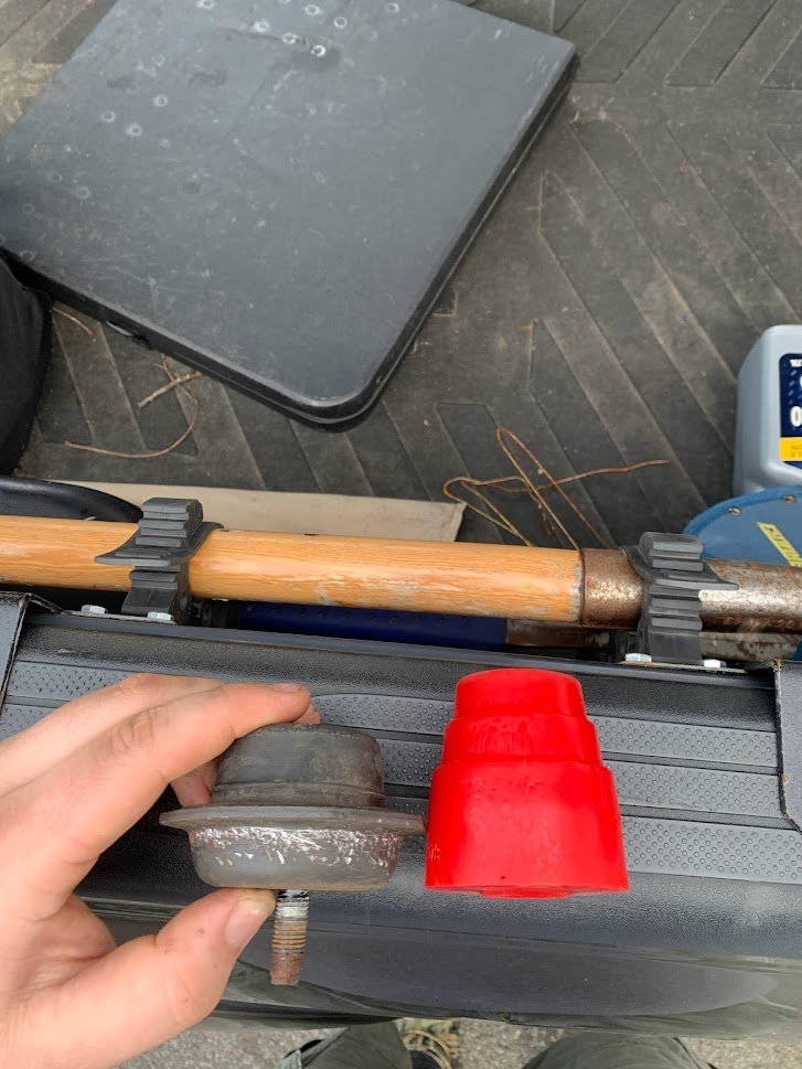

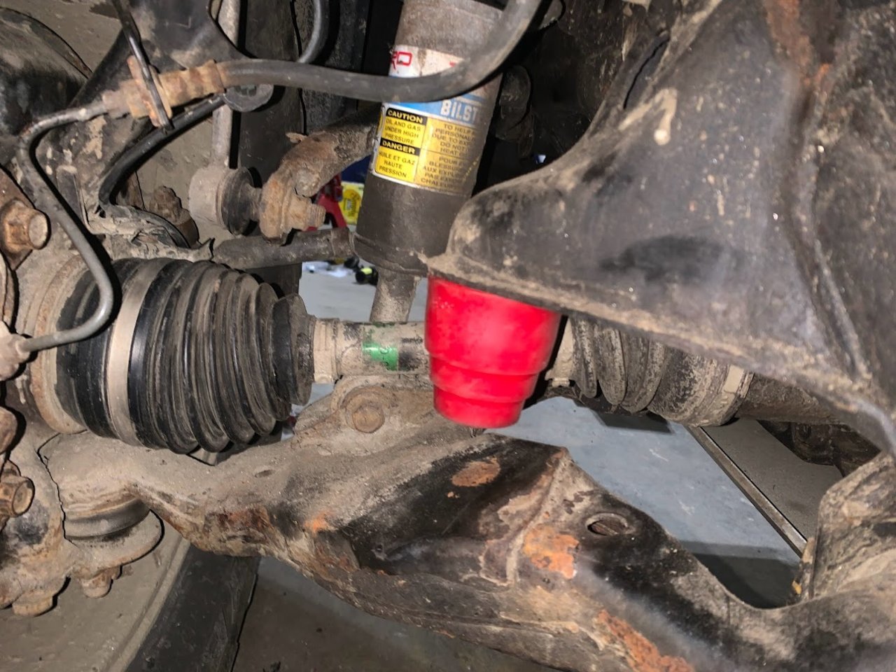

    I left it full, I havent gone anywhere to really test them out but I'll be going this weekend and I'll trim if needed. They aren't too much taller than oem. Thanks I try to keep updating it.

    Yeah, the stock bumps are harder than even hockey pucks. These are much softer.
