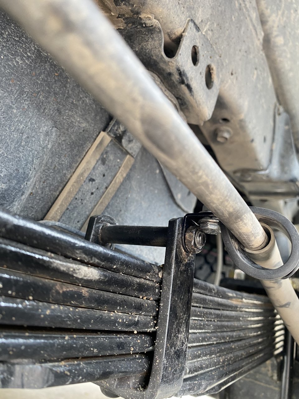

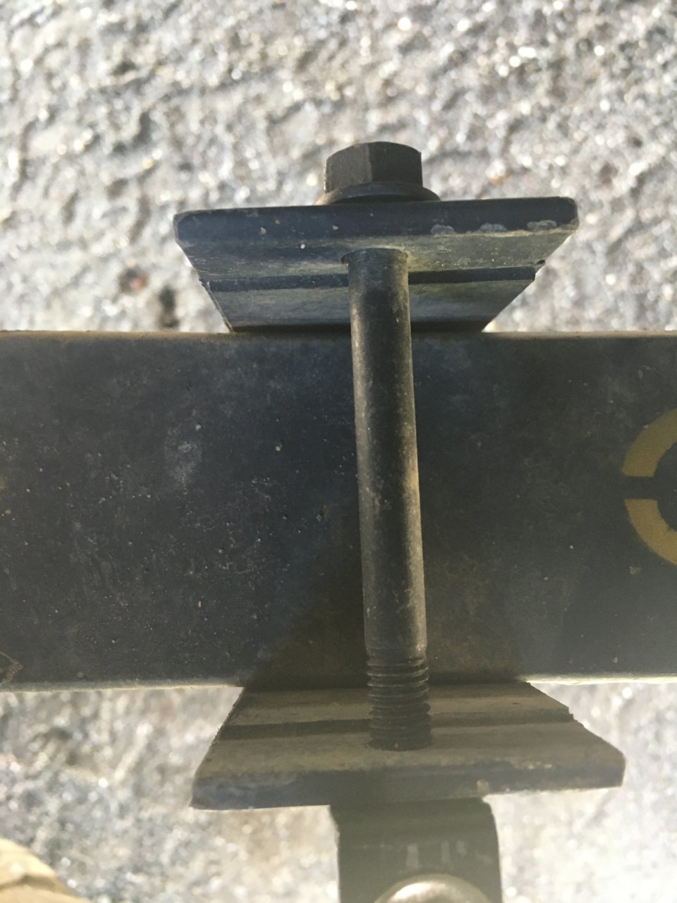

    Hey Ryan got the brackets today! Just got them on thanks again!
    Here is the bolt that needed to be replaced (passenger side) with one that was half an inch longer, was a little difficult to get in had to push the muffler back to to get it in for some reason it faces the same direction as the drivers side.86454A1C-36A3-4895-9DD5-6C9961EAA168.jpgThen I used a 1/2 bolt to bolt the bracket on.
    Hope this helps with anyone running Old man emu Dakar leaf packs.

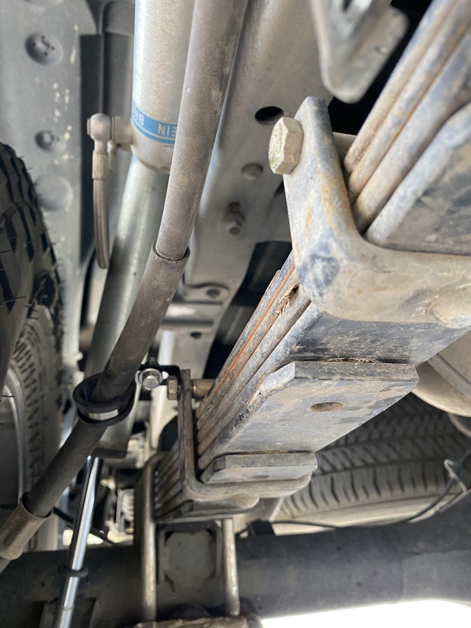

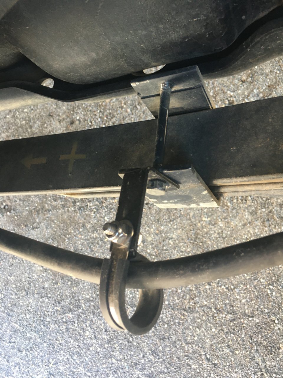

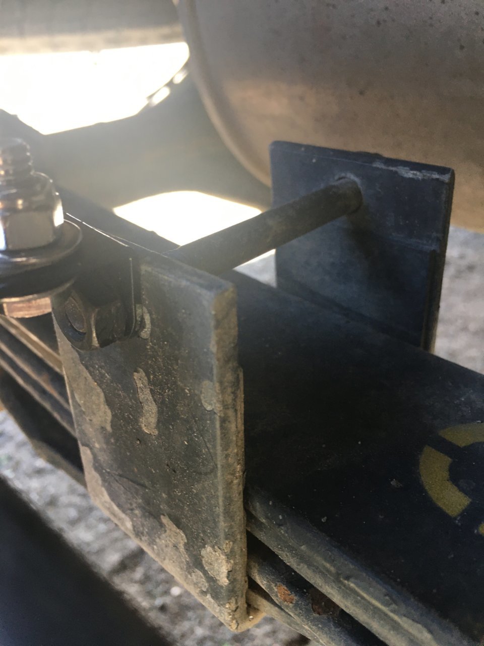

    Got the new versions installed on my own and @EricT trucks. I have a 3rd gen with Deaver U402’s, he’s got a second gen with Icon RXTs- install was easy on both trucks, no replacement bolts needed (see photos)! Just throw em on there! You can see on the second gen with Icons we left more space on the spacer- nice to have that adjustability. Thanks to OP for a simple, functional and good looking product- I highly recommend grabbing a set.

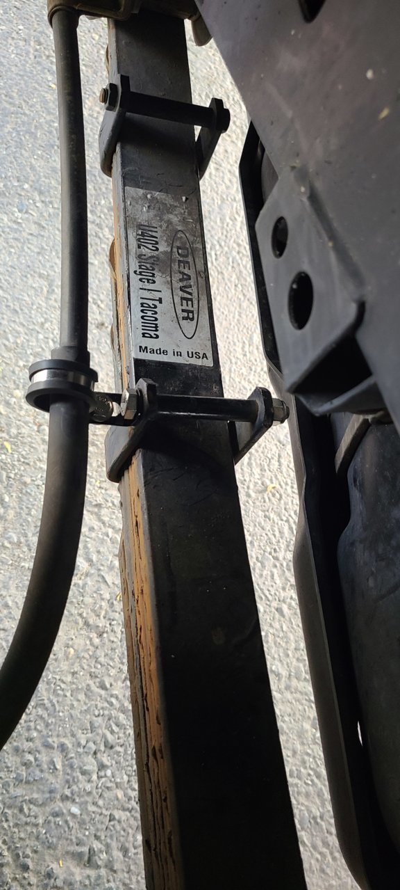

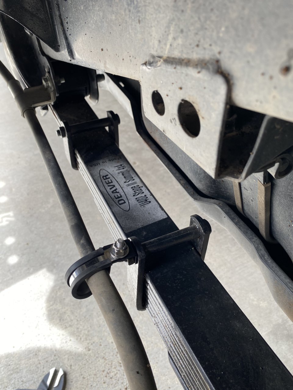

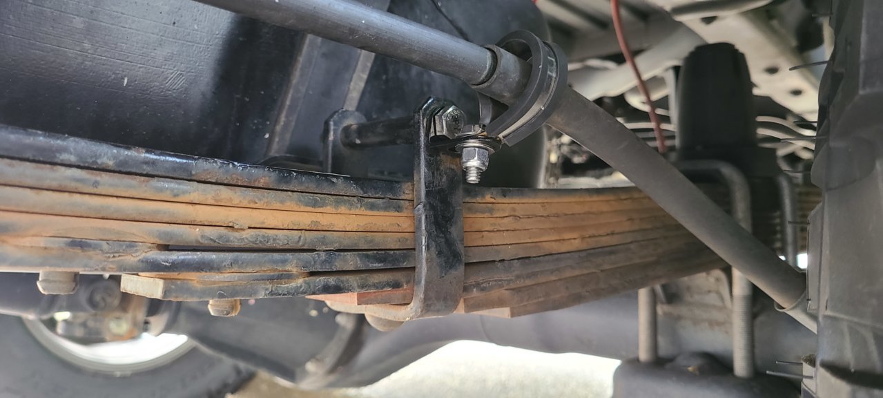

    Just installed V2 on my Deaver U402 Stage I leaf packs. Huge improvement over V1. Thanks OP for the stellar product. Such a simple solution to such an annoying problem.

    Thanks for the pics @Bertw192 looks much better

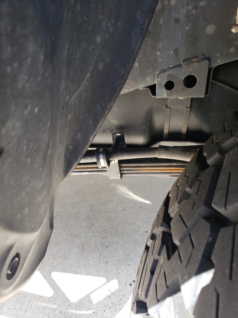

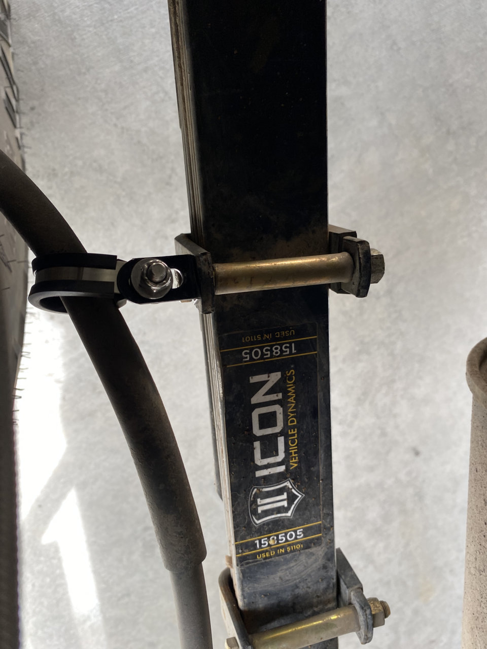

    Got my brackets a couple days ago and just now installed onto my icon leaf pack.

    What leaf packs are those? Weird to see the retainer that far up.
  16. May 6, 2021 at 11:08 AM
    #76
    bigztaco
    bigztaco Well-Known Member
    Sep 17, 2019
    #305506
    77
    '19 MGM TRD
    Icon 2.5" FR and Icon rear leafs w/2.0"
    Icon.
    Before the new bracket, the line kept resting/rubbing on that bolt.
    This pic is when I originally installed the leafs a couple yrs ago.

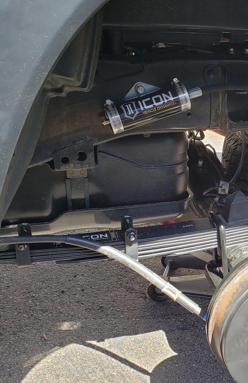

    Ok just looks different than the pic I have of them on the Icon RXT leafs, I think they put them on the other keeper in this pic since it's on the part of the line that has the extra layer of rubber.

    Yea, looks like it's on the other one. As long as it doesn't rub metal anymore I guess either location works‍
    I guess I'll find out soon.. lol
