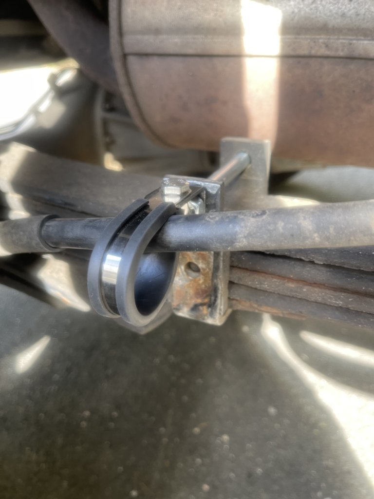

    I'm only offering this advice, as I don't believe OP intends to ever make these again and hasn't logged on in over a year.
    Biaungdo 18x18x30mm/0.7"x0.7"x1.2" Adjustable Right Angle Brackets L-shape Corner Brace Support Black- (15 Pcs) https://www.amazon.com/dp/B07S25BH38
    LOKMAN 20 Pack 1-1/4 Inch Stainless Steel Cable Clamp, Rubber Cushioned Insulated Clamp, Metal Clamp, Tube Holder for Tube, Pipe or Wire Cord Installation https://www.amazon.com/dp/B01ISZLJJE
    Source the bolts at your local hardware store.
    Also, confirm the hose clamp size, but I'm pretty sure that's what I ordered.
  8. Oct 1, 2024 at 6:40 AM
    #128
    MikefromCT
    MikefromCT Well-Known Member
    Oct 23, 2018
    #270327
    3,189
    CT
    2013 TRD OR DCSB
    OME Bp-51; Relentless Armor
    Thanks to the post above, I finally no longer have to worry about my ebrake lines.
    Ordered the brackets and cable clamps noted above. Had to expand the hole in the bracket with a step drill bit- the bolt for the leaf keepers is slightly bigger than the hole on the bracket. Also picked up a longer bolt and nut for the passenger side.
