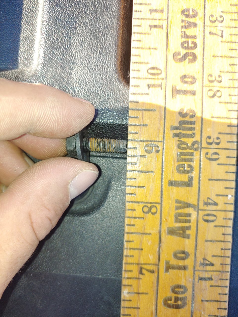

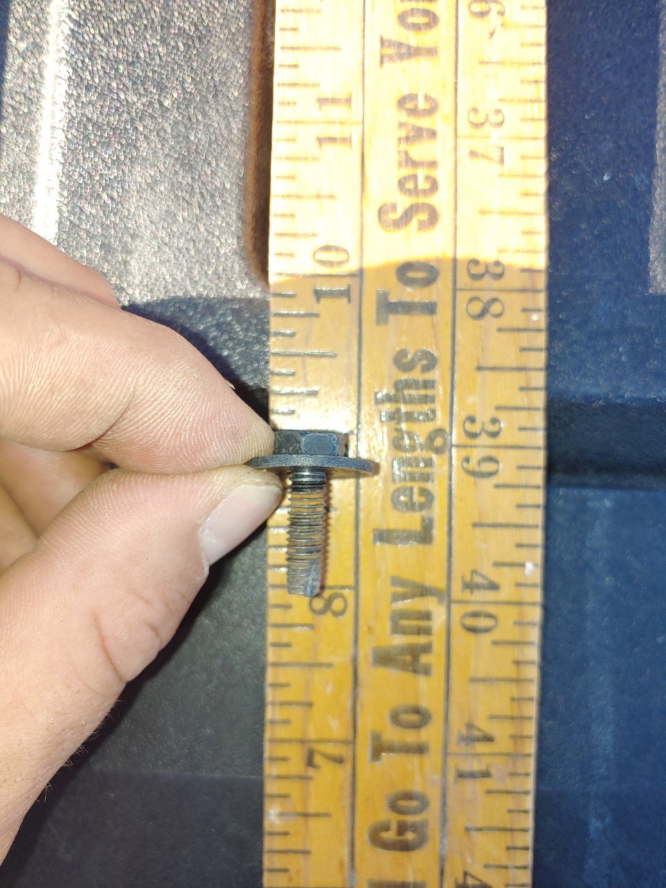

    These are the bolts for Cali Raised tailgate light mounts. There are two inside the bed.
    They're 10 mm. I can't figure out what the official classification is, so I can order replacement security bolts with fancy heads.
    Any ideas?

    when you say 10mm I assume you mean that is the size of the head?
    The are likely M8 if so

    I bet m6 like all other 10mm bolts hex head bolts (socket size)
    Probably 20mm length but it's hard to tell using an imperial ruler to measure a metric bolt.
    Take it to a hardware store - they have thread gauges

    That looks pretty small to be a 10mm unless you're Andre the Giant; I'd quicker think 8 or maybe even 6, depending on the size of your hands.
    Regardless, any reputable hardware store will have one of these gauges that you can use to determine size and pitch.

    M6x1.0 black oxide with a washer
