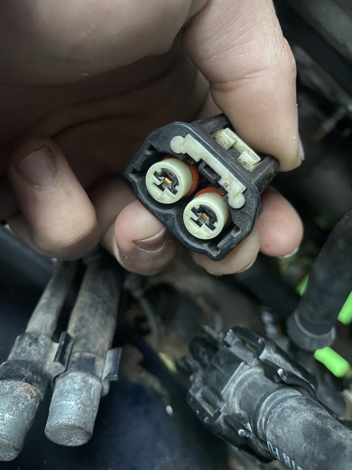

    Can anyone tell me where this plug goes? Doing a motor swap and for the life of me can’t figure out where this goes. It’s on the side with the alternator, ac compressor and starter.

    Does your truck have secondary air? does your replacment harness/engine?

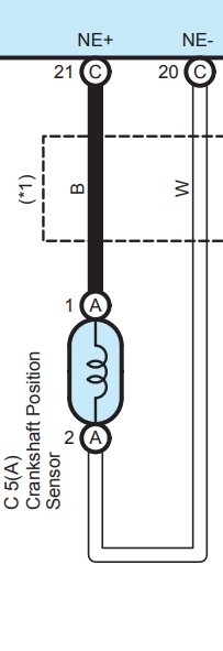

    C5 Crankshaft Position Sensor (1GR–FE) 90980–12028
    Crankshaft Position Sensor (2TR–FE) 90980–11016

    Need wire colors to know for sure but I believe that is the crank sensor connector.

    Man I love this group. Thank you guys!

    If the wires are Black and a White it's the Crank Sensor
