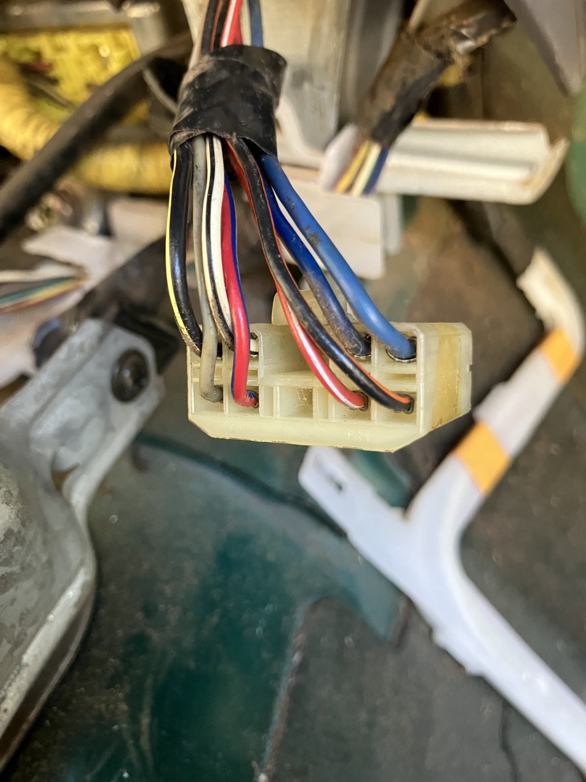

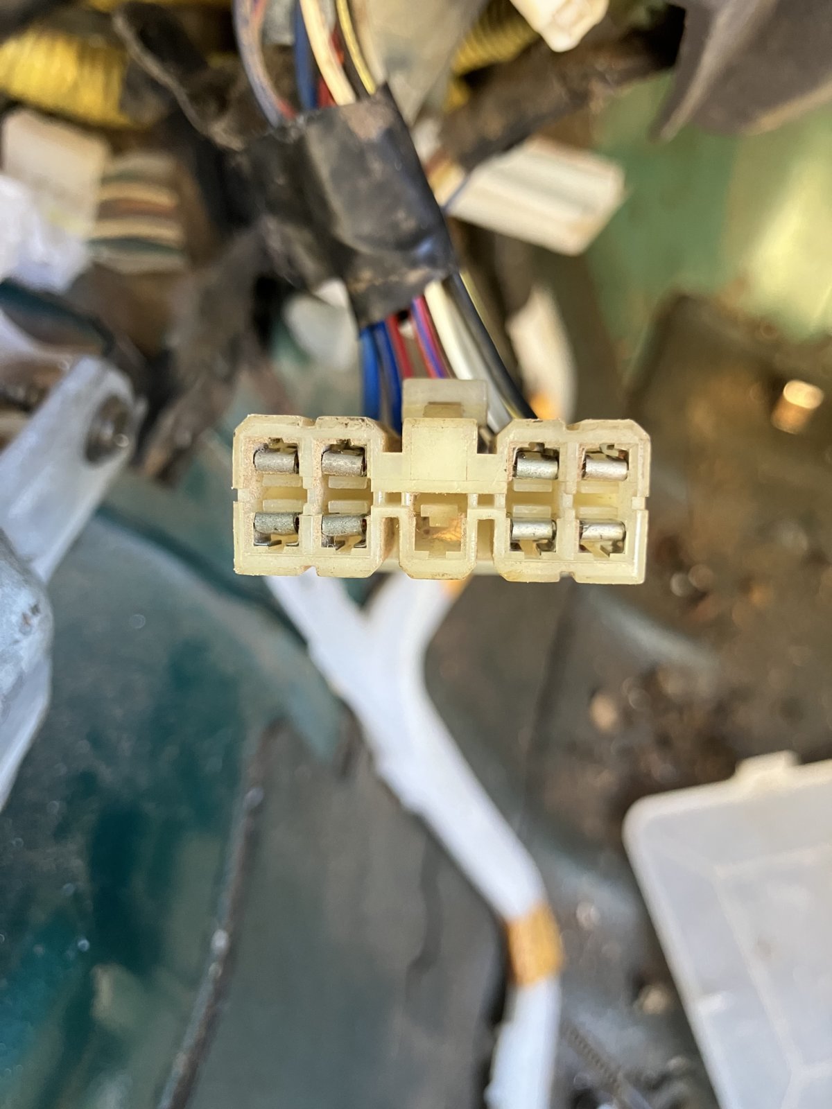

    Hey peeps! I recently removed the dash on my 1999 Tacoma sr5 4x4 to replace the heater core. After I got the dash back in and started putting in the radio I noticed a couple of connectors that were not connected to anything. I have searched hi and low across the interwebs and can’t find anything. Any idea? I’ll get a photo of the other one and post shortly.

    Anything that has never worked??
    Has your radio been replaced with an after market system that did not use the factory harness.
    Any other options your truck does not have?
    Is this harness over close to the left door post??

    Everything works as far as I know. Still has factory radio. This connector is directly behind the ashtray.

    That's in the passenger footwell near the center console, right?

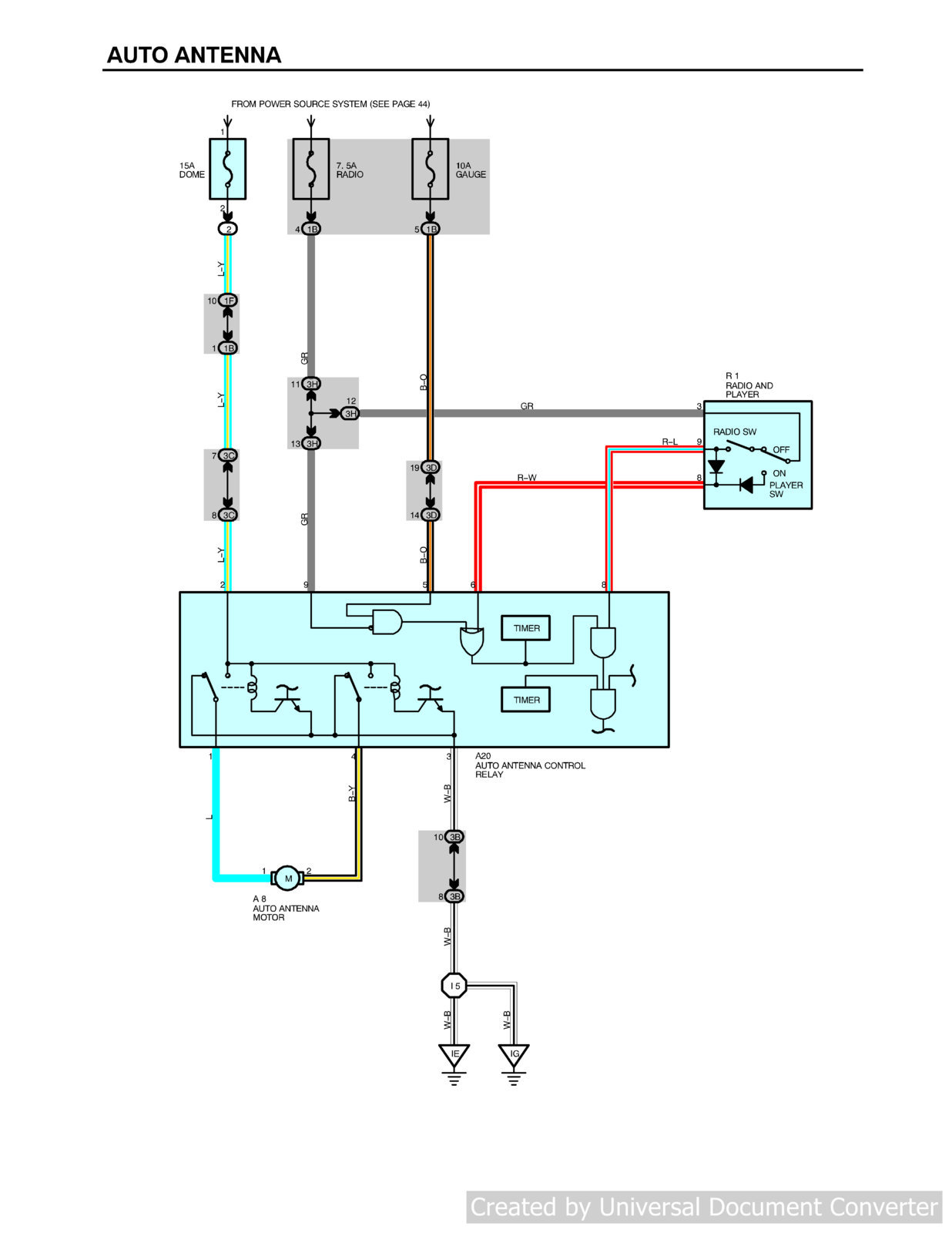

    Based on the wiring diagram for 1998, that looks like the "auto antenna relay" connector. Wire colors are slightly different (which isn't out of the ordinary for a different model year) but the connector shape and location look right.

    Looks like your correct:thumbsup:
