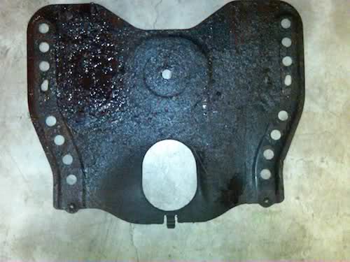

    Alright I didn't know what to search for this but, my front end has been pissing some kind of fuel, I can't tell if its tranny fluid, power steering, brake fluid, a figment of my imagination? Any help guys? Thanks.
    EDIT: The top of the picture is the tail end of the truck's skid plate.
    So the fluid is pooling on the passenger side.

    Picture doesn't work, what color is the fluid, where is it coming from, is your truck operating in any unusual ways?

    sorry I think i fixed it
    the fluid looks like someone sprayed the underside with a hose of this stuff, but its all pooling on the skid on the passenger side, i saw drips on the tranny pan and on the UCA

    Can't really tell what color it is in the pic. maybe try dipping your finger in it to see the color?

    its red and smells like tranny fluid but the pan gasket didn't seem to be leaking anywhere.

    Clean the skid plate and then look at it after that and see what color it is and what not, but i sounds like tranny fluid.

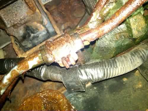

    :popcorn: Don't the trans lines run near the UCA's?

    alright its the tranny cooler lines. good call!
    I'm trying to upload a pic of where to see if theres any help.

    its leaking from the right side of the coupling. Its clearly all rusty and the paint (?) is peeling off and what not. Any quick fixes? Any issues if I don't fix it immediately?

    Looks like you're probably going to need a new fitting. I would clean everything really good and see exactly whats leaking (maybe a hole/crack in the hose?)
