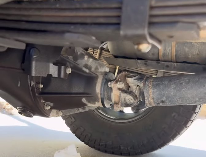

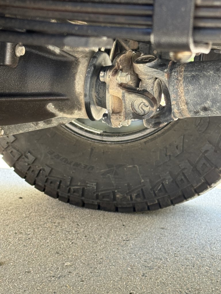

    I just looked under the truck today and i saw that the rear axle and leaf springs are covered in sometime of oil or gear oil. I don’t think that is brake fluid, all connections seem fine. Doesn’t smell or taste like gas either. No drips just like it got splatter from the tires. I’m thinking it’s either my rear shock or rear shock reservoir. Need some guidance here.

    Hard to tell but if I were to guess I’d say pinion seal because of how it’s slinging everywhere

    In your video it looks like it’s coming from the differential pinion seal.

    That’s what it looks like around the pinion seal

    Hmm, it looks dry now I’m unsure Bushop84 is actually a Toyota Tech so I’m going to let him make the call.

    How does your diff fluid level look? If that is fine, I'd almost just clean it all off and wait to see if it starts again. There's too much sprayed around to tell where or even if its coming from the truck.

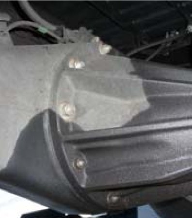

    Looks like severe leak at the diff flange where it mates with the axle housing. Your video:
    2016-2017 recall instructions filed with the NHTSA: https://static.nhtsa.gov/odi/rcl/2017/RCRIT-17V285-0775.pdf (see pg 4)

    We've seen weld seems on the axle housing leak.
    Gotta wash it, put UV dye in.

    Yea but isn't it getting way forward on the frame rails by the front of the leaf springs? Thats upwind
    It would take a lot of gear oil to cover that much real estate. If the level is anywhere near the check plug I'd say its likely not from the diff

    Video sucks for isolating the oil leak purposes...
    At 22-23 seconds you see what looks like a shock reservoir, take a look there...
    Also, dont think you show your brake backing plates, are those covered in oil???
    If you cant isolate it, you may have run something over...
    Yes, your rear diff as stated may be leaking, but that oil wouldnt travel forward if it truly is quiet a ways forward than the rear diff...
    Need a zoomed out still shot, but thats hard to do without a rack...
    Edit
    your brake backing plates look dry...
    Ide take a really good look at that shock......
    Then again, thats alot of transfer, seepage....
