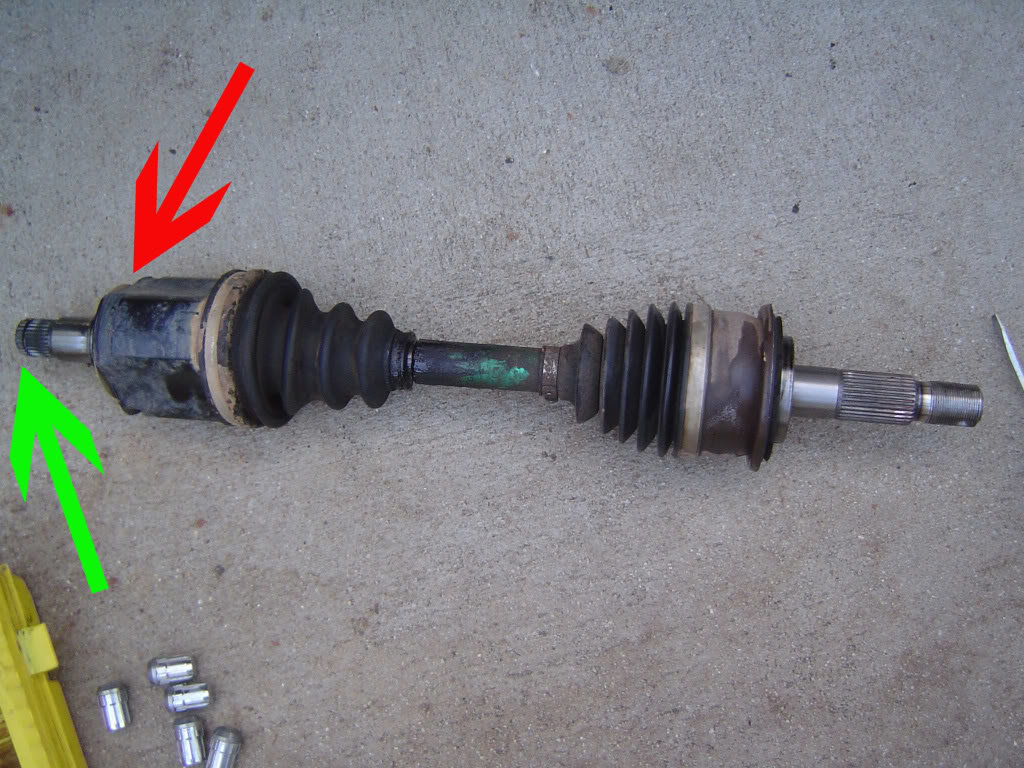

    ok so idk if this is the source of this clunk, but I was looking under the truck today and started seeing if I could get anything to move. I was wondering how much the CV axle is supposed to move? I stole this pic cuz its dark and I couldn't get a good pic, but its the part where the red arrow is:

  8. Aug 19, 2014 at 10:23 PM
    TXpro4X4
    TXpro4X4 Fuck Cancer!
    Oct 29, 2011
    #66093
    29,102
    Bryan
    Costa Mesa, CA
    2011 TOY
    As far as I know not at all. In and out that is.
    Not in a circular motion.
    They move around with your suspension. If the truck is stock It might not be that.

    truck is stock minus wheel spacers and 265/75r16 tires. When I was under the truck, I could move the drivers side axle maybe 1/4-1/2 inch around with my hand pretty easily. The passenger side was a lot tigher maybe moving 1/8 inch or less. The noise seems to only happen when I go over bumps or dips in the road

    The axle is supposed to have some play. Not a lot, I couldn't put a number on this.. maybe like a 16th back and forth? if that! there's a little snap ring type compression thing on the end of the axle that goes into the dif and that's what holds it in. It's a tight squeeze (as you know because you had it out and reinstalled it) but its not a compressed joint, there needs to be a little play.
    I don't know if that made any sense.. I have an easier time explaining things and pointing at them with hand gestures and stuff..

    No, not always. But it makes the noise pretty much anytime I start the truck. I looked at the motor mounts and they looked fine. Any specific way to tell they are broken?
    Yea I knida get wht your saying. I dont see how tht being loose is cuasing the noise. I really doesn't move too much, but I wanted to ask for sure. Truck 4 wheel drive works fine so idk :notsure:

    Check your LCA bolts. I had mine clunk simular to what your explaining. Tightened them to 110ftlbs.
    Axle is normal with that much play.
