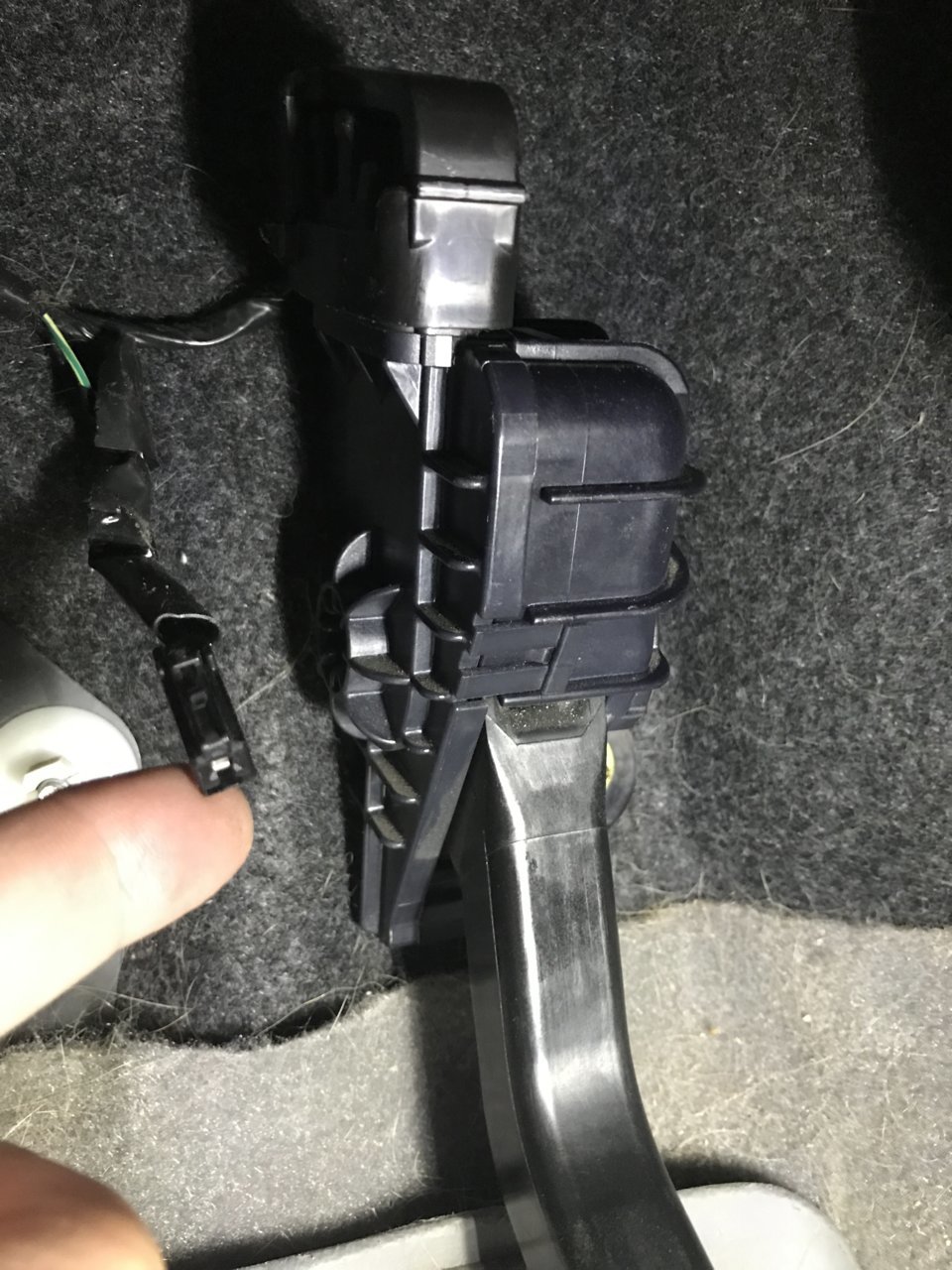

    Anyone know what this plug is for? It is near the accelerator pedal. Haven’t been able to find anything on it. Thanks

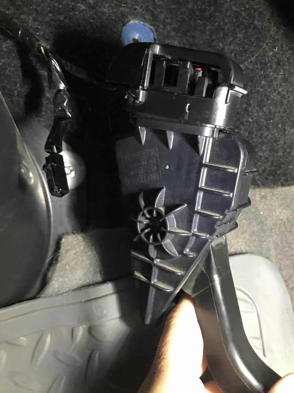

    Another pic

    Automatic or manual transmission truck?
    Green wire with white or yellow stripe?
    Looks to be for the parking brake switch.

    ahhh.....its like the other plug on the clutch pedal.....not needed, just disconnect it.
    I'm sure the Toyota engineers only added that to increase cost and their profit.
    Sidney Vicious likes this.

    Automatic Transmission.
    It’s green and yellow. It won’t reach anything. Wondering how I didn’t notice it before.

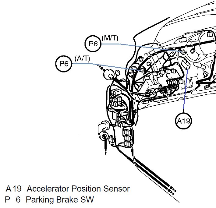

    You can see the green/yellow wire here for the brake switch. Maybe it's for the parking brake in the manual transmission cars (those have a handle above the gas pedal).
    Maybe ground the wire and see if your emergency brake indicator lights up?

    That Manual Transmission connection is it! Thank you!

    That complete dash harness is meant for compatibility between both the auto and stick shift trucks. Even the ECM plugs are the same. That wire is for the parking brake when you have the M/T.
