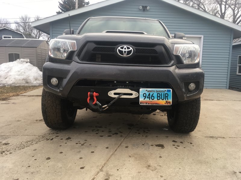

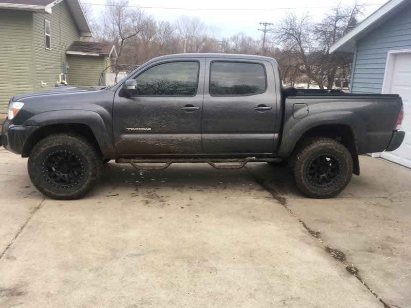

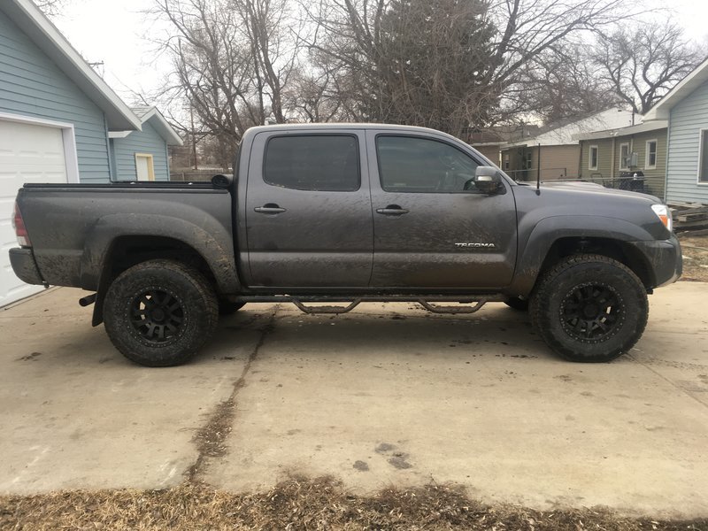

    Hey everyone, my truck sits much lower in the front. I'm wondering if there is a common fix for it. Ground to fender in the back is about 39.5" on both sides. Front passenger is about 37.5" and front driver is about 37". The truck has a 3 inch toytec lift that is about 3 years old and a us off road hidden winch mount with a Smitty built wiench and synthetic rope. The coilovers are not adjustable.

    Your heavy up front. Get adjustable coilovers or put 150 pounds in the bed of the truck.

    I was hoping there would be a spacer that will work with my lift as a temp fix until I can afford new coil overs.

    I like that stance better than the rear low front high...

    I'd say you're front heavy with the bumper and winch but could be wrong. Also if the 3" lift is a 3 in the rear its probably in reality a 2.5 in the front.

    Nooooo never jumped it. If I remember correctly the bumper and winch dropped it a half inch.

    I think I'll just have to save up for new coilovers.

    Sounds like you answered your own question.
    Get coil overs that can have preload adjusted.
