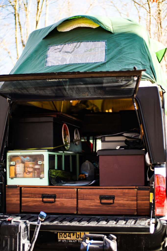

    Installation of the powerbastards high output 220amp alternator, upgraded wiring kit, and bluetti charger1! Won't be needing my solar panels anymore!!
    patient the pine-3.jpg patient the pine-39.jpg patient the pine-36.jpg patient the pine-38.jpg patient the pine-27.jpg

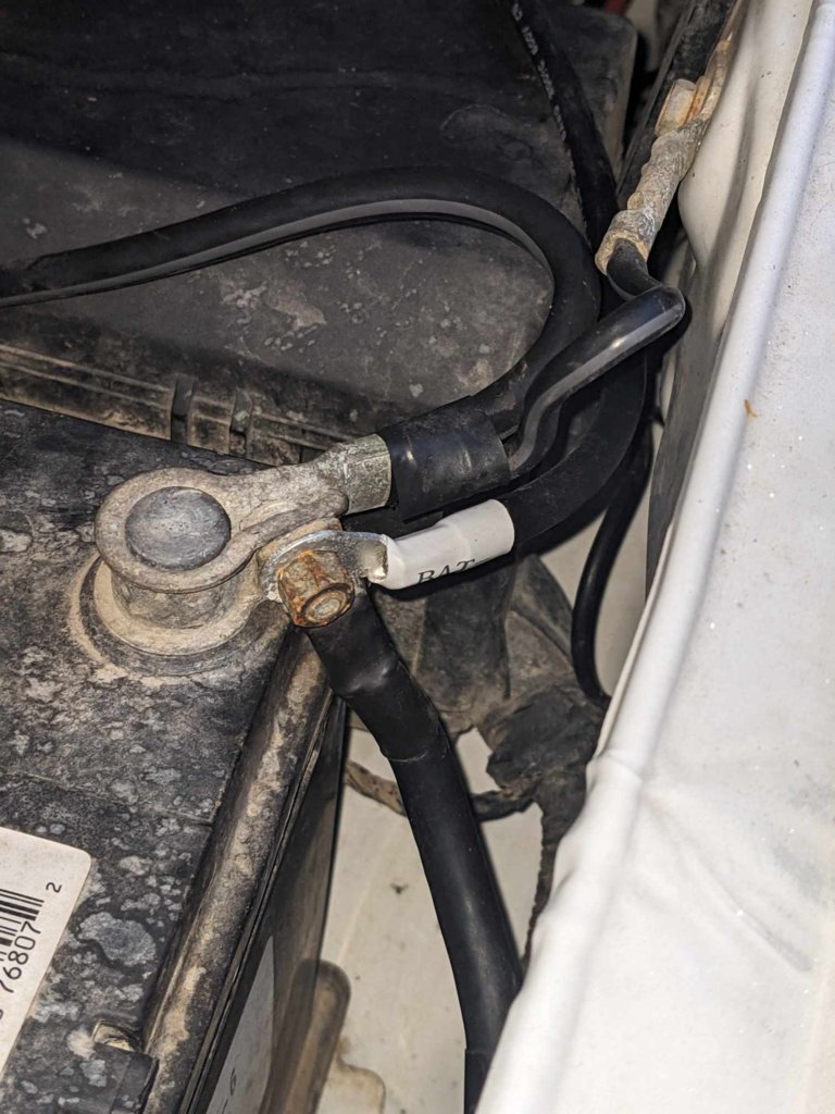

    Thanks for the vid. Could you share where you attached the negative wire of the Charger 1 to the battery? My negative battery terminal doesn’t have a spot to add on accessories
  18. Feb 2, 2025 at 2:08 PM
    #18
    timelesstaco
    timelesstaco [OP] Well-Known Member
    Feb 7, 2016
    #177424
    349
    Dan
    2013 toyota tacoma. Regular cab manual. 1985 toyota 4runner s45
    3" toytec big boss suspension lift. toytec 1" bodylift. 33" nitto trail grapplers. 16 inch raceline raptors. sterling equipment double single roll bar.
    Here's a picture!
    sheld[QUOTED] likes this.
