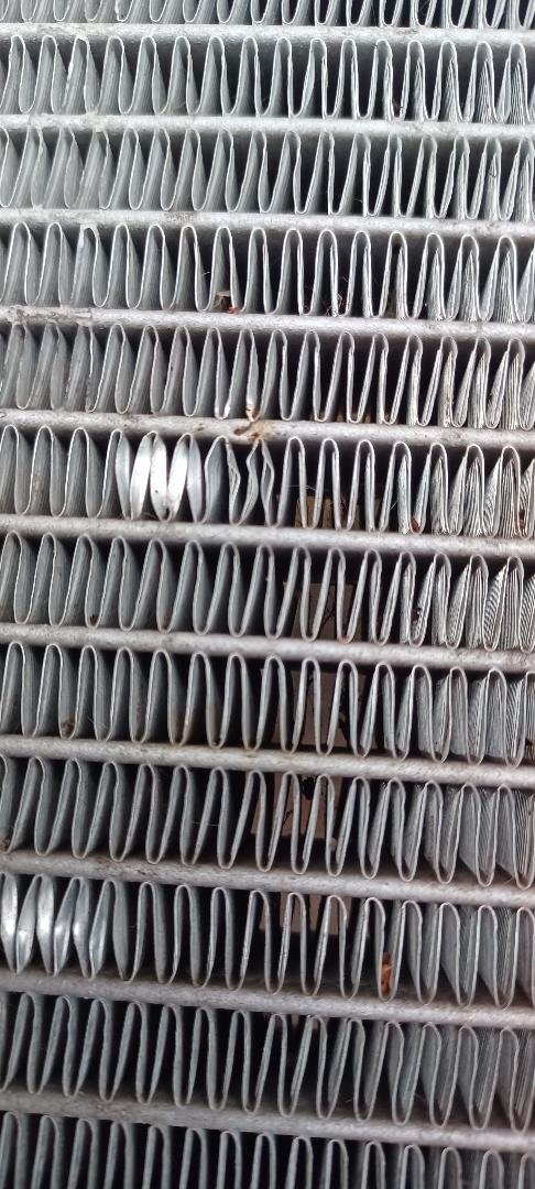

    My 15 TRD with 82K started to steam and drip coolant the other day. I could not tell exactly where the leak was located, but I knew it was somewhere in the radiator. I just swapped it with a Danso. Before I disconnected the big hoses, I topped the old one off to find the leak. I assumed the seal along the tank, but no. It is a small perforation in a tube with pressed in edges, so from a projectile, that did not even bend the fins next to it. Here is the odd part, the hole was on the engine side of the radiator. WTH? Could a sharp rock have gotten past the skid plate, hit the fan, and been launched into the tube, but not touch the fins? My only other theory involves an ex-girlfriend, armed with a sharp needle and a grudge. Any idea how this could have happened?

    Your original radiator failed?
    or new one leaked 3 days after install?
    I mean there’s holes for stuff to get into the front engine area. In theory if a Little Rock goes there it could get thrown by the drive belt system or fan. But I’ve never actually seen that happen.
    with upgraded/more coverage fender liners (the ones that clip on by the exhaust manifolds) and skid plates there’s less room for things to get in.
    unless it’s a fluke part
    Only time I’ve seen this happen was on a low performance sedan with giant exposed cooler in the lower grill that hit a rock.

    Yes, the original got the hole. I am just baffled as to how it could have happened. There was no work done under the hood for a couple of years, so an errant tool can't be the culprit. If it was on the front and outside of the A/C evaporator, I could see it, but inside the fan shroud?

    Did you drop the fan clutch on it trying to remove it for other work?
    No, I had not done anything under the hood other than spin on an oil filter and add oil for over a year. Nothing remotely close to the radiator. With the shroud and the fan, you'd really have to try to poke something into it in the location of the leak.

    unlucky - likely some small object was launched by the fan...... unless you damaged the fins, can see the witness marks above and below the tube
    I work in the engine cooling industry and it "happens" enough that some manufacturers of vocational trucks screen both sides of the cooling module to reduce incidental damage
