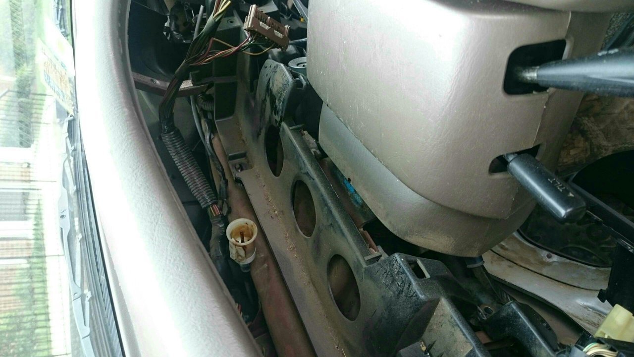

    There's no room to reach under there though. I ended up trying to take the entire dash off and this is what it's like now. 0b93f2f356a1ff56ec408c07cfafdee5_ed76cf8af5ea2298bb9792b681781c3a5f77178b.jpg
    I'm about to pop the dash off

    unhook the end on the transmission/transfer push a little slack forward until you have enough to reinstall the dash, then rehook the transmission/transfer back up. Done it this way many times.

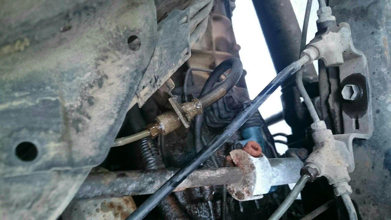

    Is this it? b415da56adc3200f4d4e2e4974aca5c8_01dfe7d891dcb83545808c7879ba989229e15904.jpg

    All I see is brake lines...should be on the transfercase

    follow the cable to the firewall then see where it is located, then go under hood and spot the cable as it goes through firewall, follow cable down to tranny then disconnect it

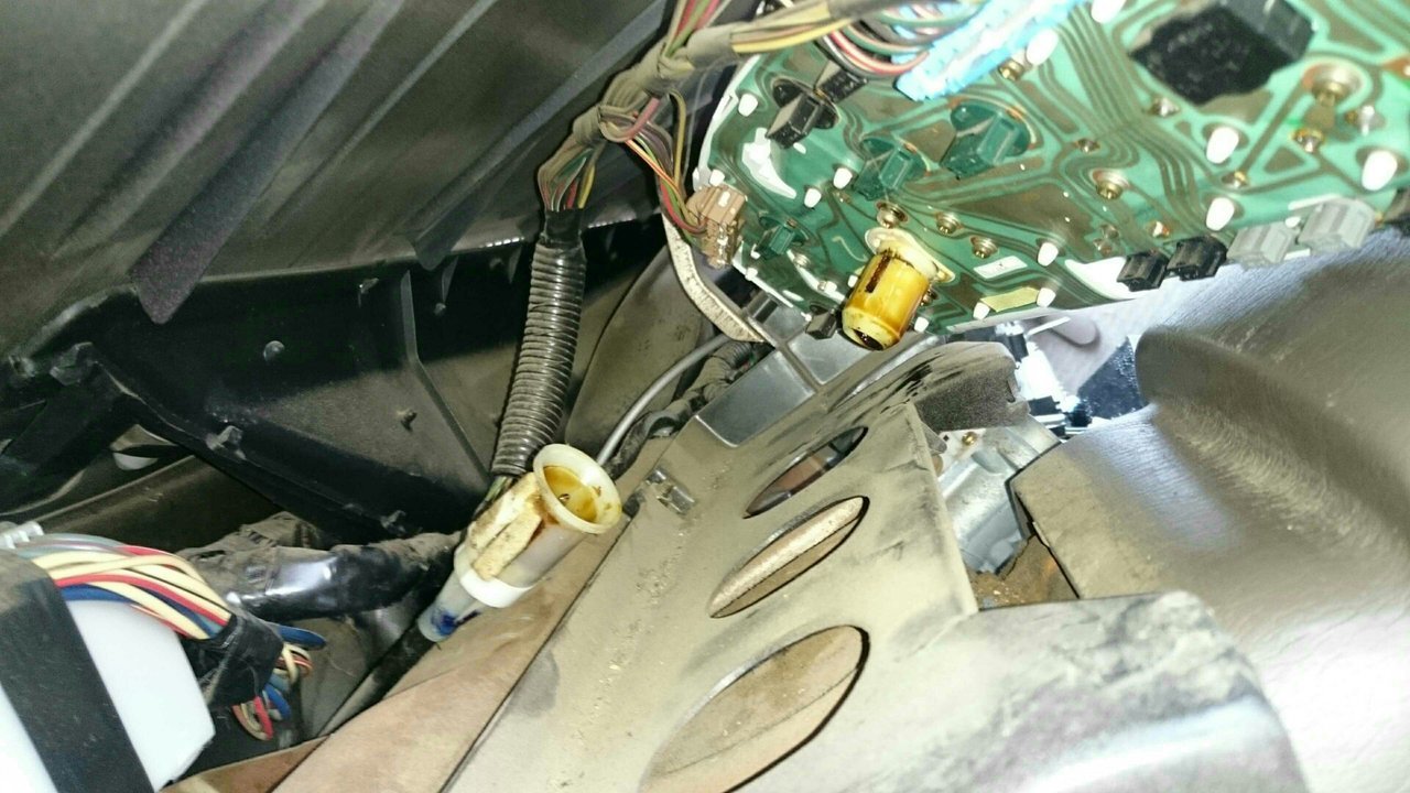

    After nearly disconnecting my brake line and dying in a glorious ball of fire I found the speedo line and reconnected it to the dash. Thanks for the help guys. Couldn't have done it without you

    remove the venting just above radio (not the part that directs the air but the 90 degree pipe behind it) and you can reach in and plug it in.
