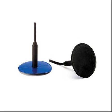

    The general consensus safety rule is that is it’s less than an inch from the side wall you toss the tire, so you need to be an inch or more towards the center of tire.
    The plug & patch repair plug is the best if you decide to repair as it is both a plug & patch, I’ve used them for years with great results, no complaints or failures.
    However, if I was in your shoes I’d buy two new tires of the exact same brand & size and use the plug & patched one as spare if the spare is not of the same size and brand as the four on the truck. I would put the new ones on the rear and the rear in front.
    The reason for buying two is because as the tires wear, they wear more or less evenly on the axles and a new tire maybe bigger/taller than the used ones and may give you stability issues and/ or a pull to one side if it’s the front if the size from wear difference is too great.
    Best of luck to you with whatever you decide to do
    Cheers!

    tire shops will usually do an internal repair. Its a much bigger patch and makes the tire as good as new.
    Those plug things are more temporary.
    I have seen them hold up a while but they are not permanent.
    Great kit to have though on the trail.
