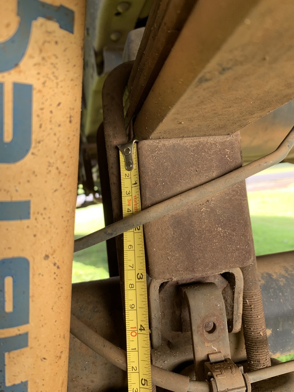

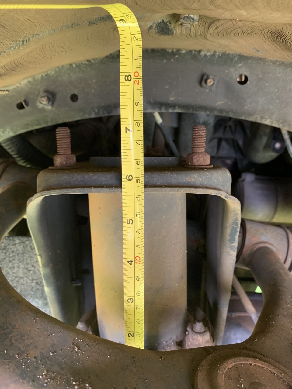

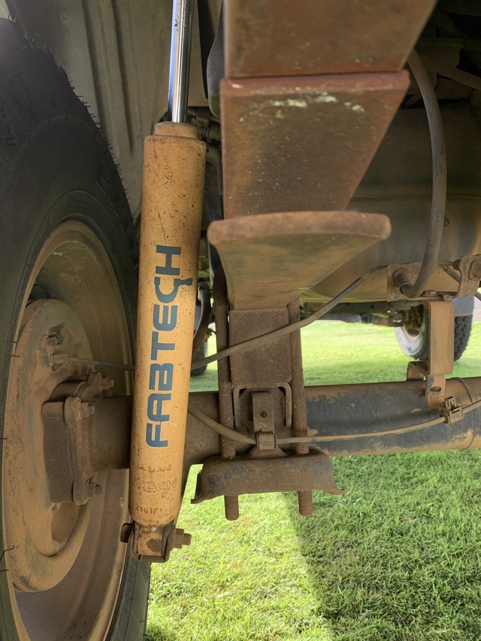

    I have a 2009 Tacoma regular cab 4wd, with a fabtech lift kit. The previous owner said it has a 6 inch lift, but my coworker said it looks more like a leveling kit. Currently I’m running 285/70/17 mud terrains, with a slight rub on the plastic trim for the front mud guards. I need to know how exactly do I figure out what size lift I have on this truck. Sorry if this should go in the suspension thread, if it does, can one of the mods move it for me.

    Holy shit that is horrible. Its a 6 inch spacer in the front with a 3 inch block in the rear. Take that out completely for the love of all that is good

    He can’t. It’s a DB lift kit. They would have cut the frame to drop the front diff to its new location. He’ll need a donor frame section.

    It’s a 6” DB kit. The rear is a 3” block and 2” aal to have the truck sit level.

    FYI. Fabtech only made 2 kits for that truck. A 3” and a 6”. You have the 6” basic kit.
