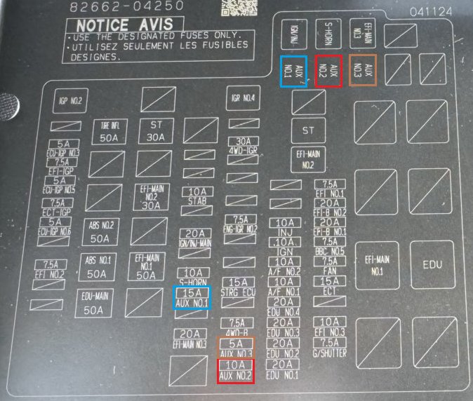

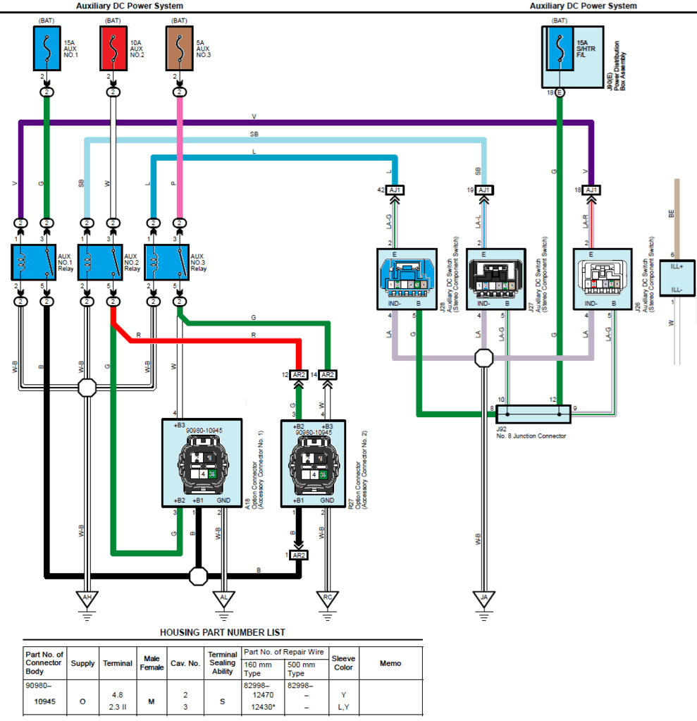

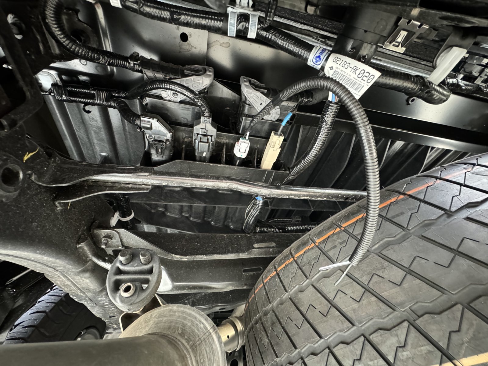

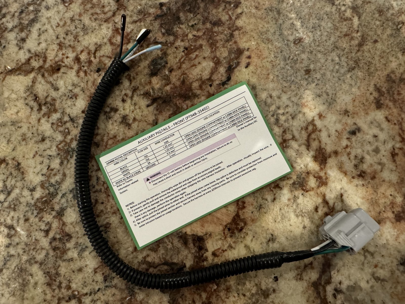

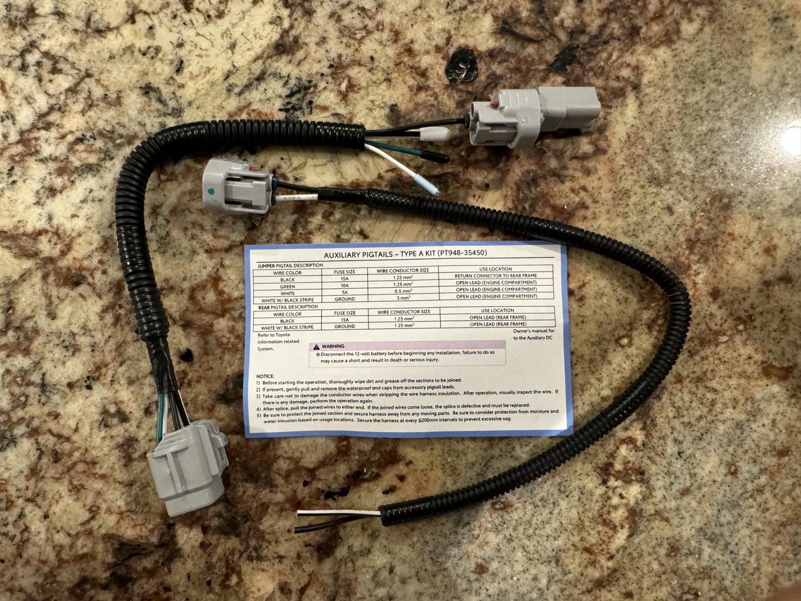

    So I opened my virgin packages just for you guys. Here is what I found - this is likely in the manual, but who reads that anyway?
    AUX 1 = BLACK wire (15A)
    AUX 2 = GREEN wire (10A)
    AUX 3 = WHITE wire (5A)
    AUX ENGINE LINK must be in place to pass BLACK wire power to AUX REAR
    AUX REAR with pigtail, BLACK wire (15A) confirmed 12V
    AUX ENGINE and AUX REAR in same package
    AUX CAB in other package

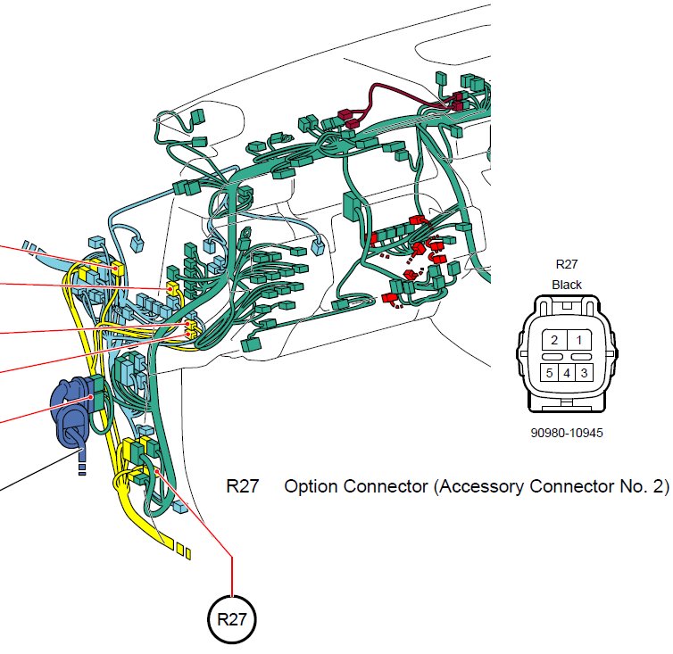

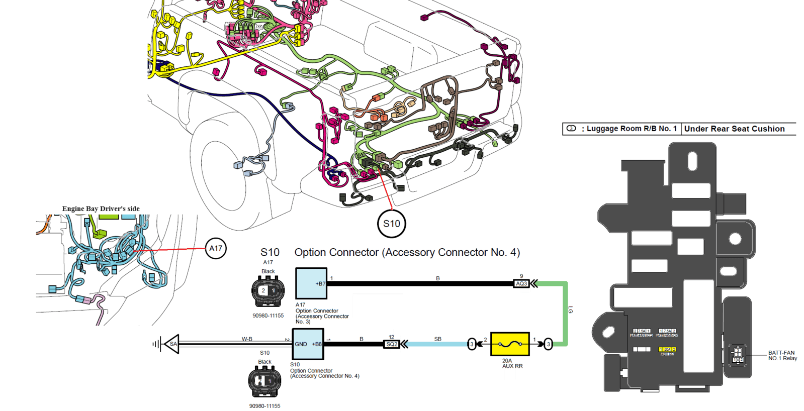

    So shared ground for 3 circuits on 35402.
    What pigtail fits the cab (B) location?

    Shared ground across all AUX circuits

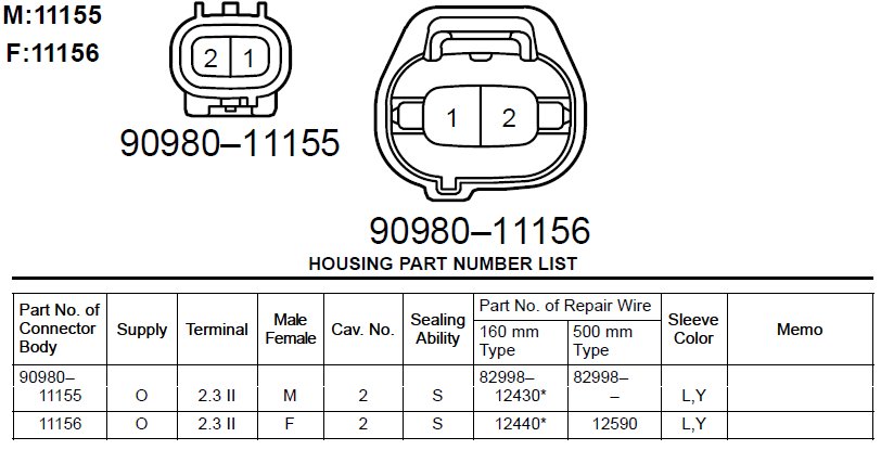

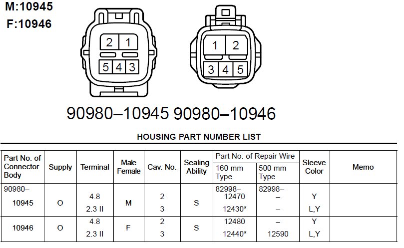

    The 4-pin in the package by itself is for CAB (35402), same connector type as the 4-pin AUX ENGINE connector in 35450
    2-pin pigtail connector is PN 11156
    4-pin pigtail connector is PN 10946
    Can’t access installed connector PN due to install orientation

    You think it's a shared circuit? (as in same for cab & engine room)

    All same colored wires are on the same circuit (ie the BLACK wires in all compartments are same circuit)
    BLACK wire goes to ENGINE / CAB / REAR has 15A fuse
    GREEN wire goes to ENGINE / CAB has 10A fuse
    WHITE wire goes to ENGINE / CAB has 5A fuse
    Would have appreciated two 10A circuits and do away with the 5A, but I assume the limitation has to be more complex than simply adding larger gauge wire. Right? Right???

    If you have DMM, you could confirm that both locations share same source.

    I did, they do

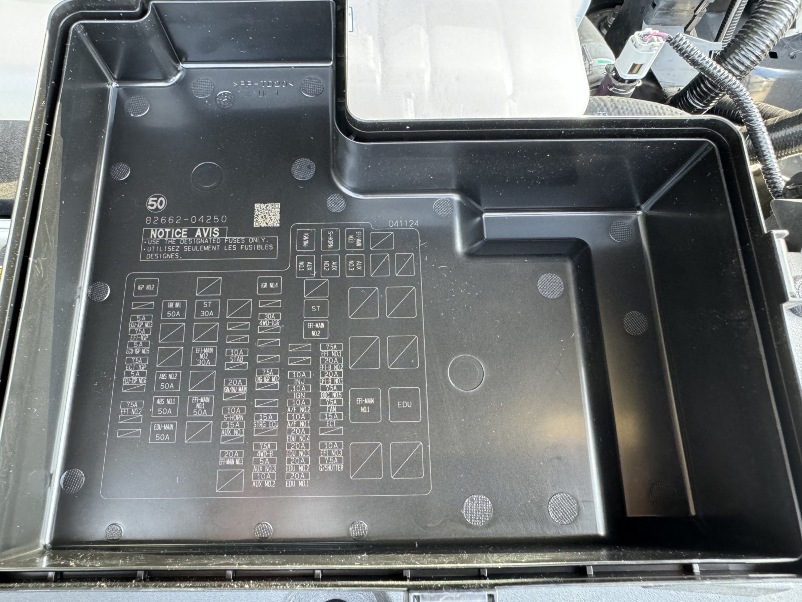

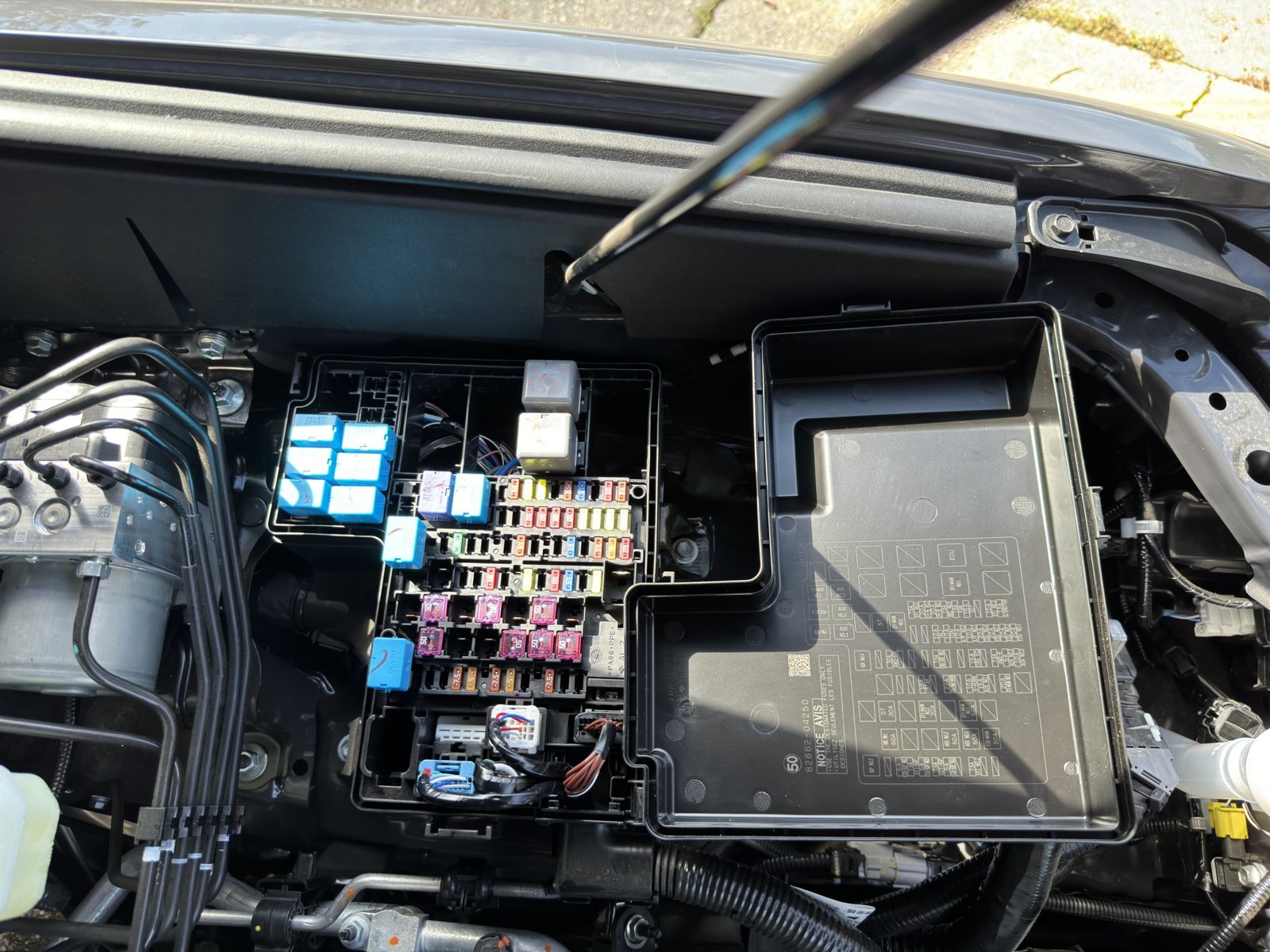

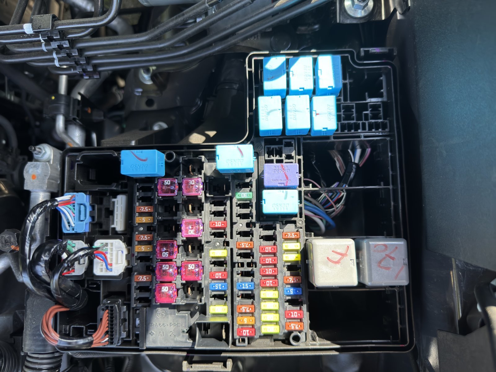

    AUX fuses and relays next to hood prop, as requested
    More photos added as it seems the forum is compressing them even when using FULL

  11. Jul 28, 2024 at 5:48 PM
    #31
    caribe makaira
    caribe makaira Well-Known Member
    Feb 13, 2011
    #51121
    11,813
    Caribbean, Puerto Rico
    05 PreRunner TRD Offroad AutoTrans
    Hood Struts, My version Fogs always ON, Map & Overhead Light Mod,

    All unused connectors come with a removable plug installed. Temporarily installed a pigtail to test circuit.

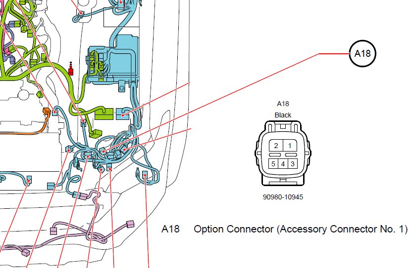

    Would you happen to have the connector part numbers used in these kits?

    :smack:Look above...:burp:
    FYI:
    10945 is on the Taco harness
    10946 is the pigtail connector

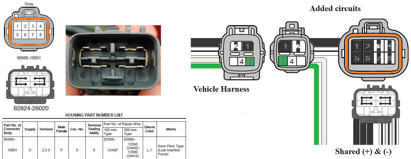

    You could crimp 2 smaller gauge wires with the large gauge one for the shared ground, instead of using butt connectors like some:puke: in YT have, for neater assembly.
    Or purchase parts and assemble this:
    Don't exceed the fused amps per circuit for the items attached. Or use the feeds as signals to additional relays.
    @Puppypunter, @daveeasa, @kmorgan3, @memario1214
