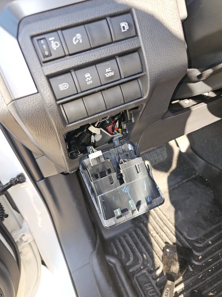

    I pulled the panel, there is no wires and no switches. Just blank covers. 20240922_175443.jpg 20240922_175427.jpg

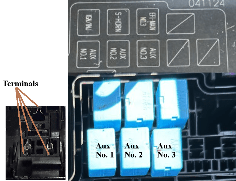

    See if you have the terminals for the missing relays:
    It would clear up the doubt that searching for the connectors in the cab is unfruitful.

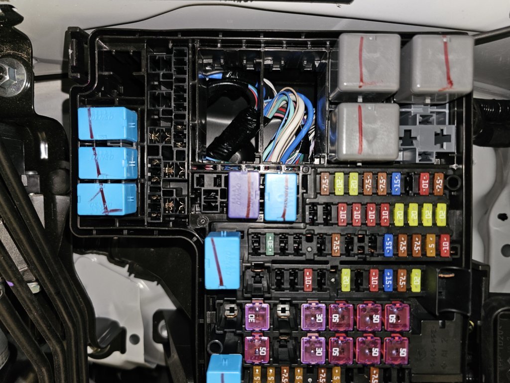

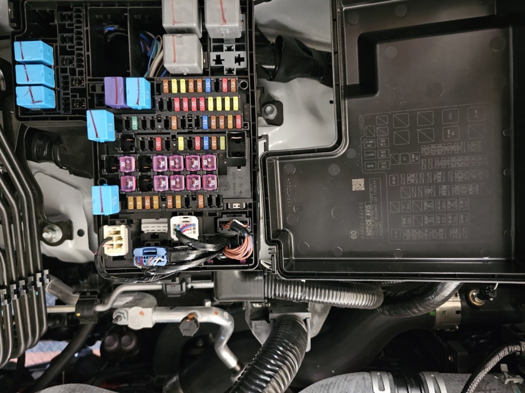

    So i looked in the fuse box and I took a picture of it because i don't see relays
  9. Sep 23, 2024 at 7:57 AM
    #49
    caribe makaira
    caribe makaira Well-Known Member
    Feb 13, 2011
    #51121
    11,813
    Caribbean, Puerto Rico
    05 PreRunner TRD Offroad AutoTrans
    Hood Struts, My version Fogs always ON, Map & Overhead Light Mod,
    You are in luck:
    The relay terminals are there. So continue with search inside dash for the connectors. They usually are along side dash harness taped down.

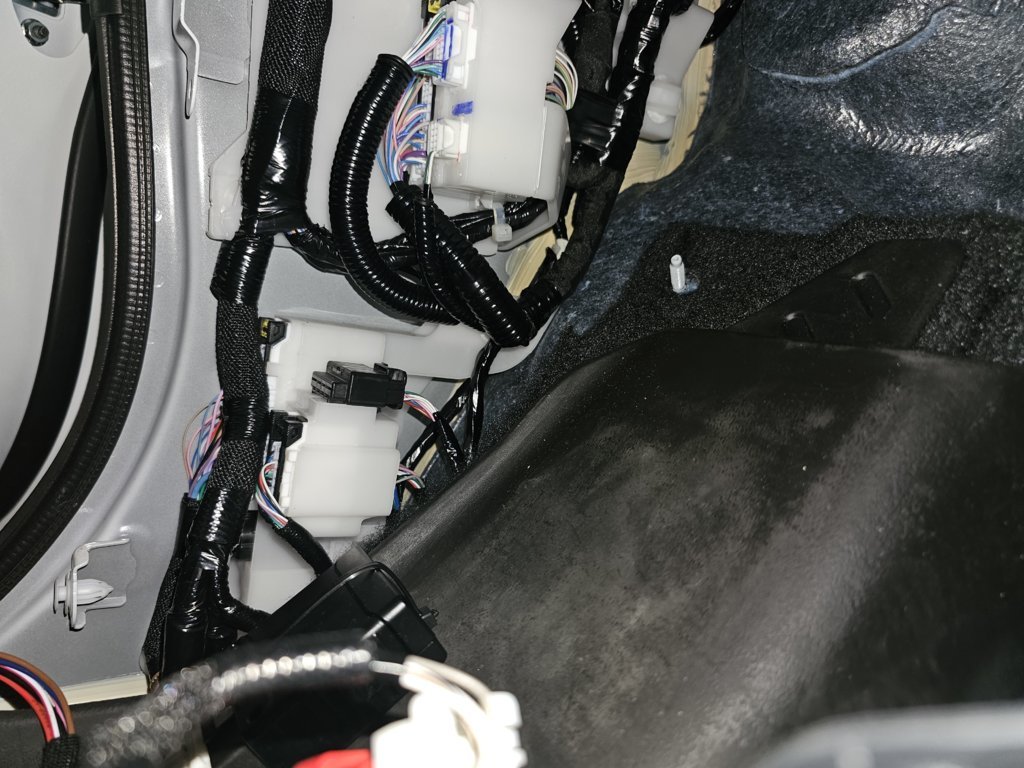

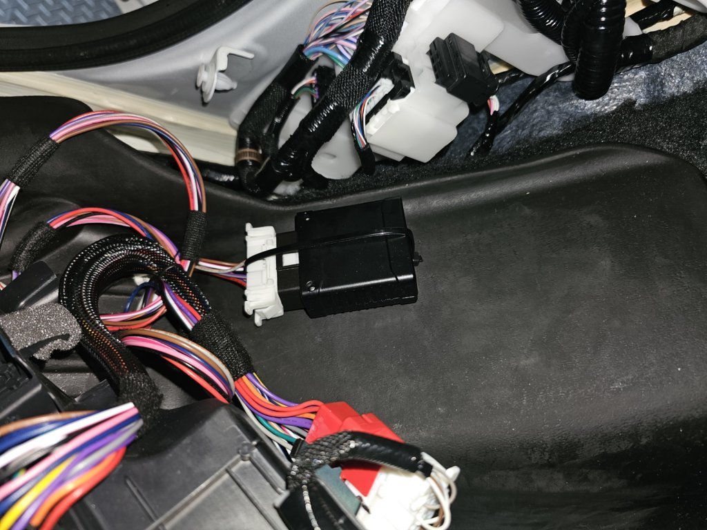

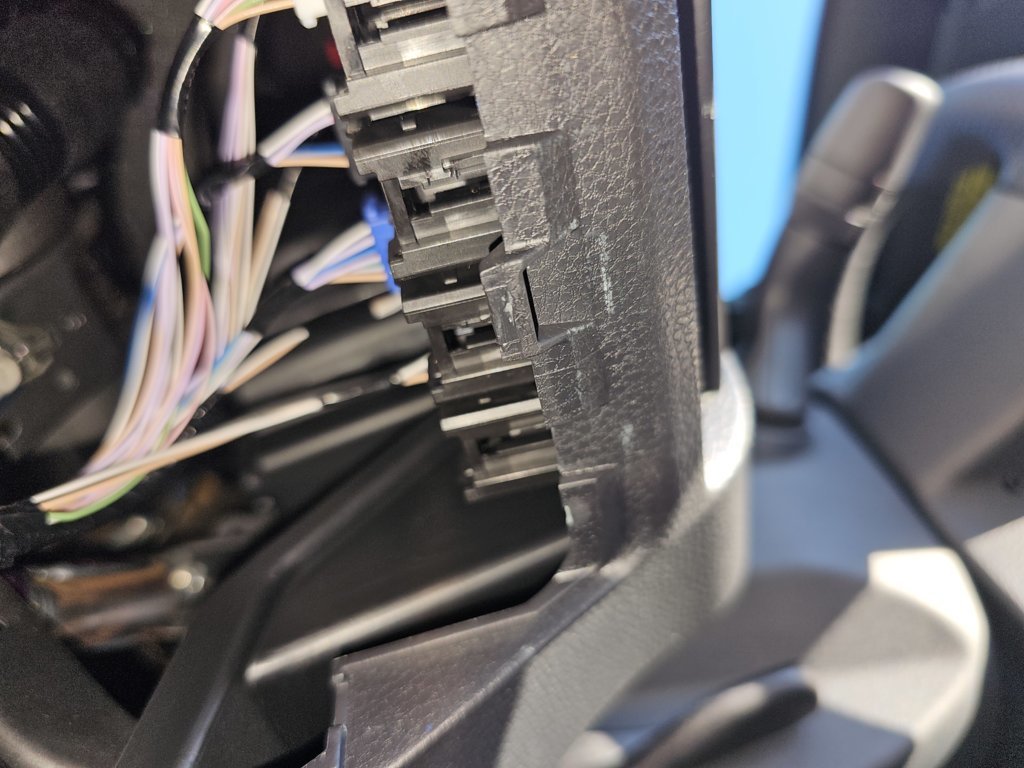

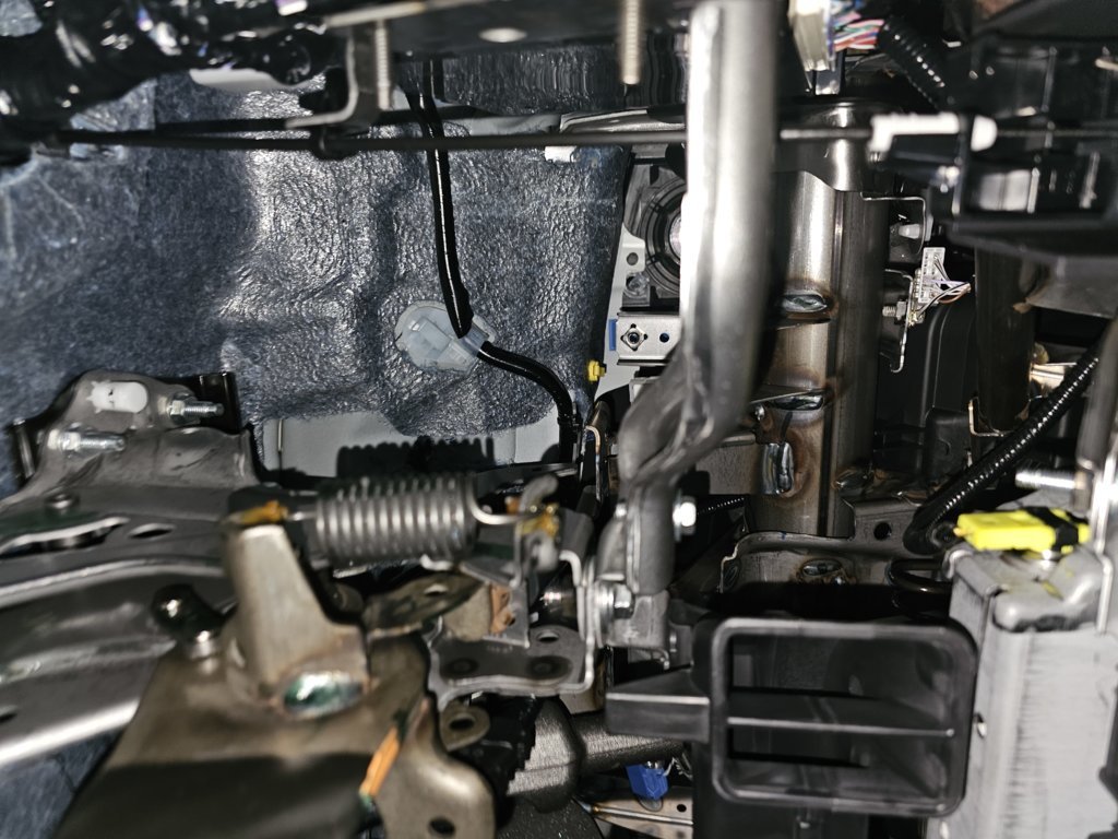

    I removed thal panel and looked. I also removed the lower panel by obd plug, I didn't see anything. I took a few photos also, let me know if you see something. 20240923_102901.jpg 20240923_102853.jpg 20240923_102847.jpg 20240923_102831.jpg
  16. Sep 23, 2024 at 8:43 AM
    #56
    caribe makaira
    Feb 13, 2011
    #51121
    11,813

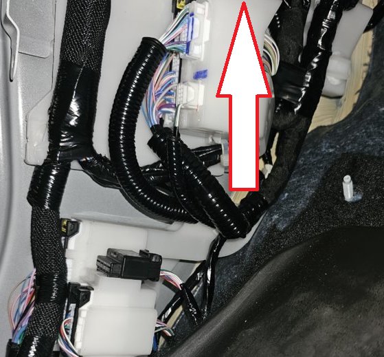

    Look to harness above and close to door side

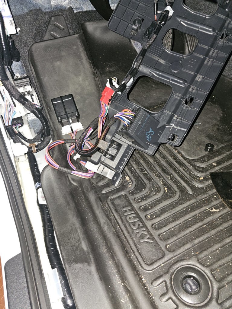

  17. Sep 23, 2024 at 8:47 AM
    #57
    caribe makaira
    Feb 13, 2011
    #51121
    11,813

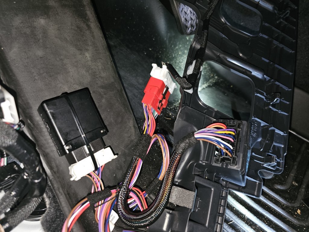

  18. Sep 23, 2024 at 8:50 AM
    #58
    Xperivent
    Xperivent Well-Known Member
    Sep 13, 2015
    #164147
    517
    ‘24 Supersonic ORP & '04 Impulse Red DC OR
    It’s a very suspicious black box.
    theres also a black line of connectors clipped onto a white box that also might not be connected to anything
  19. Sep 23, 2024 at 9:02 AM
    #59
    Poot Klopp
    Poot Klopp Well-Known Member
    Apr 10, 2010
    #34986
    908
    Ben
    New Jersey
    2024 Bronze Oxide TRD OR

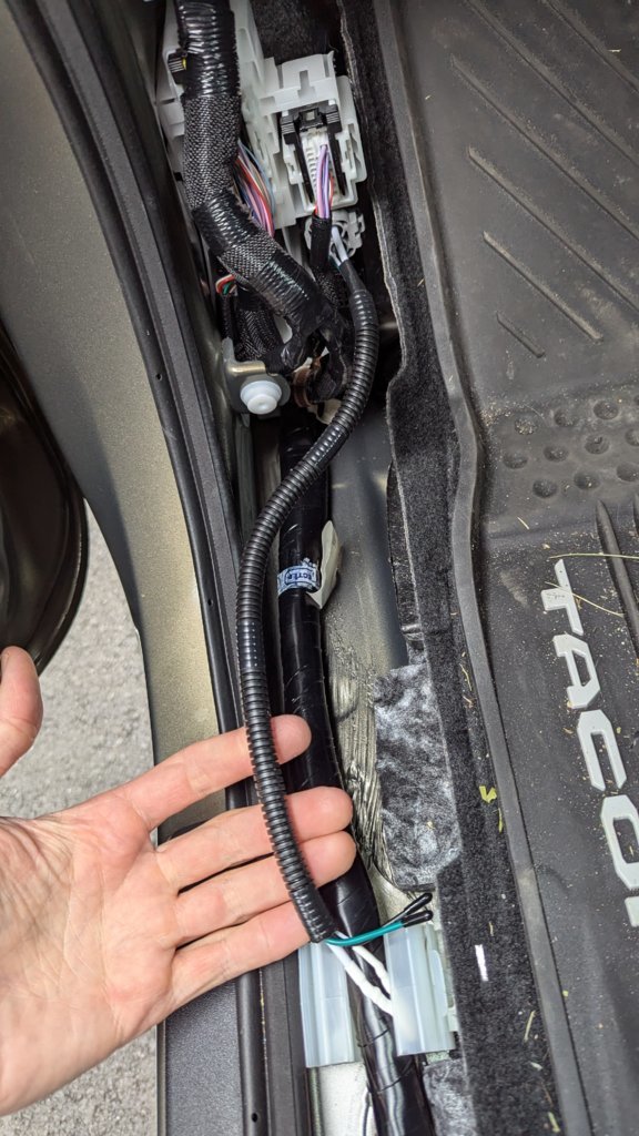

    This is my terminal with a pigtail plugged in.
    bctaco21 likes this.

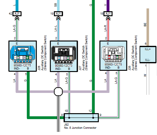

    @Poot Klopp, you got a pic of the aux connectors going to the panel?
    @Wahhabm, I see that your Taco is also missing the aux output the Poot Klopp is showing...
