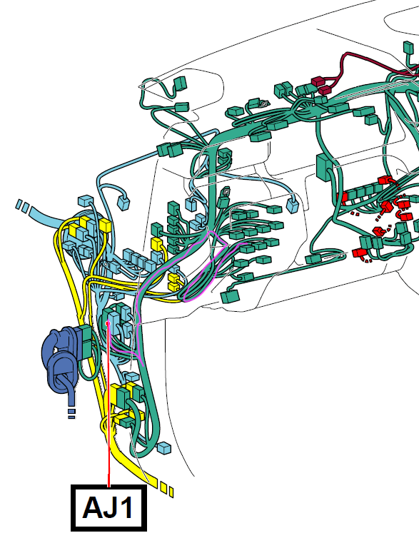

  16. Oct 5, 2024 at 7:54 AM
    #96
    williamBcooper
    williamBcooper Well-Known Member
    Jul 27, 2024
    #454045
    80

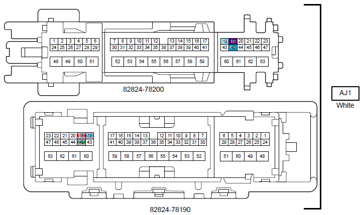

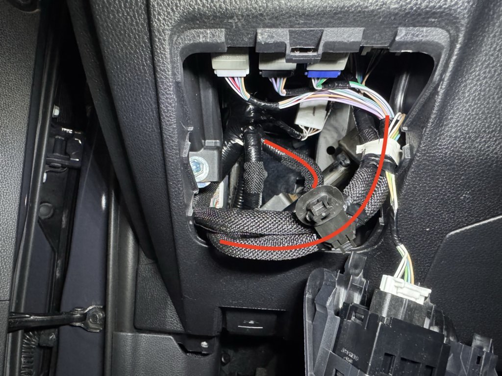

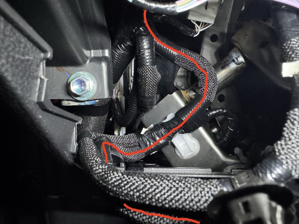

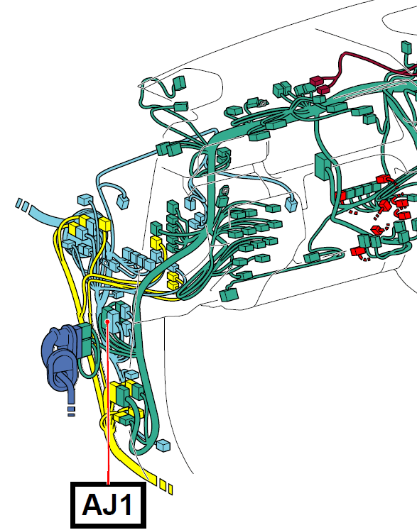

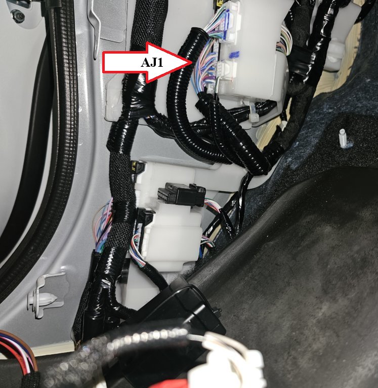

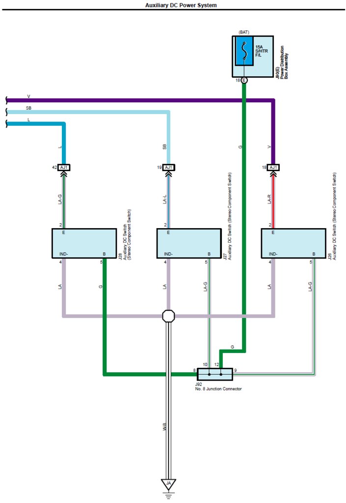

    2024 Taco TRD OR
    Hard to tell with these diagrams. Is AJ1 the other end of that harness? It is behind the driver door lower kick panel?
    Would follow the purple line like this?

    Info is meant for @Wahhabm...
    AJ1 is a mating connector. One side is held in by a connector block. The other is the harness to it.
    Yes
