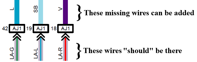

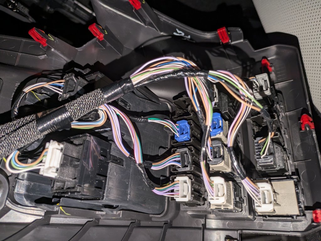

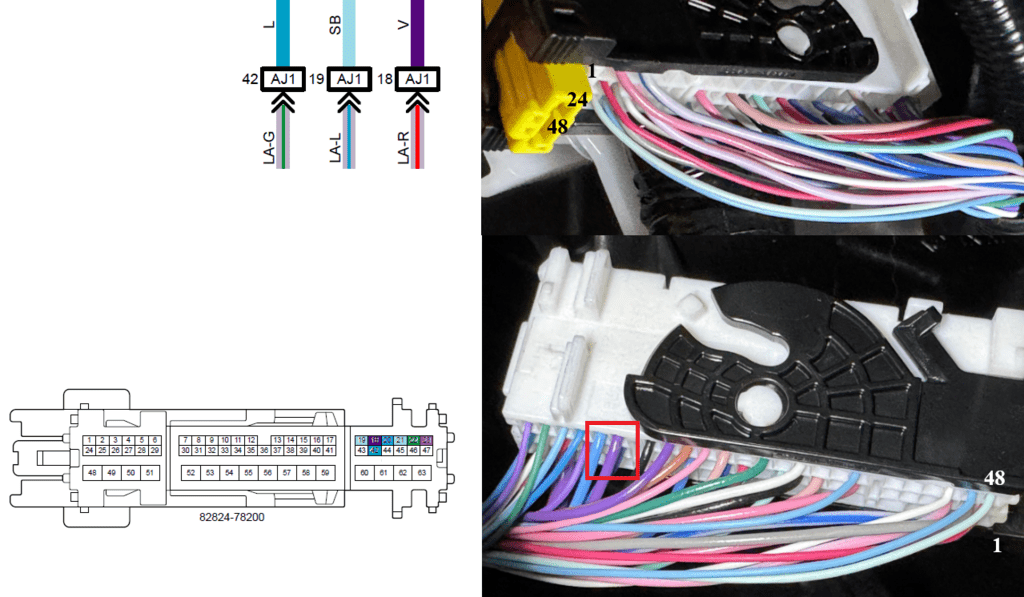

    @Wahhabm, Check AJ1 again. See if your Taco has these wires:
    Blue_42; Sky Blue_19; Violet_18.
    They are the wires coming from the engine bay fuse/relay box (driver's side).

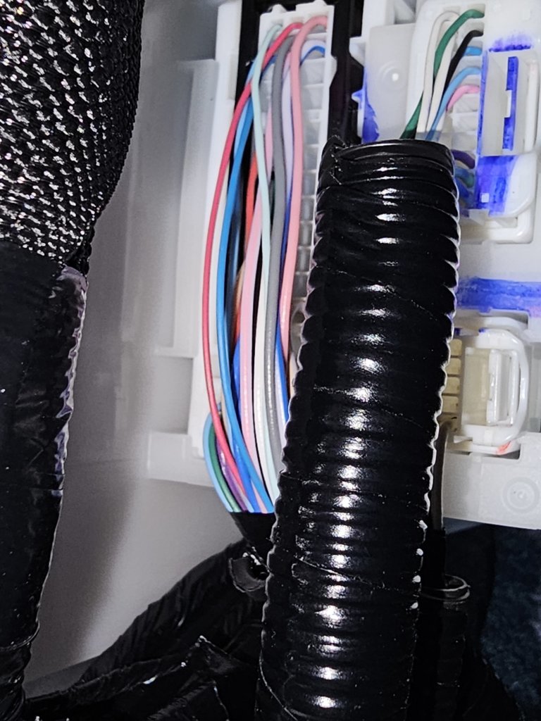

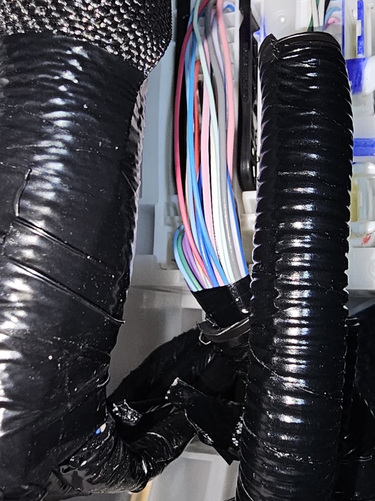

    I don't think so. I took a couple of photos. It Looks like a different wire even on 1. I wonder it i am looking at the right connector. Do you think because i am a hybrid version it is in a differentlocation?20241007_115946.jpg 20241007_120054.jpg

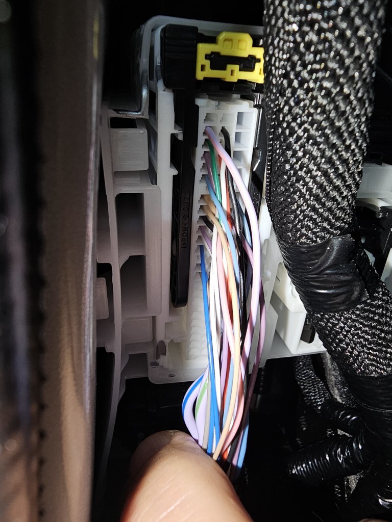

    20241007_124518.jpg I think that was the wrong plug. The one you are asking for is above but it is so heard to take a picture. This is the best I was able to do as I don't know how to remove it and I am not sure I want to remove that plug or the plastic peace that holds the plug 20241007_124501.jpg

    The first one is correct, not this one.
    Stevie17 likes this.

    Then I don't have it for sure

    @Wahhabm

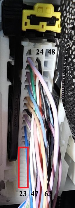

    Red rectangle is area where wires should be.
    Not that they can't be added.
    You would need to confirm that the wires from the relays are there.
    They would be on opposite side of the connector (mate) towards the firewall.

    Fuse share to switches, then to actuate relays.
    But I see that if Taco version has no heated seats, maybe there is no wire from fuse to J92. But that can be added.

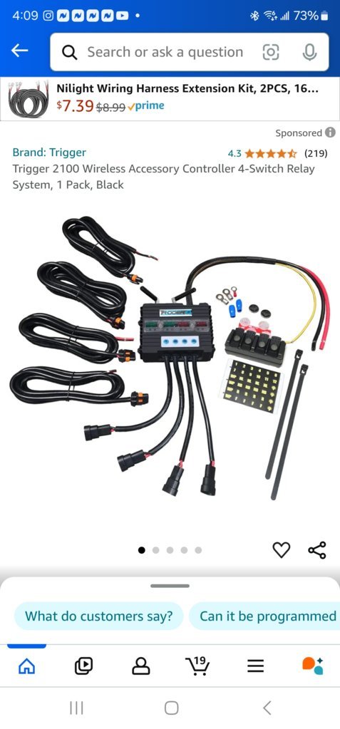

    I accidentally found this wireless controller for accessories that could be a solution for anyone who didn't get the aux switches in their package. I didn't know things like that existed. I have a hybrid tacoma and my battery is under the rear seat on driver side. If I were to get something like that, what would be the path to get the wires to the controller from the back of the truck. I assume this controller would have live/be mounted next to the battery.
    Trigger 2100 Wireless Accessory Controller 4-Switch Relay System, 1 Pack, Black https://www.amazon.com/dp/B07HG9ZTLF

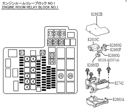

    Are you able to determine a part number for that AUX relay bank?

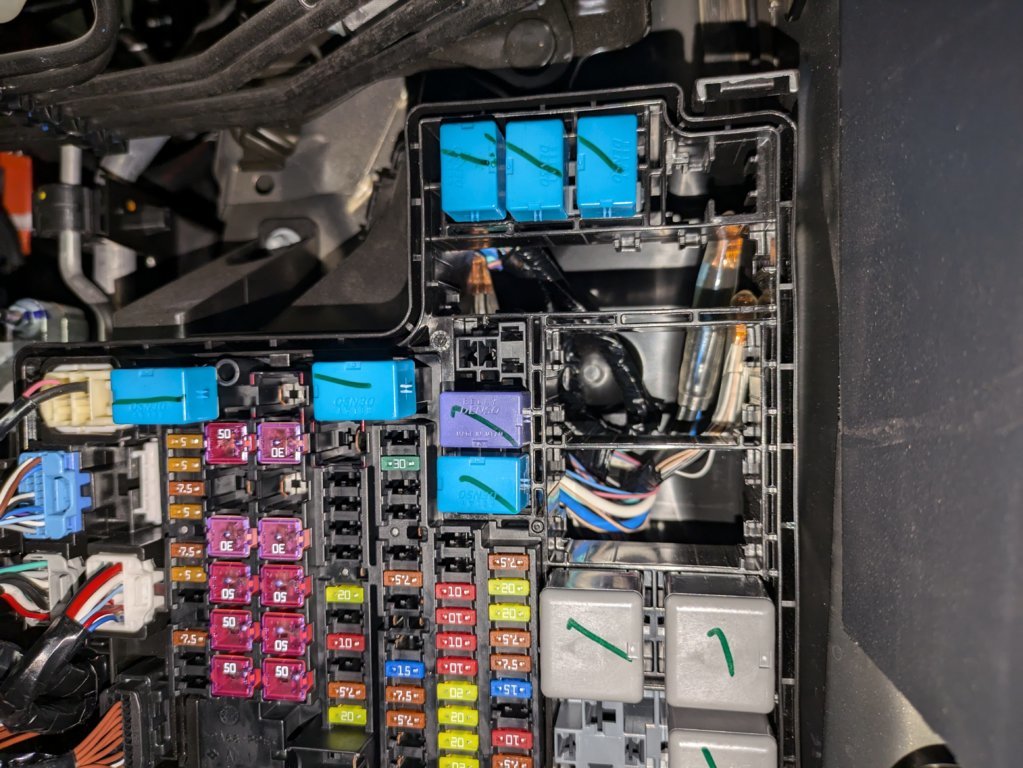

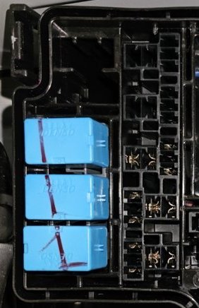

    I'm slowing working out a plan on my hybrid, because it shipped without the full aux wiring package (even though Toyota listed it as standard at time of order)... I've determined that I have wires running to the dummy blanks on my driver side panel, but no pigtail connection points and my engine side fuse & relay box is missing that AUX bank. So I'm suspecting that the harness running from that fuse box to the driver's cab is intact, but that it's a separate relay insert and separate wiring hardness that would branch out from said engine relay to complete the wiring. Anything you can dig up?
    I'm toying with pulling apart the fuse/relay box to see what wires might be dead-ending underneath.

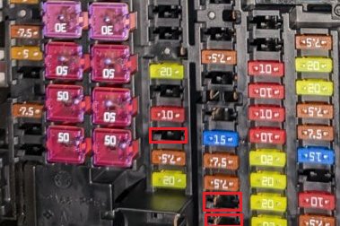

    Remember to remove the negative cable of battery and wait a few minutes. Other than that you won't break anything. Document (pics) it.:burp:
    The issue I see is the harness from the relays would be missing, unless they are also bundled inside the fuse/relay box.
    Have you checked that your Taco has the connectors A16 & A17? (pigtail location)
    I see the Taco is also missing the fuses to the relays:
    Check that the spots have the fuse holder tap on the right side (fender side) of fuse slot.

    Even with the expanded diagram, i was not able to successfully identify the sub-part. my best guess on your initial post looks like it's just different relays themselves, rather than the underlying seating/holding frame.

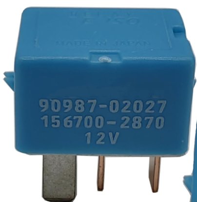

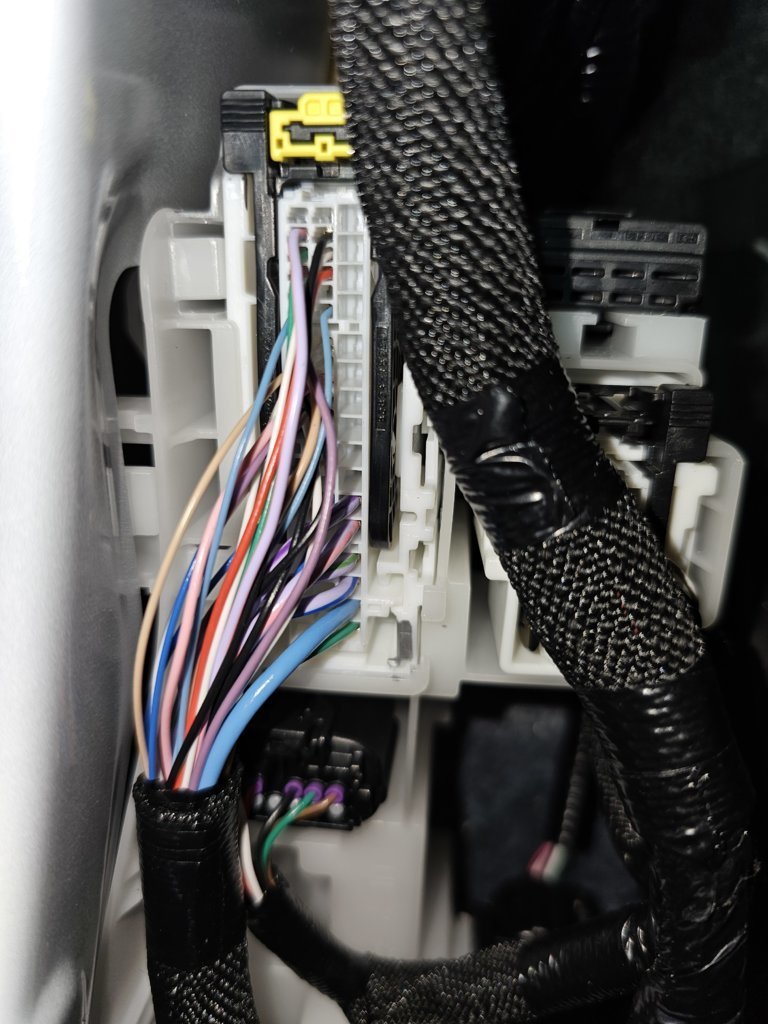

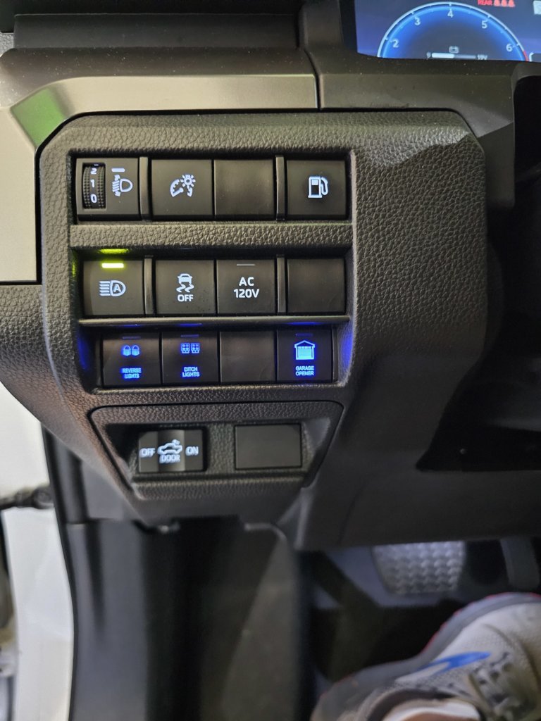

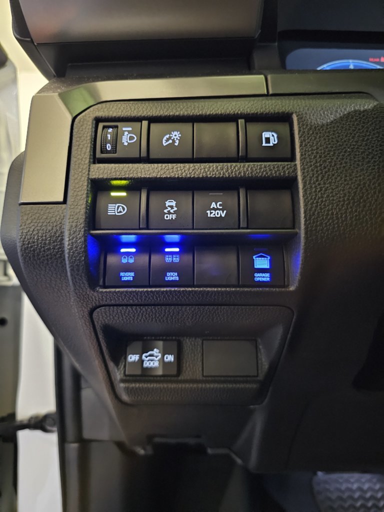

    It's a crap shoot. But my guesstimate is 82660G or 82660F as relay holders. Relays used are common DENSO made.
