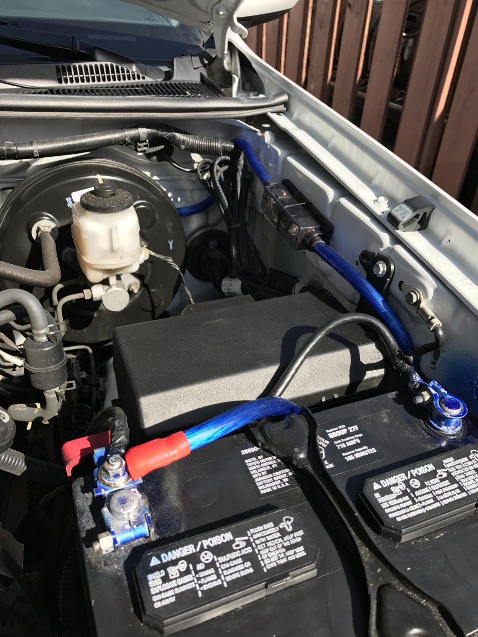

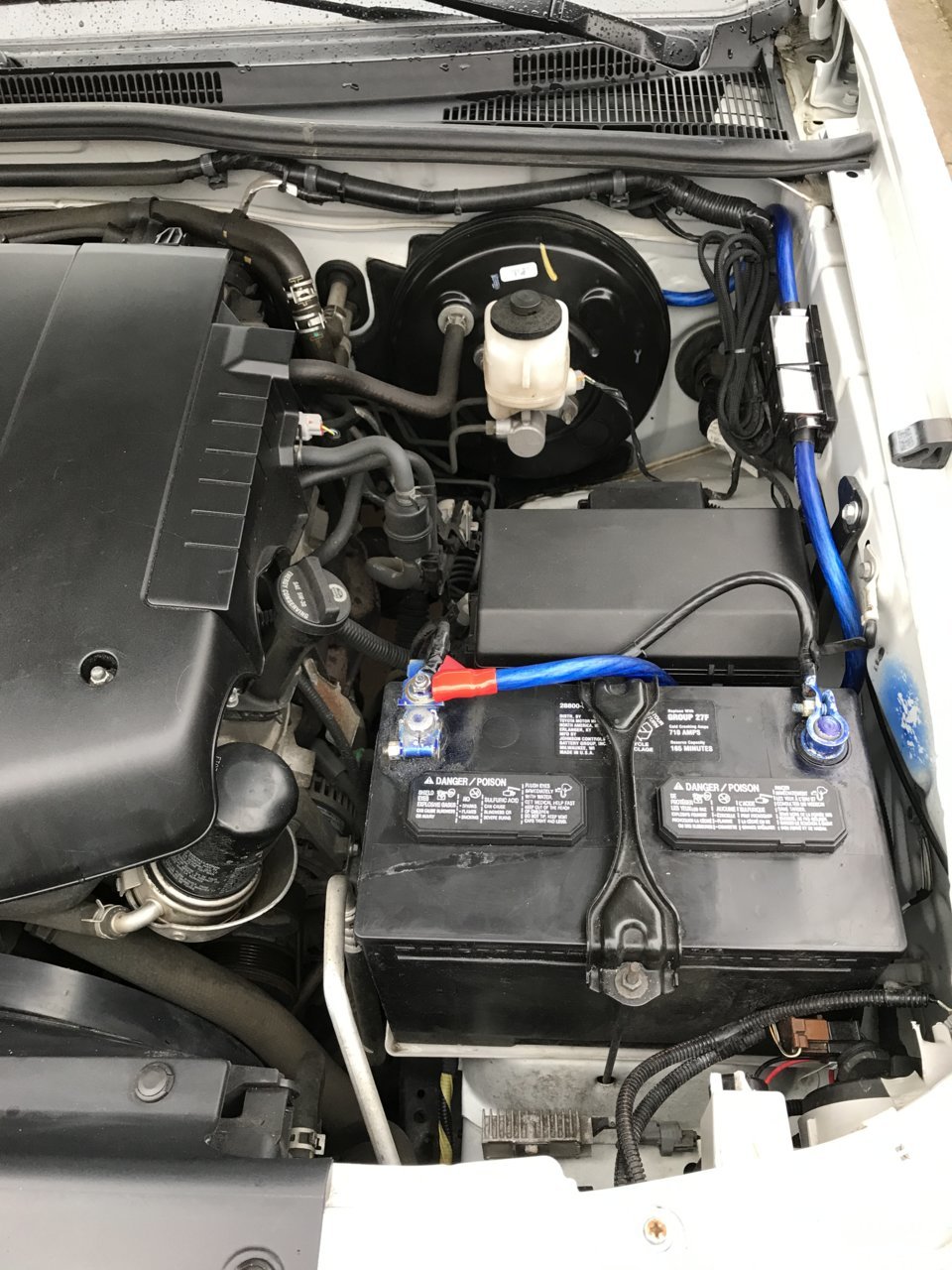

    On the passenger's side, there's a manufacturing process hole you can use. Details in this post I made about using mine.
    TnShooter and guyofnowords[OP] like this.

    If you’re careful, you can use the hole on the driver side were all your fuse box why is go in there’s plenty of room
    guyofnowords[OP] and ZMan2k2 like this.

    Nice! Thanks for the pics. It definitely helps!
    TegoTaco[QUOTED] likes this.

    There is a nipple in the grommet that seals the main harness passthrough into the cab (drivers side by the master cylinder).
    Cut that nipple off and you can put pass wires through it. 4 awg wire might be a very tight fit but I was able to cram the connector for my PDU keypad through it.
    guyofnowords[OP] likes this.

    I saw that part on the rubber grommet. I kept on pulling on it thinking that it was supposed to come off haha.
    But yes, thanks for the advice! I will keep that in mind if I choose to run a sub

    There's also a twin of this plug on the drivers side behind the top of the brake booster. I was able to easily pull it out and used small jewelers screw drivers of different thicknesses to gradually bore a hole through the center of it for the outside mirror temp display sensor harness. I was nervous about pushing through or disturbing the main harness bundle or cutting a hole in the rubber gasket around it. Nicking a wire or opening a place for water to trickle in unseen behind the carpeting isn't worth the risk for me.
    It took patience and a little time, but once a little bit of the wires makes it through, it's easy to pull through the remainder and replace the plug. On the interior side, the hole for the plug is just above the carpet next the the e-brake linkage.
